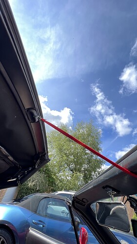

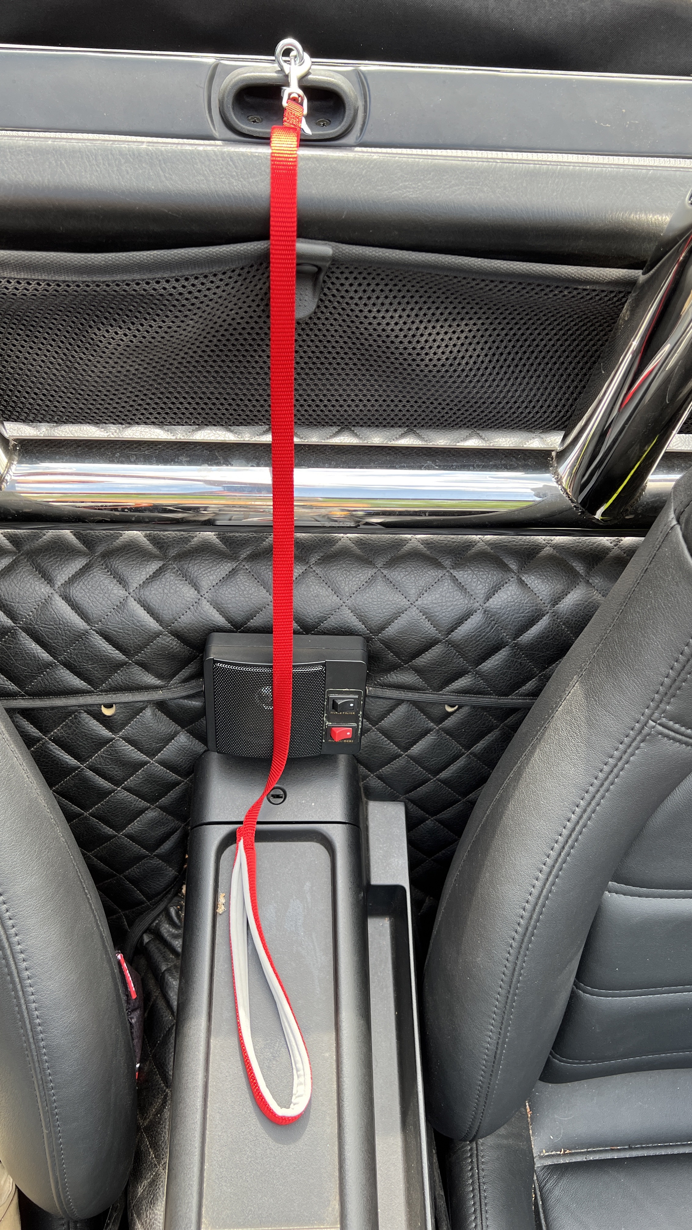

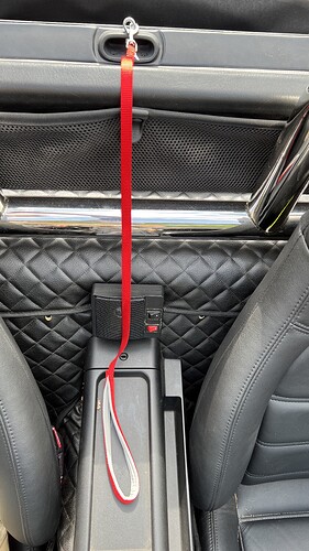

OK, haven’t managed to make it electric, but I can now close the roof without getting out of the car, especially useful in traffic.

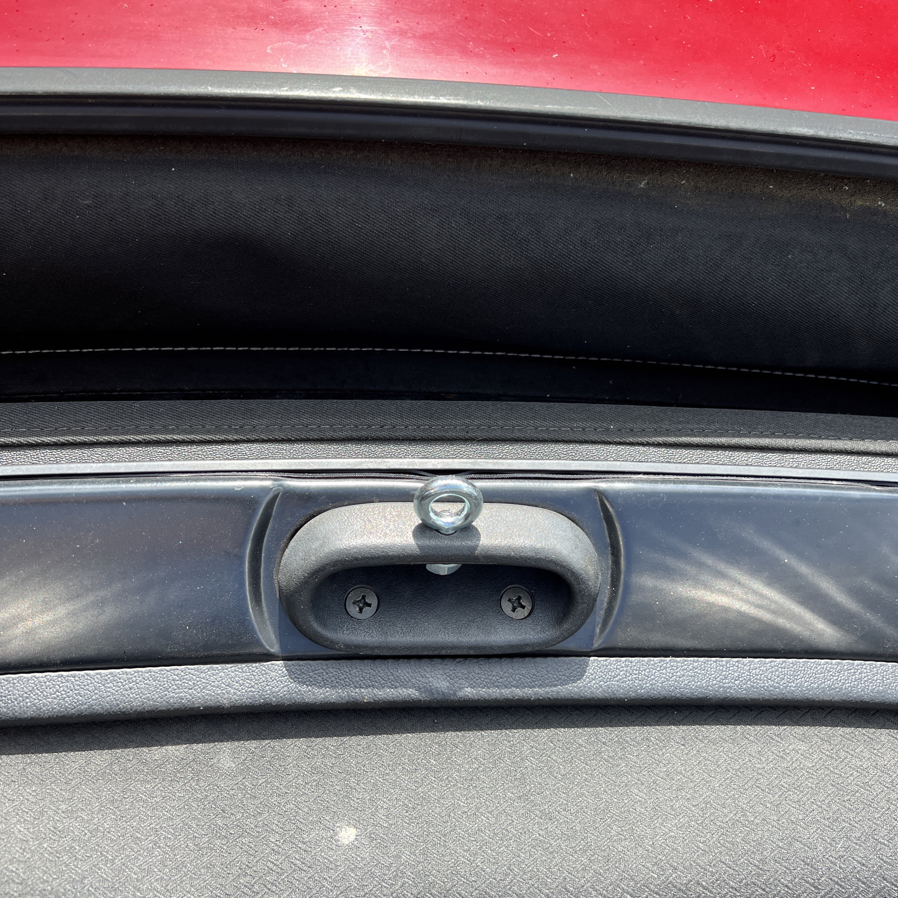

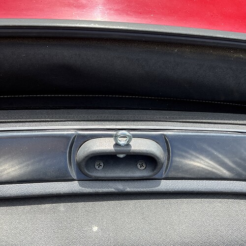

I bought a small ring bolt from the hardware store (2 for £4; £2 each) and a small dog lead for £4.75
I removed the roof handle, drilled an appropriate hole, cut the bolt down to 1.5cm and assembled.

You could unscrew the original handle and fit a luggage handle strap (Heavy Duty Replacement Case Handle 170mm Steel Reinforced Strap Suitcase Amp | eBay) in its place to save on drilling through the original handle and then just tie the dog lead round it.
Thought about that, but I didn’t want anything distracting or “dangling” when the roof is shut. I also thought about just having a loop of luggage strap fitted under the roof handle.
Your idea would work though.
