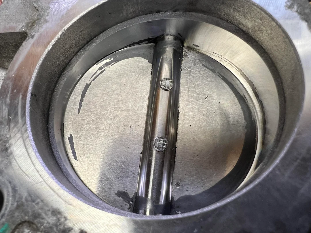

Usually the Bosch flapper-type AFMs never need any attention in 1990 models. Some , people will break the silicone seal to adjust the spring tension on the door, but thats it. Cleaning the throttle body on 1990 cars opens a can of worms. The butterfly will have some paint applied quite roughly by the factory, literally using a brush.
This is for a Kia, but its basically the same
This is called pre-sludge paint (or pre-conditioning paint). Its a sacrificial layer of paint to close up the gap between the butterfly and the throttle body. Without it, the factory can’t set the idle properly. As the car is used, sooty deposits build up, and the paint wears away. At the first service, the garage resets the idle.
Years later, an owner takes a look, and sees its all black inside, and so fetches the carb cleaner from the shed, because he’s gotta clean that TB, right? Afterwards, the TB looks lovely and clean. The Benzene in the carb cleaner has stripped off what pre-sludge remains. But now you can’t set the idle properly.

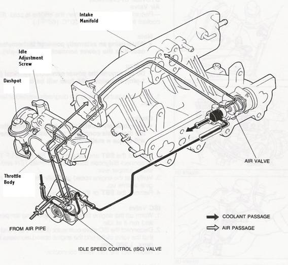

This is a schematic for the 1990-93 1.6. The 1.8 is different.
The Air Valve is a waxstat; its basically maintenance free. It works or it doesn’t. Never heard of one faling. It helps provide a smooth idle on cold motors, and closes as the engine warms.
The ISC valve is an ECU-controlled stepper motor. A signal is sent to this to open or close, based on signals from the throttle position sensor, igniton rpm and the airflow/airflow sensors. If any of these go bad, you get a lousy idle. When you jump TEN and GND in the diagnostics port, these are taken out of the loop, which is why this has to be jumped to set base idle. AFMs can go bad; they need to be replaced. The ISC valve can get gummed up, and will need periodic cleaning. The throttle body has to be taken off, and the valve removed The securing screws are usually very tight. After cleaning, the paper gasket to the inlet manifold and the rubber gasket to the ISC valve will need replacing. Likely a garage will need to order these in. Leaks around the injectors can give poor emissions; you are drawing in unmetered air.

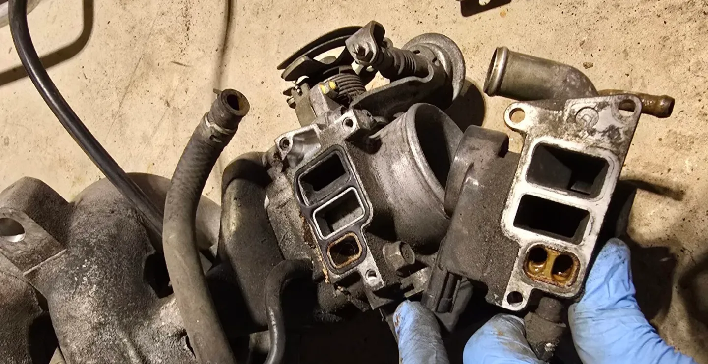

Air Valve; it has a rubber gasket that can fail
ISC valve; you see how gummed up it can get
Basically, the throttle body shouldn’t be routinely “cleaned”; it doesn’t need it.
