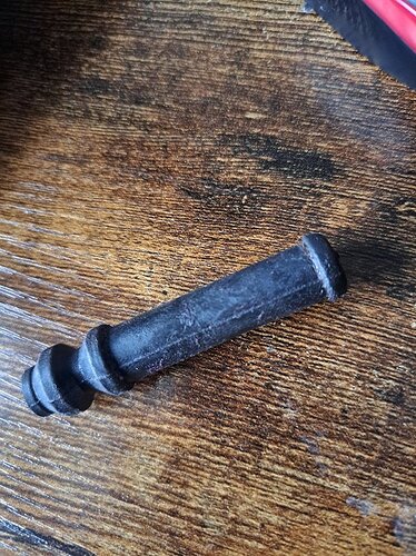

NA/NB Front caliper top sliding pin boot
Any tips on fitting these?
A sticking front caliper I think might be due to a split boot. Ordered one from Bigg Red (for 51mm Sumitomo). Its somewhat similar to whats on there.
But the bellows bit seems smaller. The way I have put these on before is to smear the boot in red caliper grease, and then using the blunt end of a drill bit, push it through.
Only the drill bit went right through the end (spit rubber). The end feels softer rubber than the old, and not as thick.
Any other ways to fit these? As I probably have to order another.
Any other sources besides MX5parts. Autolink seem to want to sell a Mazda boot kit for 2 calipers, for £26. MX5parts sells for 1 caliper for £6.60 plus post, which looks identical to the £.6.80 item including post from Bigg Red.
On other cars with similar boots - I have used a manual vac pump to suck the boot smaller before inserting it.
