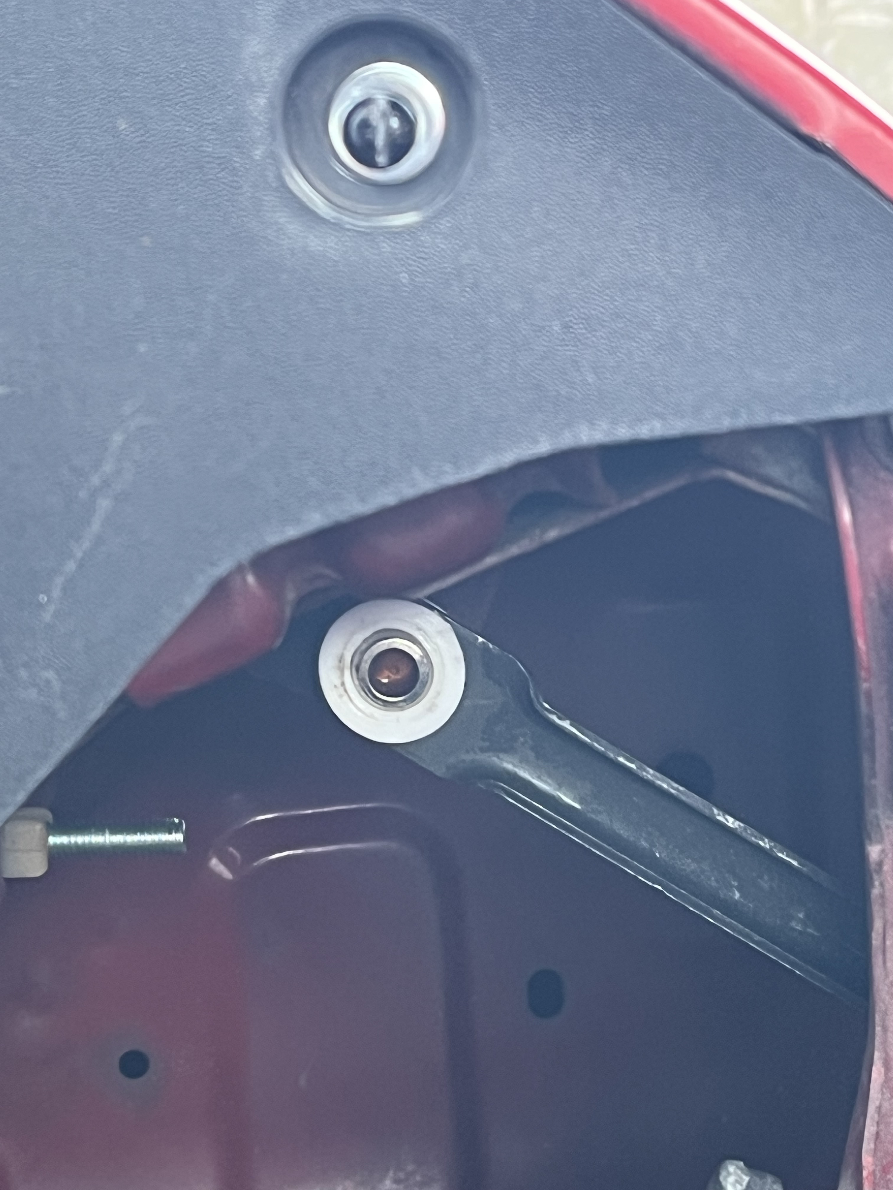

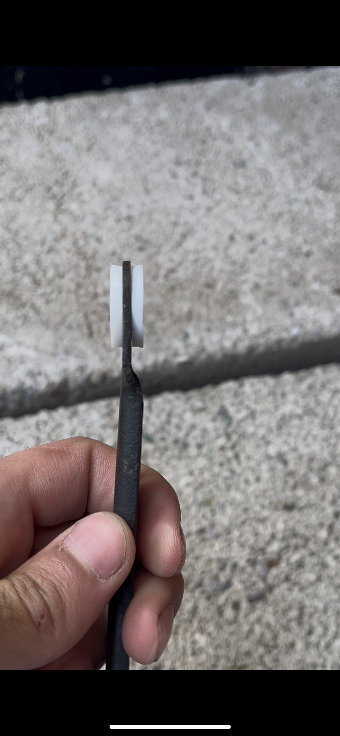

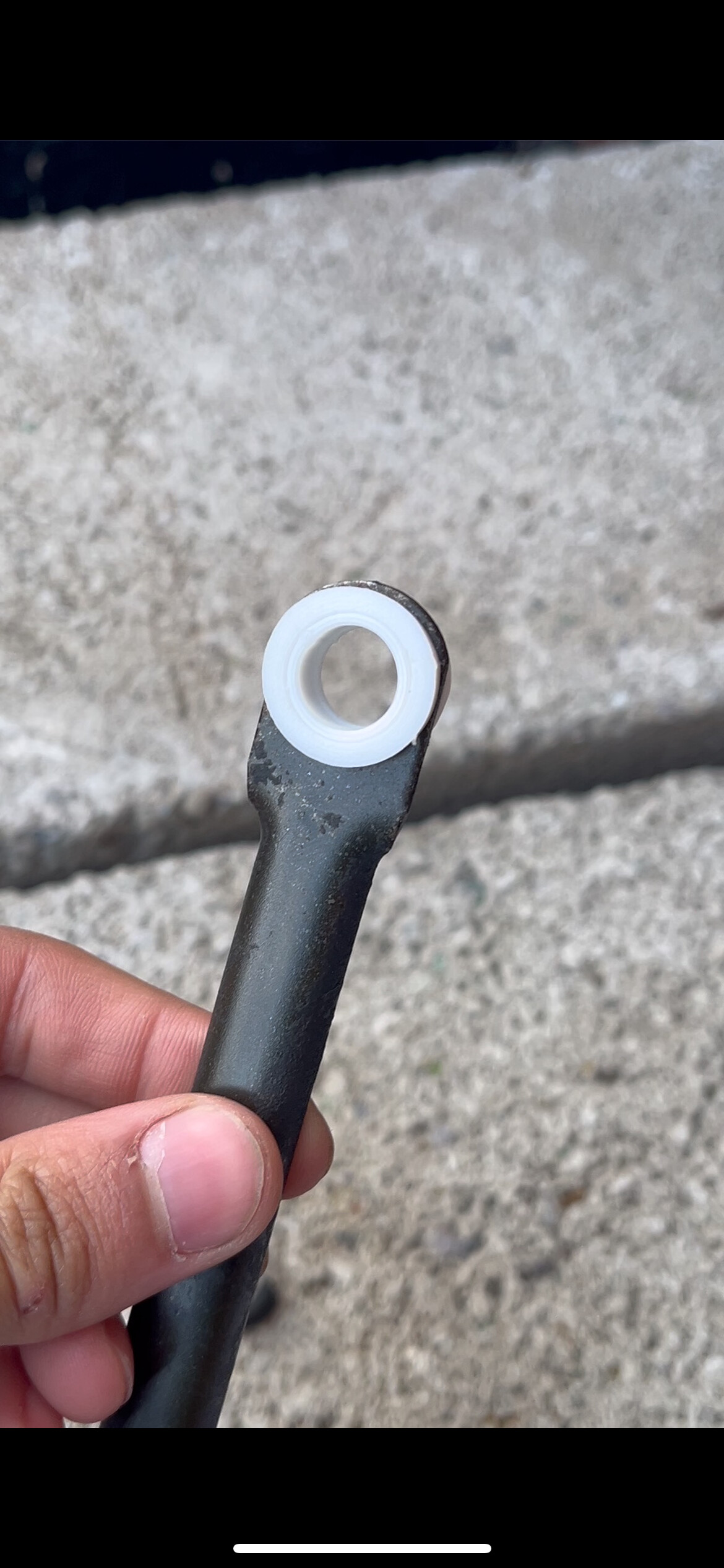

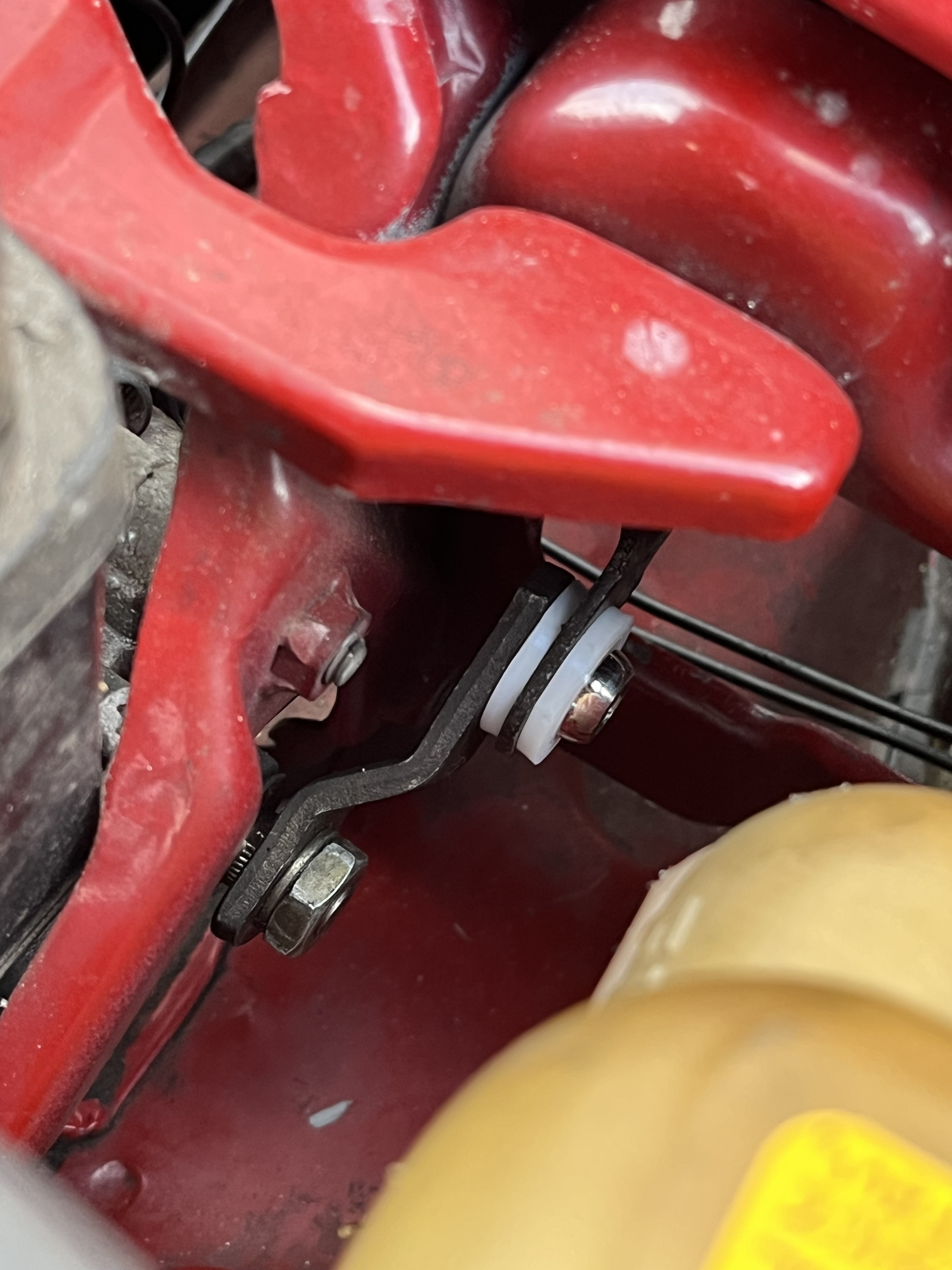

I recently switched back from low profile lights to the oem lights and unfortunately broke the little white grommets that go in the motor arms. I have since tried using rubber electrical grommets cut down to size which work great for a few days then perish.
I wanted to ask if anyone knows where I can maybe get more of the OEM ones from or even something else I can use (like the electrical grommets I tried) as a replacement? Images below show what I’ve been using temporarily.

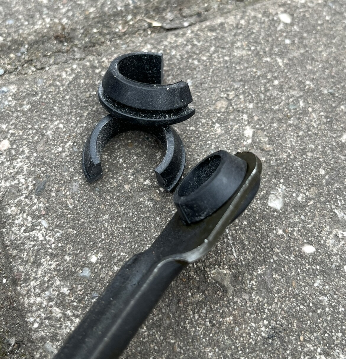

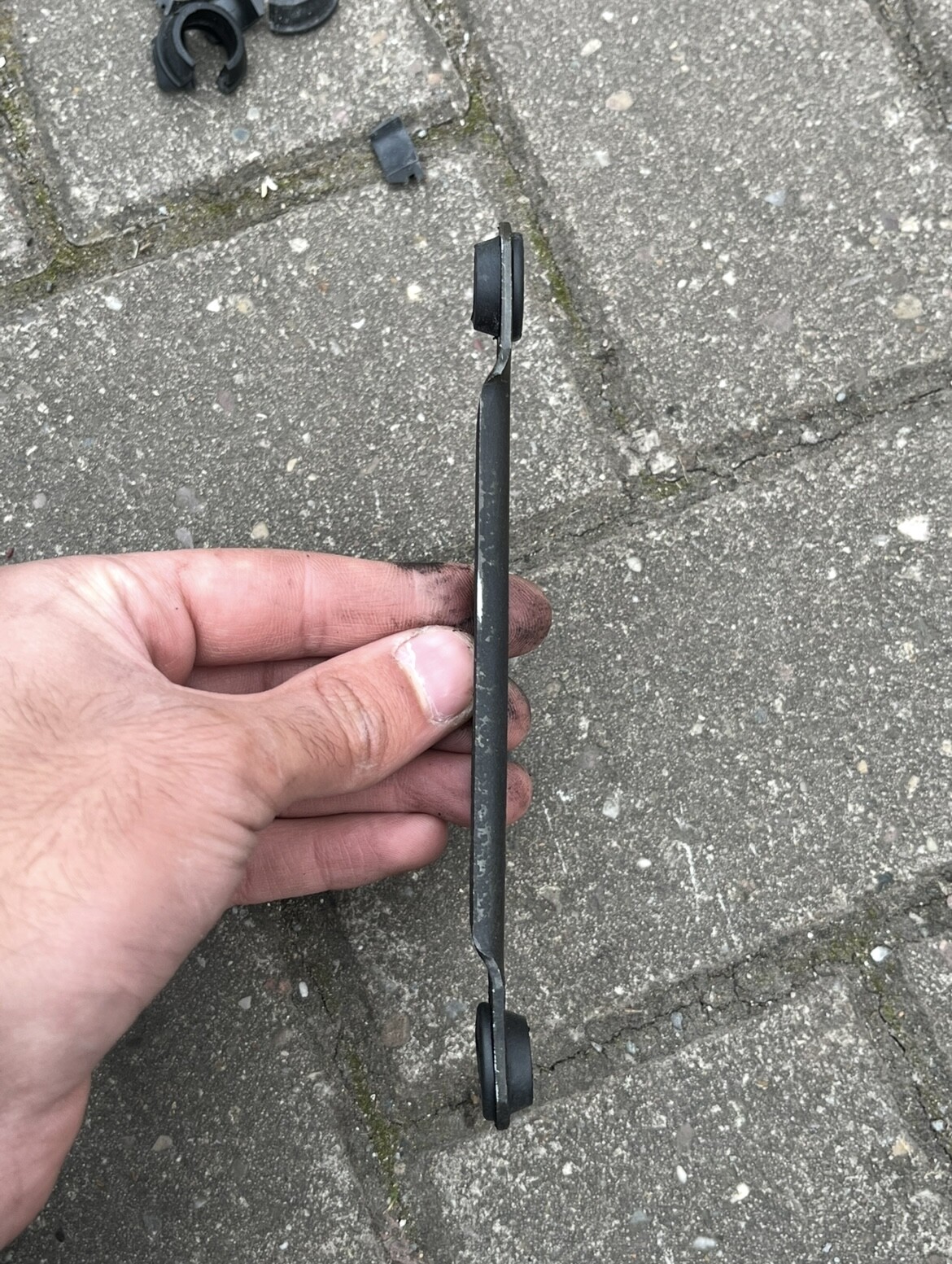

I couldn’t find any online so I ended up designing and printing my own slightly different ones. They seem to be doing the trick so far.
