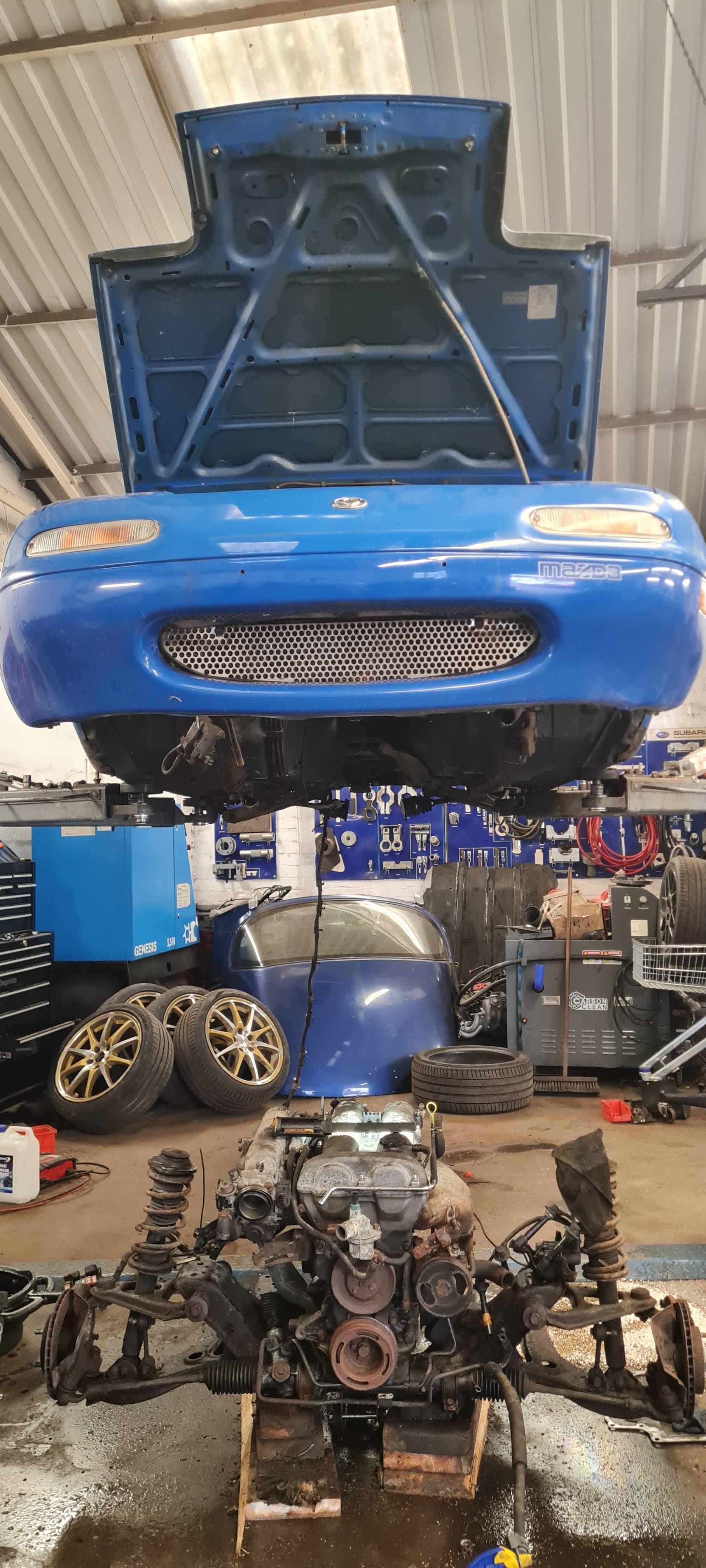

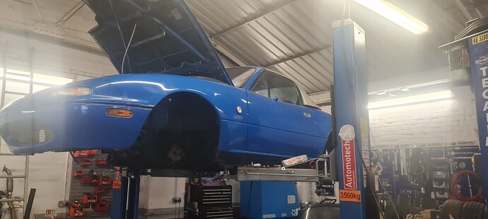

They took delivery last October, removed the engine and front axel, did some welding and rust treatment, but then work stalled despite visits and calls to the workshop every week.
Yesterday a mechanic from the garage called me, as he had been brought in to complete the work.
He advised that the engine was effectively toast, and that to complete the work the initial quote was unrealistic.
The descision was made to cut my losses, and have the car put together as a rolling chassis and retun it home on the back of a flatbed.

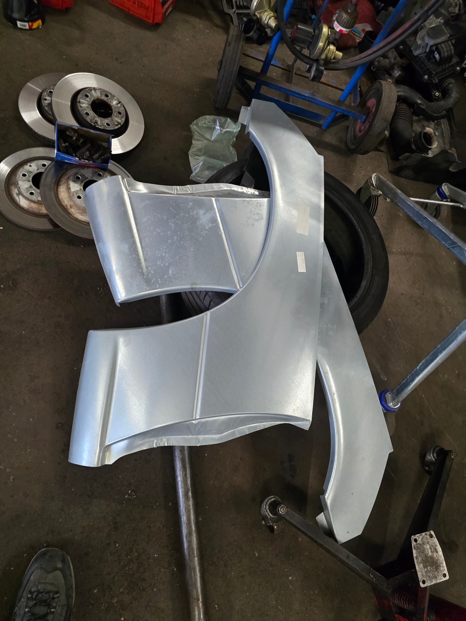

I have a couple of new rear arch panels, suspension and various other parts that ive paid the garage for.

So ive paid £3400 to the garage, for some welding underneath and rust proofing, a new battery, a timing belt kit, radiator, clutch kit, and refurbished wheels and some other suspension bits and pieces.
I dont understand why they didn’t check the engine and try to get it running first, before making the wheels look nice, but hey im no mechanic.

Did they say what about the engine was toast? Why did they need to get another mechanic in? The impression you’re giving in the first post is they just wanted it out of their workshop and out of their way so work with a faster turn-around could take place.
Looks like you have a very early car as this is a short nose crank engine.

From what i understand as the engine started being taken apart it was full of some anti oil leak gunk that had solidified, and youre right, i dont think they fancied doing the work.
Its now back home albeit in more parts than when it left and i think im going to have a go and replacing the engine and anything else that needs it while there is acceess.
