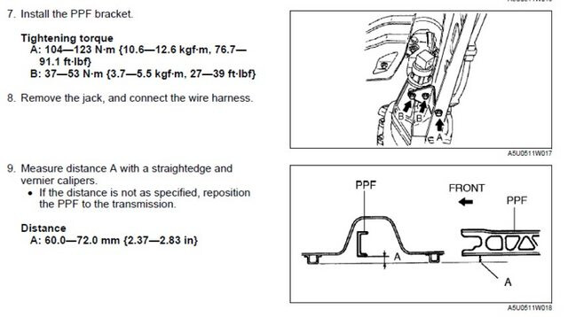

Not super technical but is the main shaft worn…? Why is the gearbox suddenly whining. I have read there is slight adjustment that can be done on the gearbox…65mm ±5mm on bottom of gearbox to chassis rails.

Sorry to hear about your troubles, I’ve changed release bearings before with a new clutch and they’ve been noticeably noisier than the old ones. I remember resolving that with an OEM Mazda release bearing. The NA/NB boxes are very sensitive to the type of oil, the old Ford Motorcraft stuff used to make a big difference in slick gearchanges. In addition the propshaft angle can make things noisier if the PPF height to bottom of gearbox is not set to about 60mm. (some manuals say 56mm, some 65mm) This can make a difference to noise but it’s more likely to be a combination of things - oil, angle, bearing etc. Have you replaced the lower & upper gearchange rubber boots? a hole in the upper one can let through a surprising amount of noise.

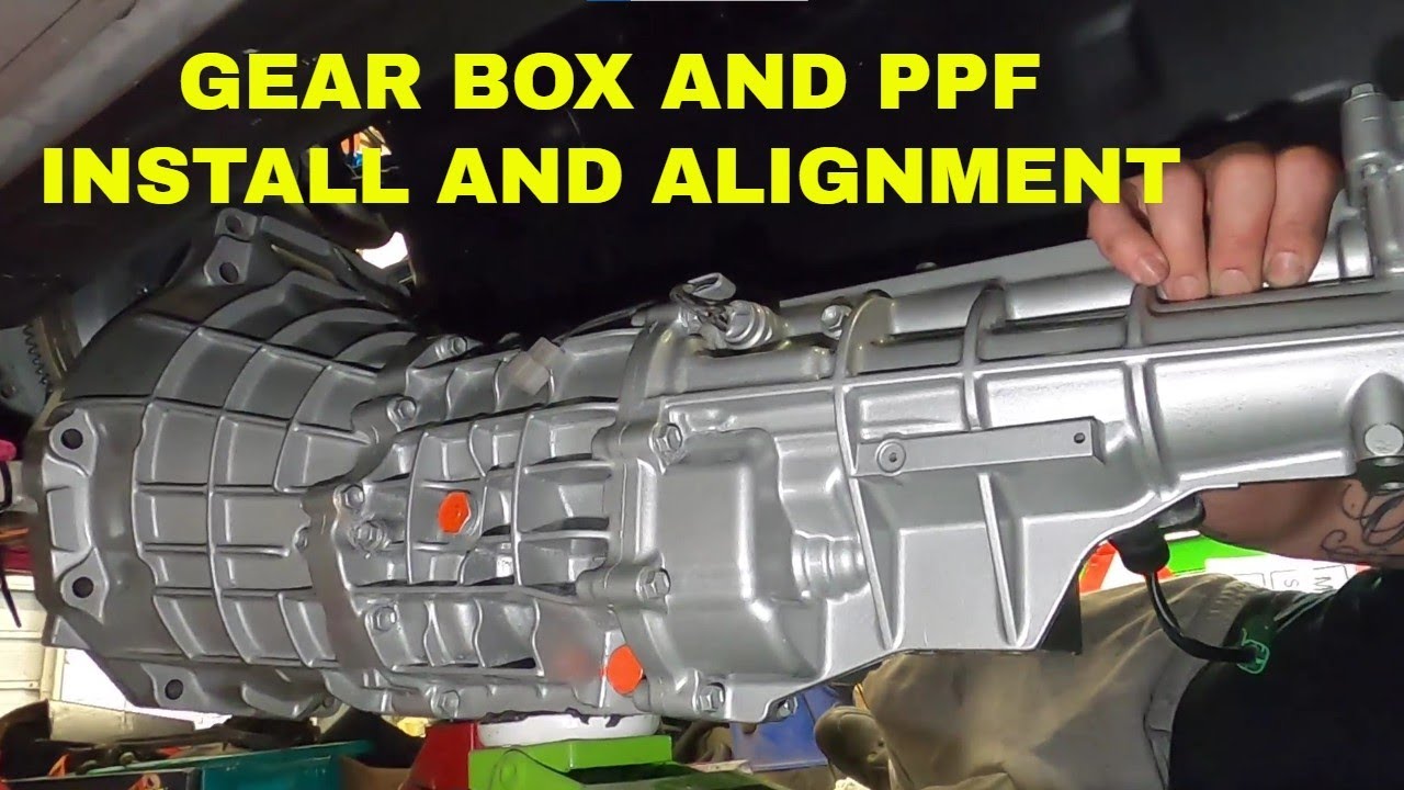

I found this video with goes through about adjusting the PPF and gearbox. Still can’t see how this is adjusted, even from the video. Might try and take a proper look under the car on Friday or speak to my local garage about this issue. Jump to 5 mins 30 secs, can’t believe how clean his car is…

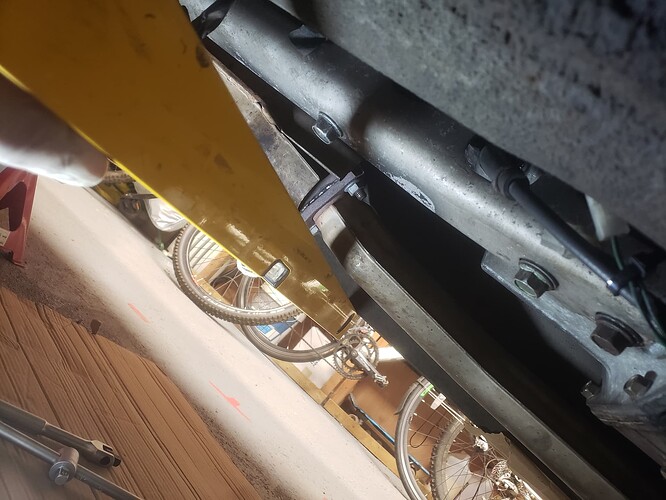

Theo, to adjust the ppf clearance take a look at about 6 mins on th video you can see him pushing the tail of the gearbox up to add the black support bracket. If you’re adjusting when the gearbox is already installed you need to support the tail of the gearbox with a jack, then loosen the two left big bolts plus the support bracket right bolt - don’t remove them… The tail should then be able to move up and down an inch or two like the video. Run a straight edge across the chassis rails and measure the 60mm. I used to use a metal ruler with some tape wrapped round it at 60mm so I didn’t have to scrabble around with a torch under the car!
What the measurement is doing is setting the prop shaft angle so it’s not too severe and doesn’t put strain on the UJ.

I remember when Friday nights use to be going out with friends…anyway I measured the original distance 53mm…I tried to set to 67mm but it settled at 64mm. Will test in the coming days.
