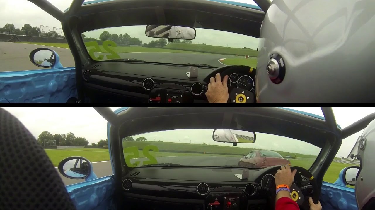

I think I recognise that blue car :joy: especially as it’s got no 25 on the window
