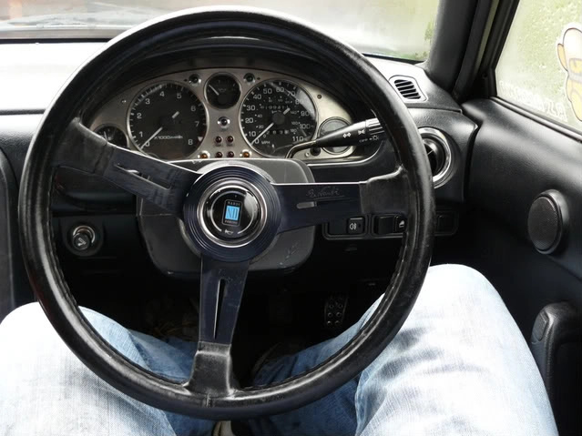

My original factory wheel
On the original, you can see the eccentricness of the boss

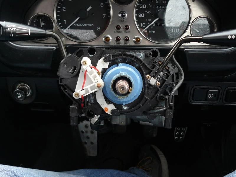

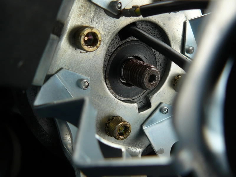

Cowling removed

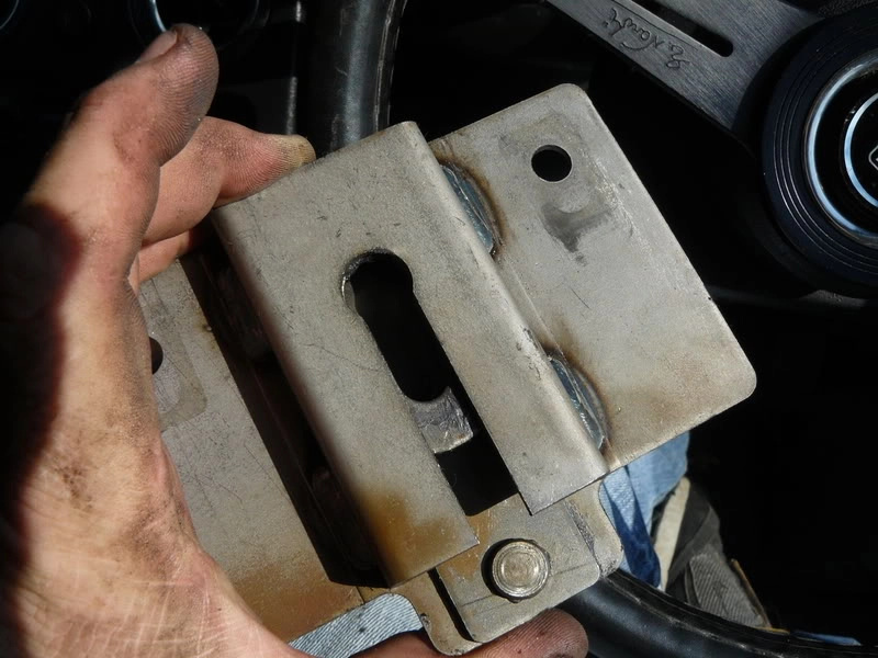

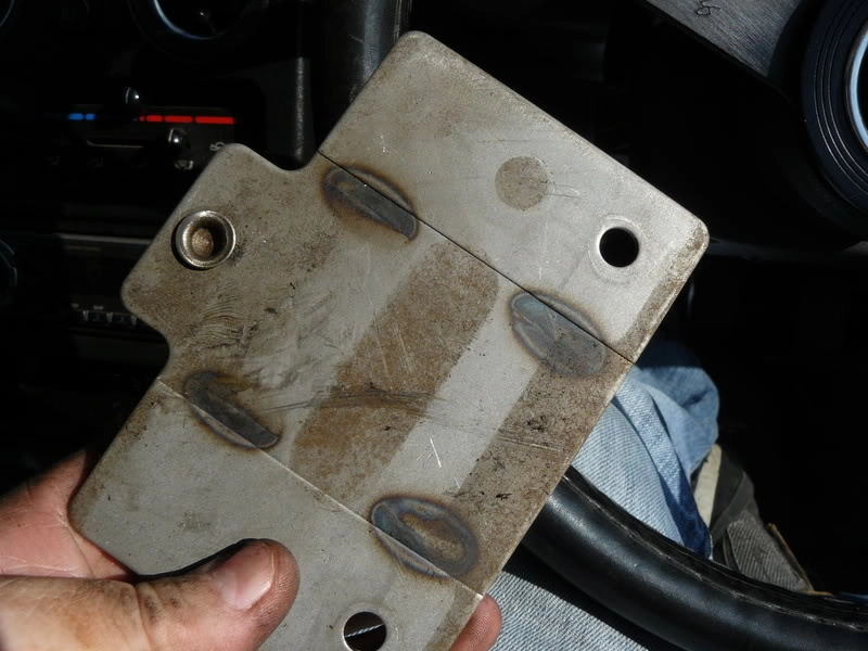

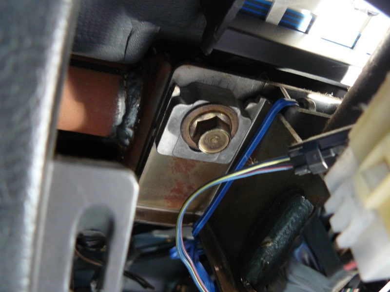

To see the spacder plate/shimm, you need to get into the footwell and look up
Couple of bolts, and its out, refit the bolts
