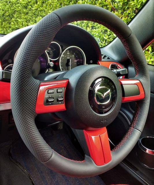

Sometimes it may be cheaper to find a good SH wheel from that well known auction site but having yours retrimmed give you the option of having a bespoke design/colour leather and stitching…mine below.
