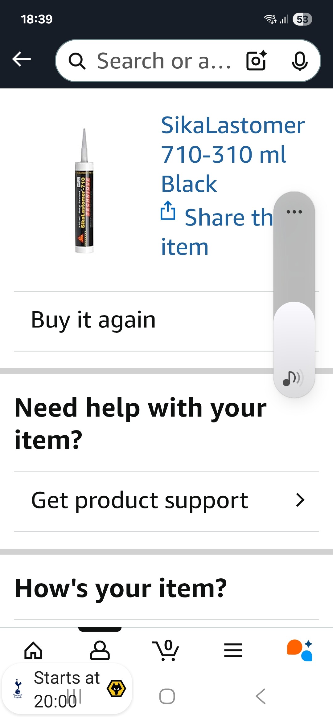

I used this to seal it. Does not harden so can be removed if needed.
I’ve ordered a strip of 10mm x 10mm foam rubber to see if I can fashion a gasket with it. If that doesn’t work I’ll try the sealant you suggested.

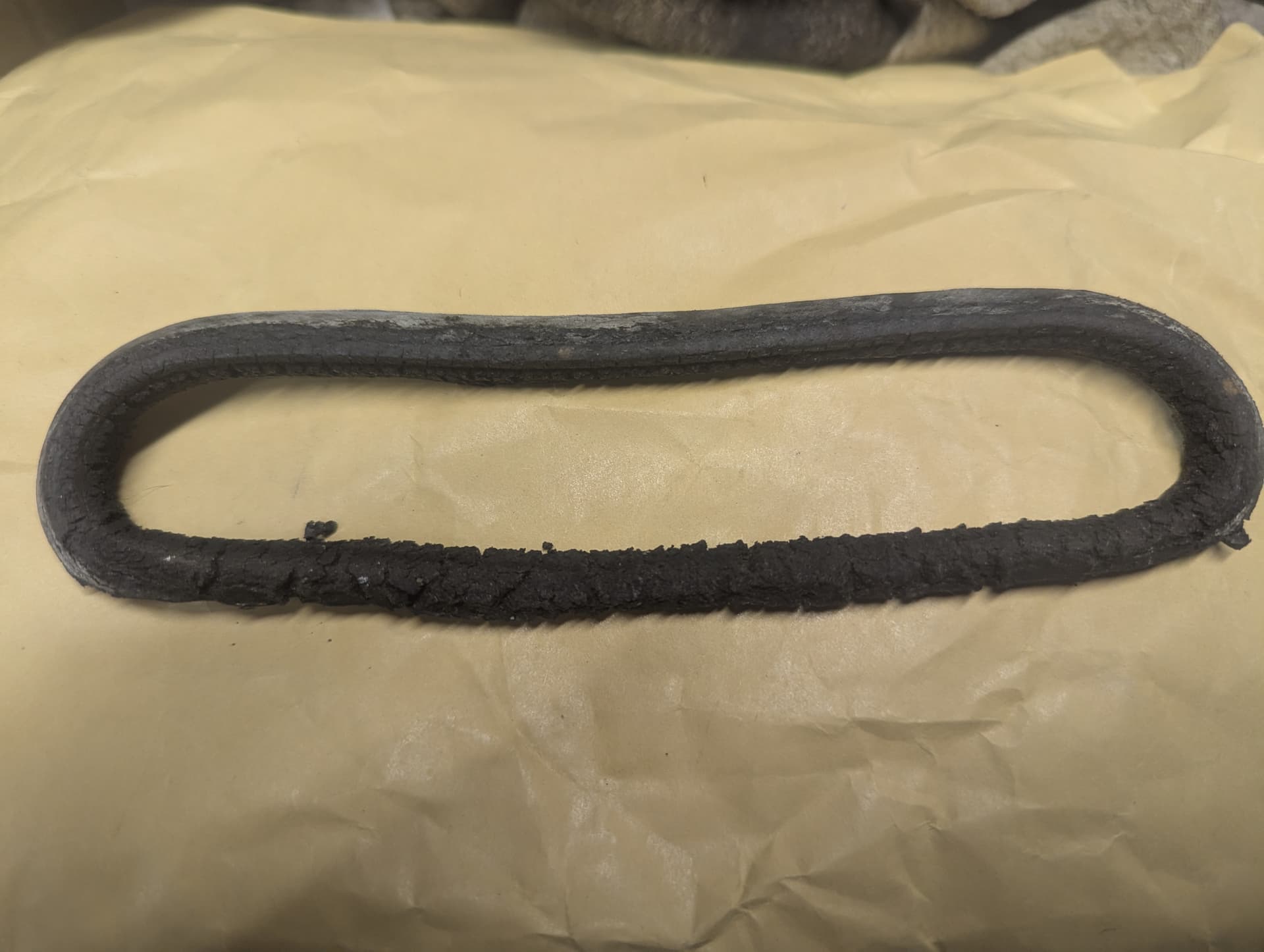

This is what the old seal looked like, it has gone all hard and cracked.
