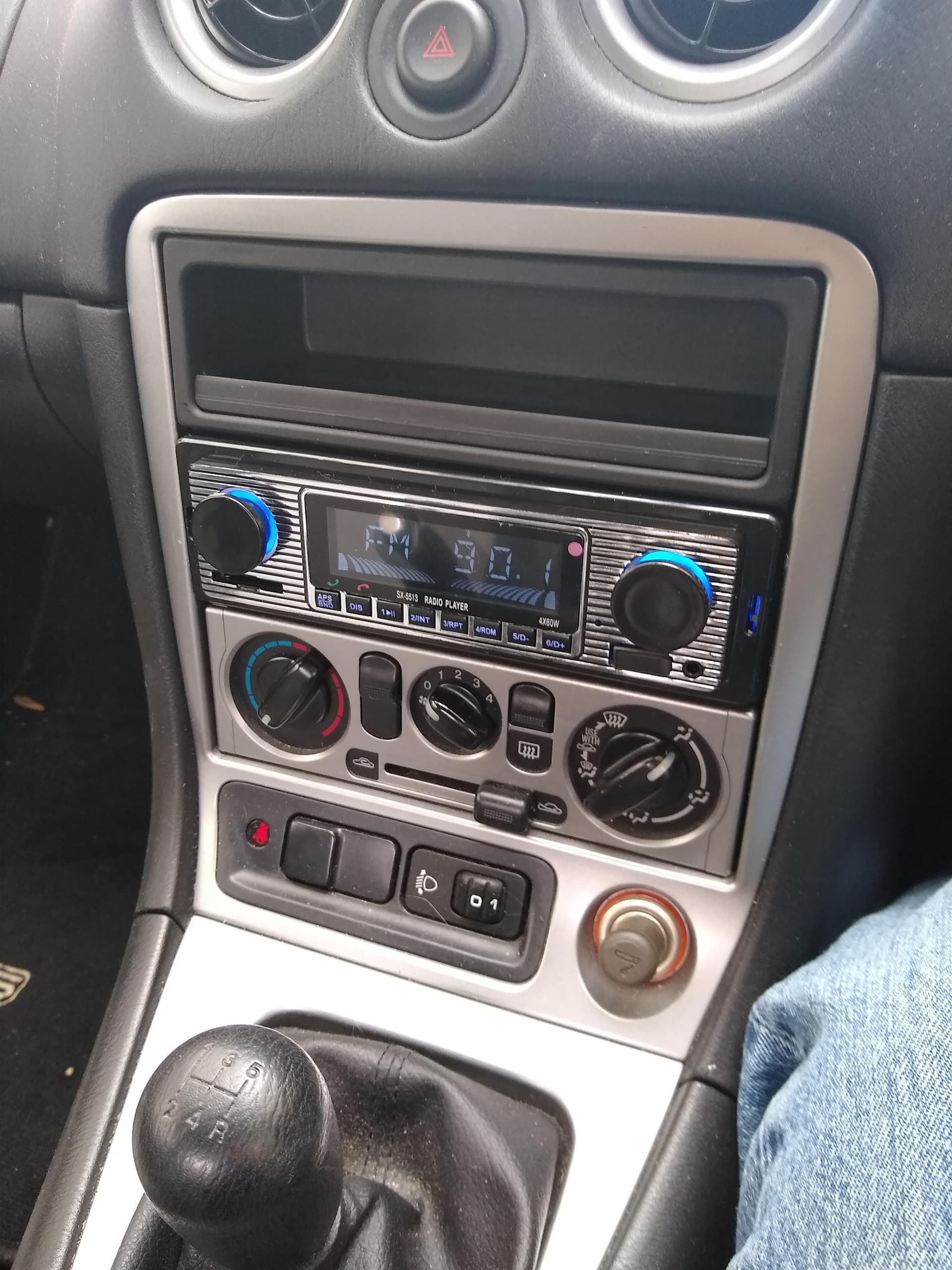

A while ago I replaced the double din stereo unit with a 1U Bluetooth radio and cubby hole:

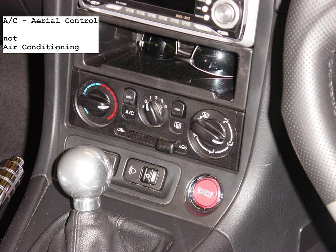

I bought an Air Con switch and wired that in.

I used the side blank (in IanC’s picture ,right bellow) extremely easy to fit and almost invisible.

It’s a while ago but I think it was from main dealer

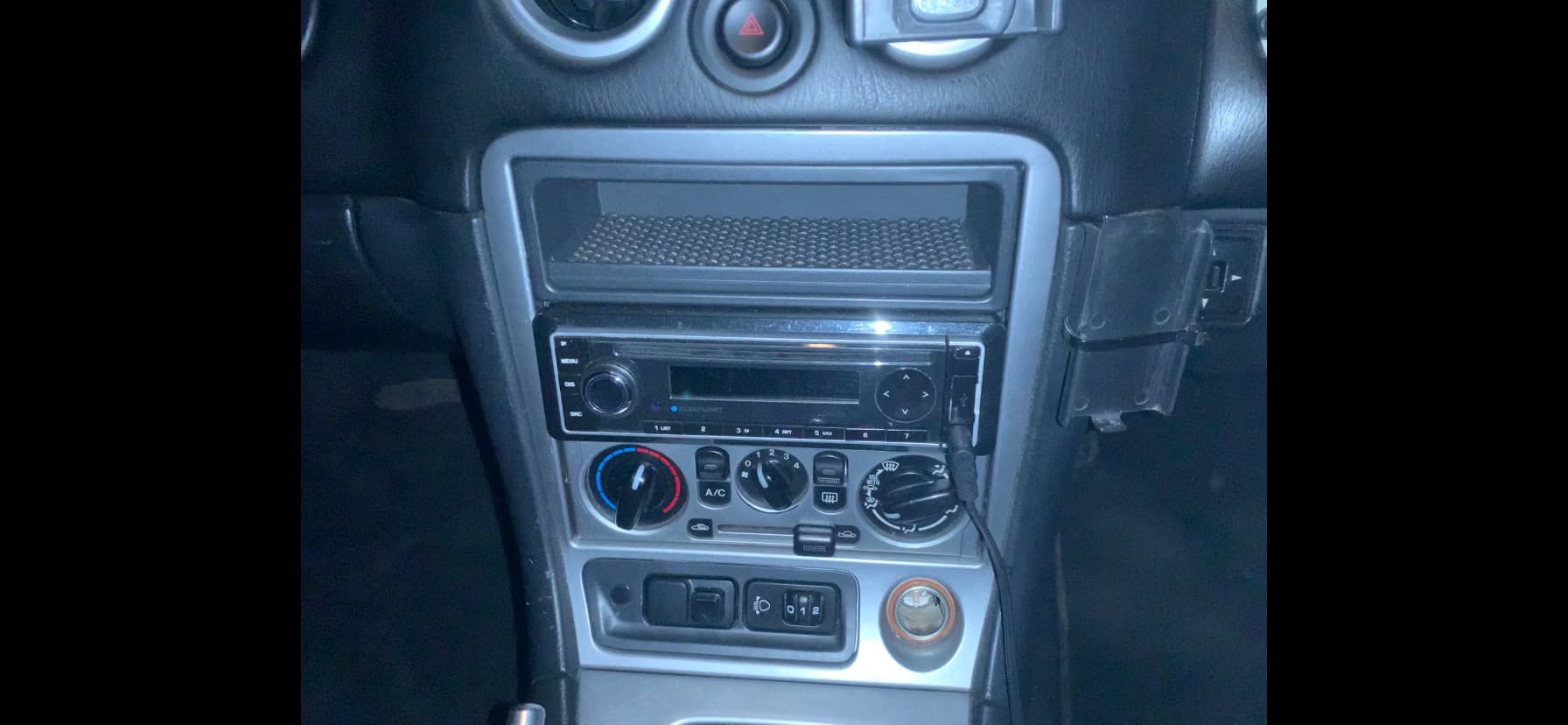

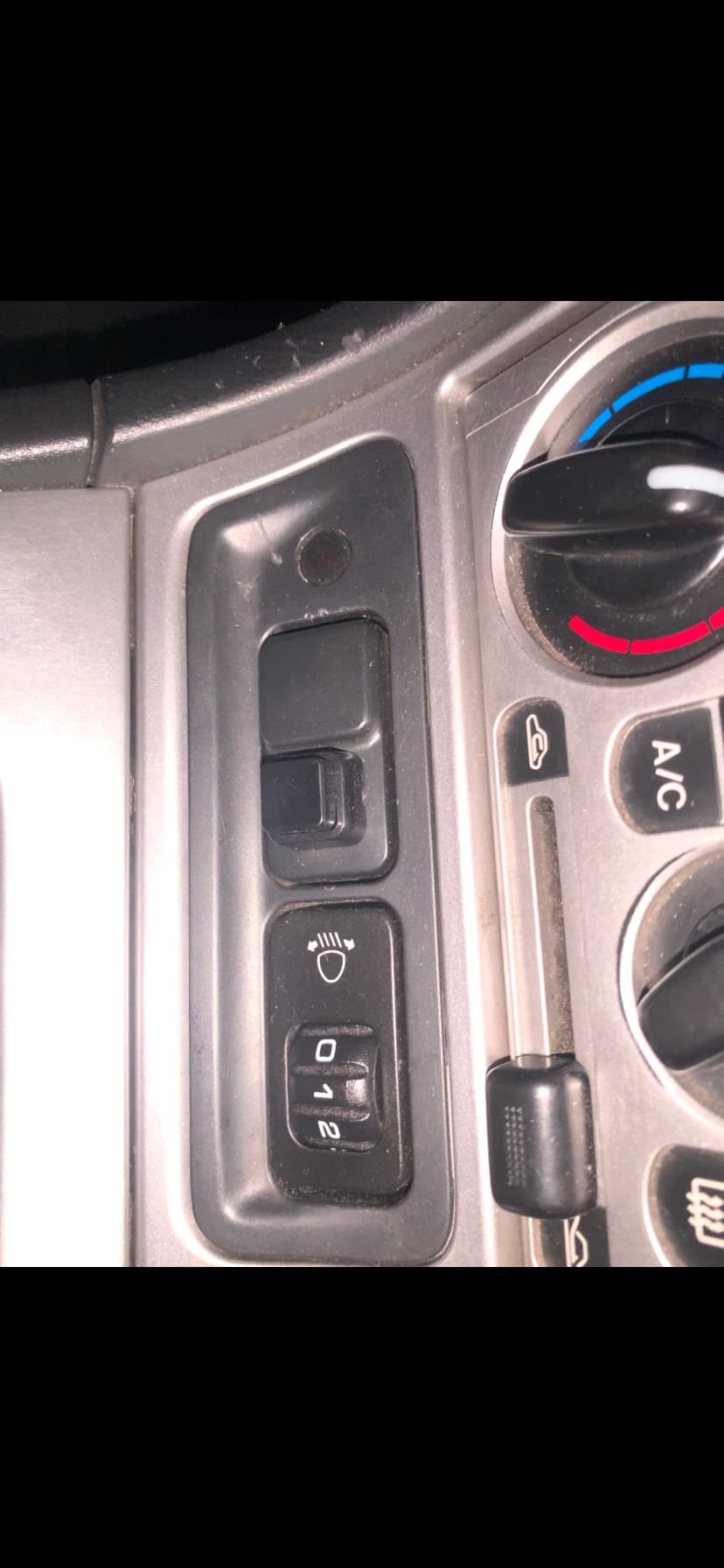

Did the same on mine a while back, got a switch from maplins I think, which was small enough to fit in blank near headlight adjuster. Will get photo tomorrow but just had to pop out blank , drill a 8mm hole in it and identify arial supply wire. Unless you look really close you would think switch is original
Hi Rutlandsurfer - that’s very interesting and exactly what I’m hoping to do. Could you tell me exactly what ‘popping out’ the blank next to the headlight adjuster involved in terms of panel disassembly please?
Not sure if these photos have loaded properly. Blank just pops out , need very thin screwdriver down sides to ease out. Awkward bit if I remember was feeding wire to back of switch. Honestly can’t remember if I had to take heater controls out , but I think it was obvious once radio was out of the way

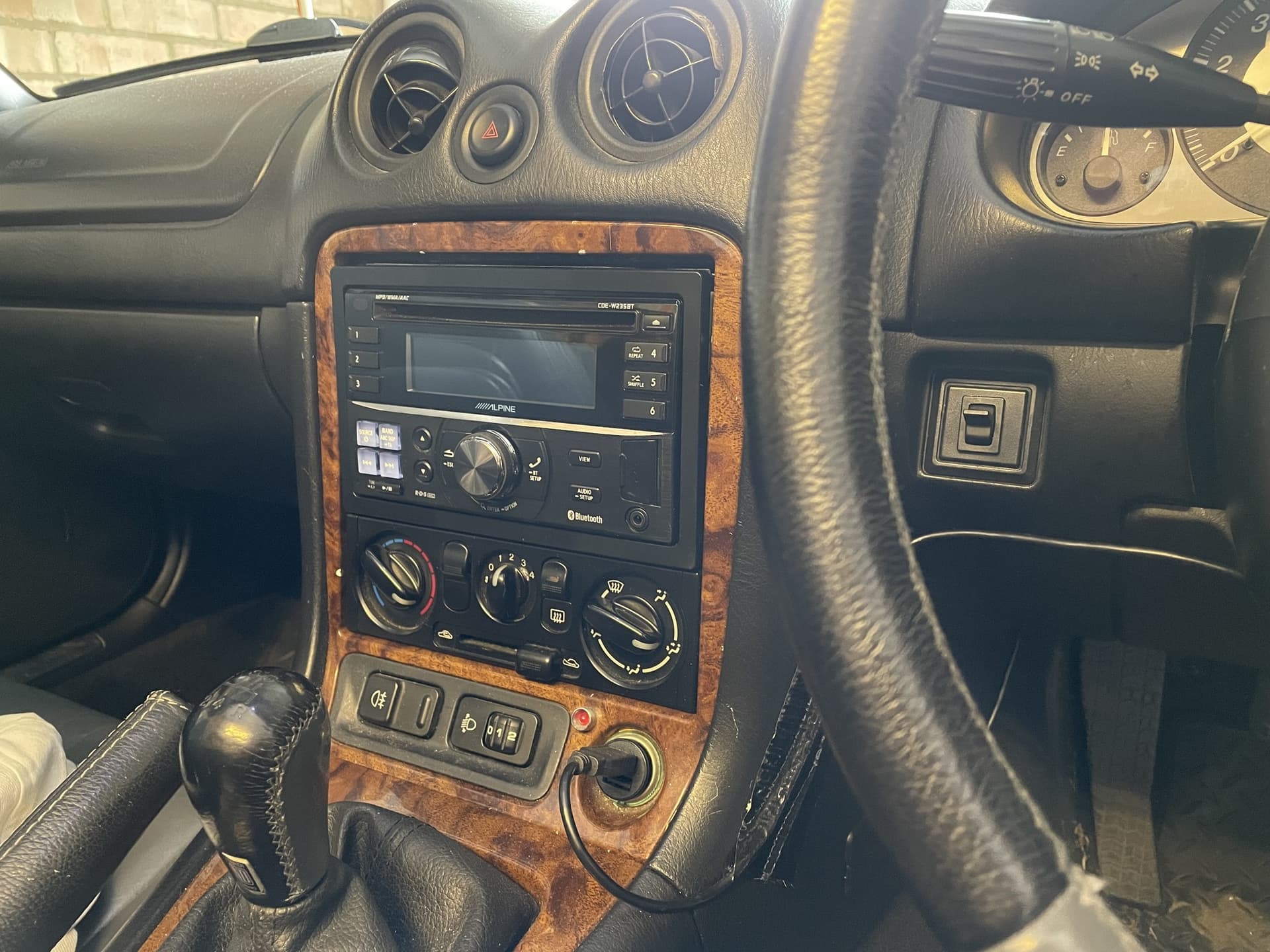

First of all a “thank you” to all the contributers of this thread for giving me the inspiration to do this mod as well. As it was a cold damp Norfolk afternoon I thought I’d spend some time in the garage and install an override switch.
For me, the obvious location of an additional switch was using the blank cover for the non-existant electric door mirror switch on my NB, as it was physically close to the radio just behind the steering wheel and it was a simple cable splicing and routing job.
I had in my spares a miniature paddle switch, but the equivalent sized rocker switches are available at a low price on ebay here: here
