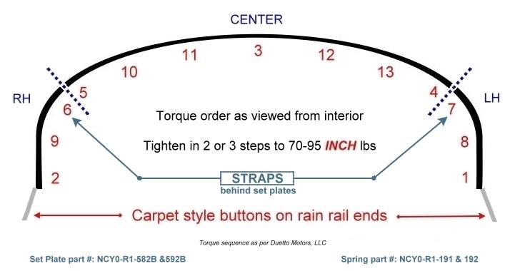

              If like me you are reasonably comfortable doing a plugs and filters service, you should not find changing the soft top too difficult. I was lucky in so much as the replacement canvass hood I found was already mounted on a frame so I did not have to remove my old vinyl top from it’s frame and put the new top on. This undoubtedly saved me a good deal of time.
I would recommend you make sure you have all the tools you need before you start, the only thing I was missing was a drill to drill out the rivets which held the drain/membrane to my original frame, which was not supplied with the second hand canvas item I bought.
Using the recomended tightening pattern and torque on the bolts I have not had any issue with not riveting the drain membrane into place on the replacement frame.
I took my time since my basic slill set and experience is low, it took me a short winters day to take the old one out and the same again to put the new one in, the advatage of working in winter is the ambient temperature was low so I never got too hot and sweaty, there is a lot of unpleasant bending  and stretching required if you are working alone.
I would recommend taking the passenger seat out to make the job a little easier, the drivers seat might have to come out in some circumstances but it was not something I needed to do. Can be done alone which is what I did but would be much easier if you have a patient friend to help.
It took several days to stretch the replacement canvass roof so that it fitted snuggly and was waterproof. Lucky I have a garage so there was never any danger of leaving it out in the rain.
Good luck and fire away if you have any more questions
