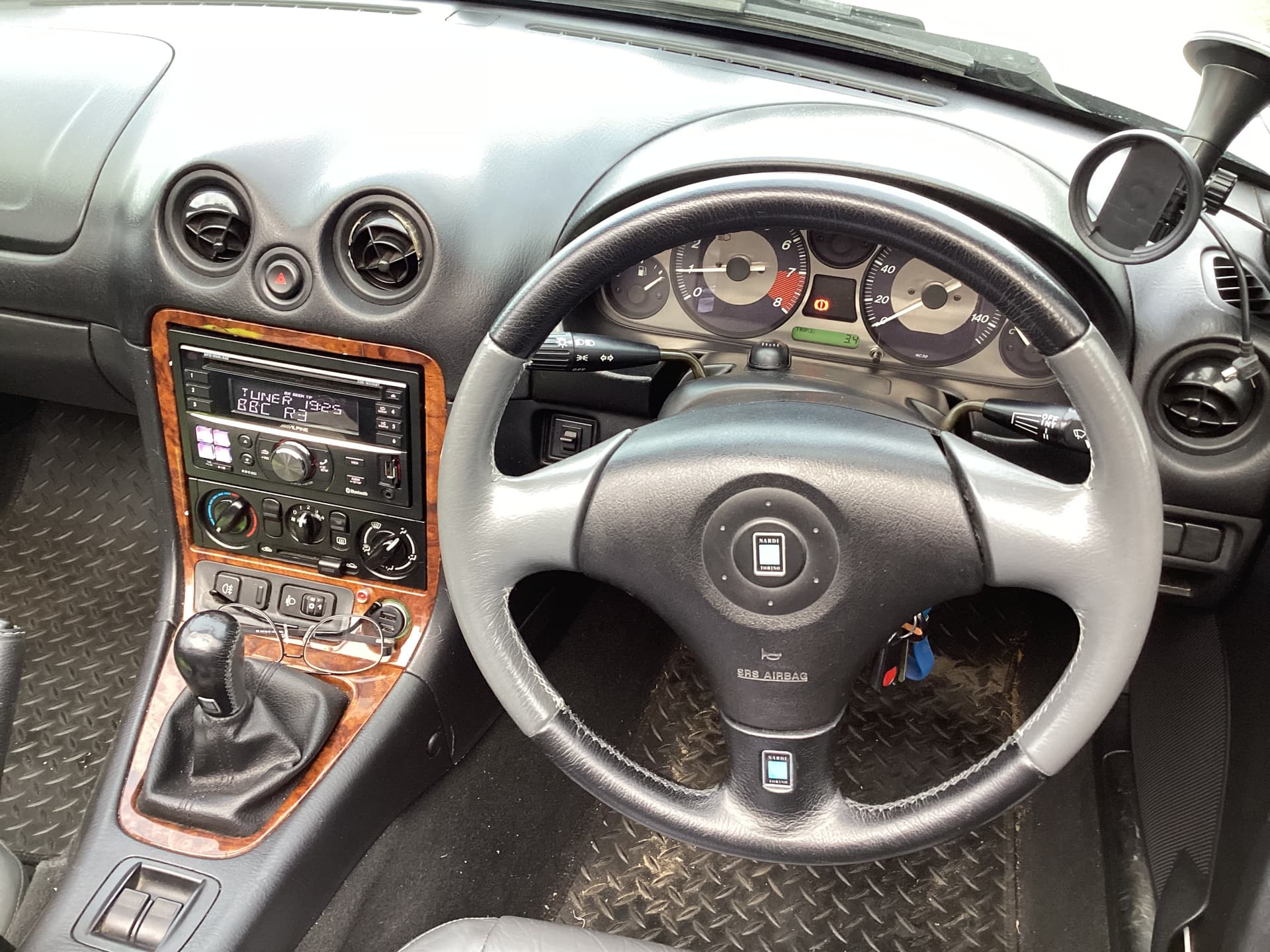

I replaced mine with a two tone leather Nardi as the tatty 4-spoke wheel was the one thing I hated with a vengeance as its plastic outer layer was peeling off in parts when I bought my car 13 years ago.

Thankyou for the reply. That wheel looks nice

The matching gear knob was a bonus for me as the original’s “wooden veneer” had split a bit.
