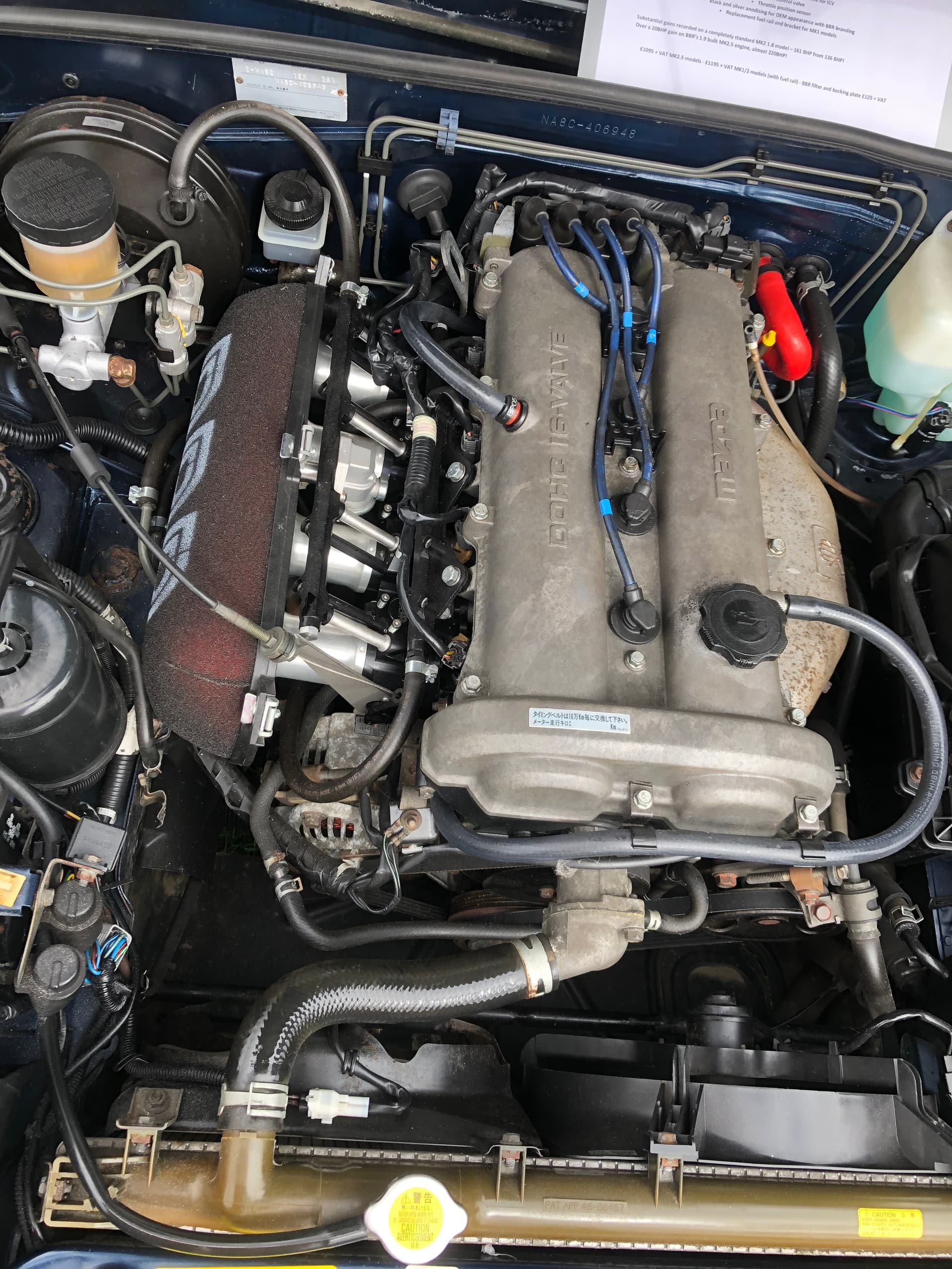

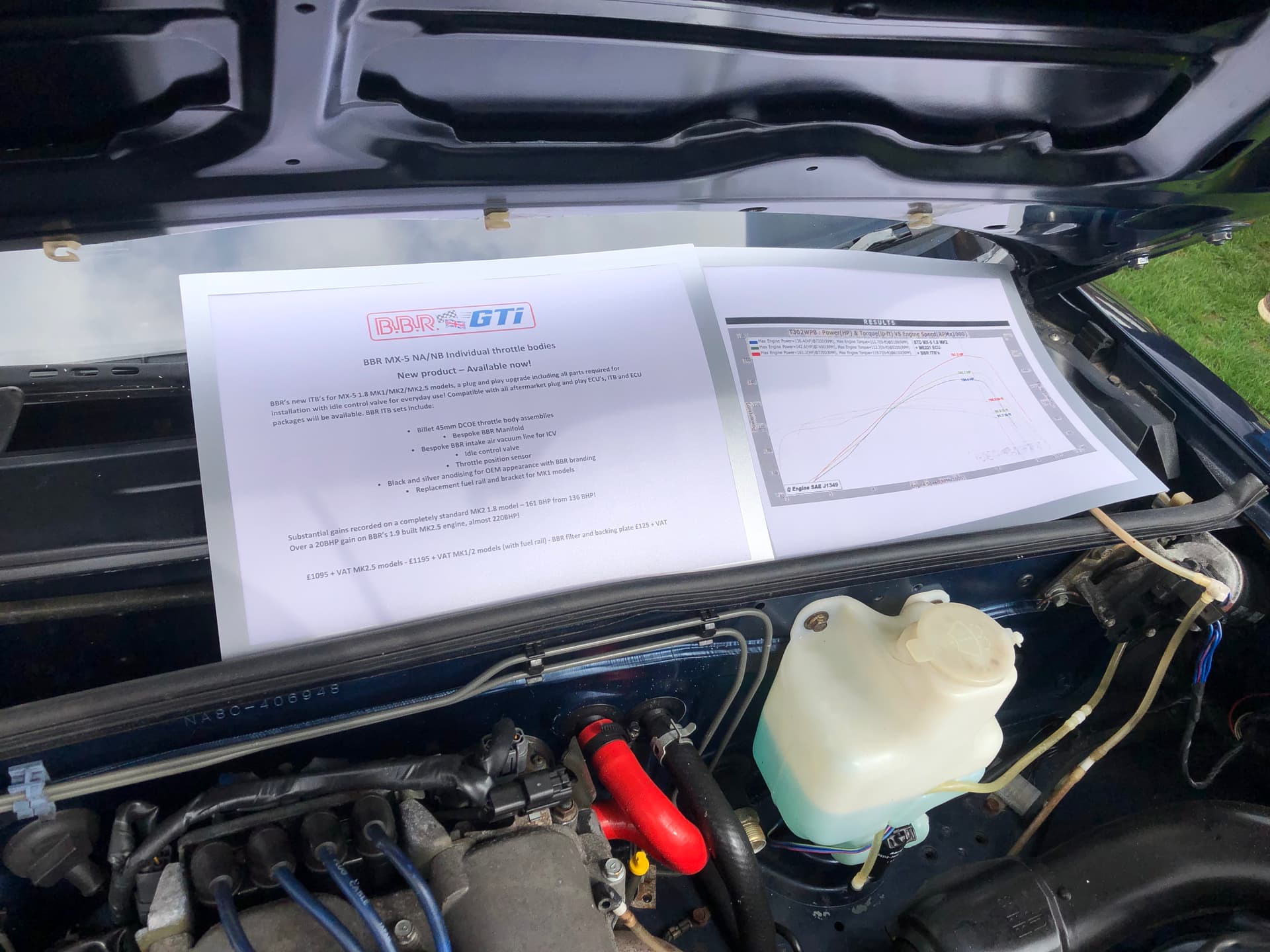

I took these two pictures of BBR’s ITBs at last year’s MX OC Show as I thought they might be something to add to my car. The graph is possibly on BBR’s website but shows a power increase from 136 BHP standard form to 142 BHP with an ME221 ECU and then 162 BHP with both the ME221 plus BBR ITBs.
Costs listed at that tme (agan on the graph picture) were ÂŁ1095 + VAT for mk2.5s and ÂŁ1195 + VAT for mk1s and mk2s. The ME221 price was not listed, but the BBR backing plate and filter was listed as ÂŁ125 + VAT.

BBR’s ITB stuff-
BBR do not make the ITBs they are bought in items.
BBR developed the manifold idle air system and installation set up.
I have changed from a Danst set up to the BBR set on my Eunos 1800 which has a few other mods done to it
Its Asbo with a straight through 2 1/2" system on a Simpson racing Manifold running an 8000 rpm limit at the moment.
Its an expensive game fo small gains compared with turbocharging.
