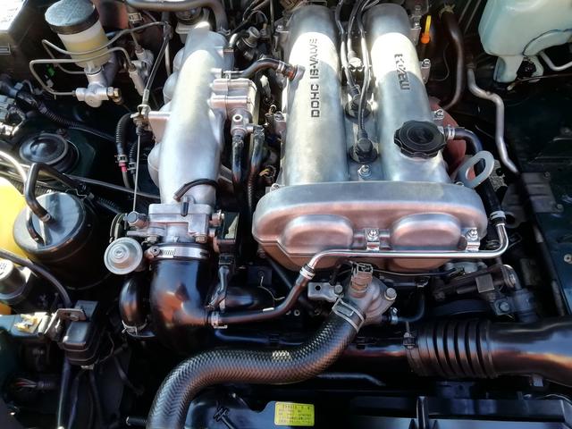

Yes two coats of the same make of clear coat, so rotary wire brush two primer, two silver, two clear very good finish and standing up very good, up to now,could be something to do with being VHT spray,done in March this year also the car is used regularly. So no expensive prep just time,which comes to me being a certain age,also re dyed the seats, Rob. PS note highly customized engine
removed exh heat cover only to paint with the VHT spray and has not faded or burnt off.
