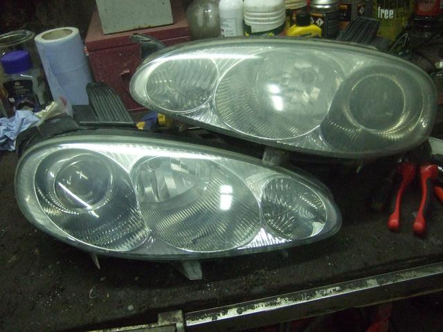

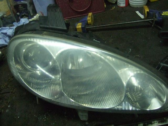

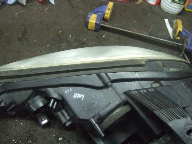

After removing the headlights from the car, get yourself a work space and try to keep it clean.

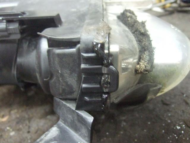

Remove the two posi screws which help to hold the lens to the body of the headlight

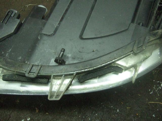

There are three plastic clips on the body of the headlight, use a heat gun and soften the clips and fold back gently.
Working around the headlight with the heat gun, heat the mastic which holds the two halves of the headlight together, body and lens, and gently pry the two halves apart. I normally start at the “square” end of the headlight as there is some purchase to be gained by inserting a wide bladed screwdriver between the two halves. Other people who have performed this operation have put the whole headlight in the oven to heat the mastic, but I have found the heat gun gives you more control of the procedure. Be careful with the black mastic. Its horrible stuff. You do not want to contaminate the inside of the headlights or you hands if possible !

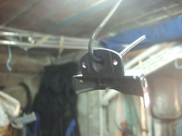

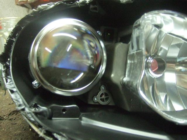

Once you have separated the two halves, place the lens in a safe place. The dipped beam part of the headlight is obvious, as it is the part of the headlight which is covered by the “projector” lens. Remove the two screws which secure the lens holder and remove the holder, lens and gasket. Place these somewhere safe and clean. You can now see the “beam plate”. This is the part that needs modifying.

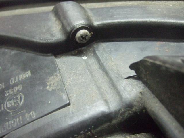

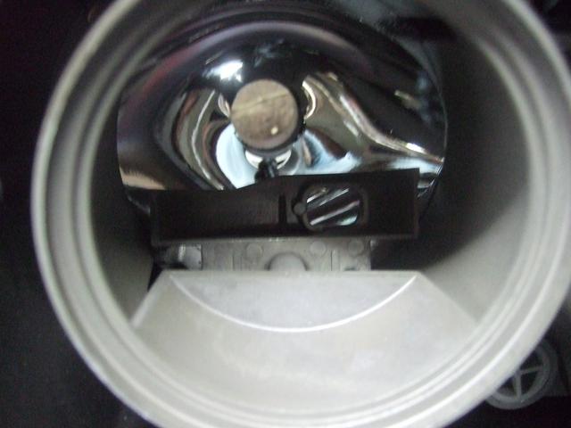

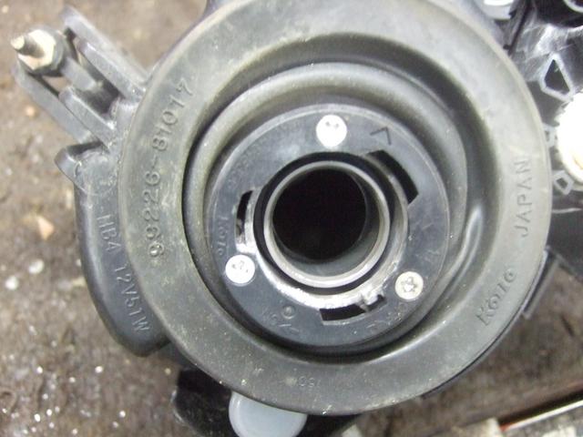

Turn the headlight over. If you look closely through the bulb aperture of the dipped beam, you will see the posi screw which holds the “beam plate” in place. This in my opinion is the hardest part of the whole operation. You do not want to damage the screw head. If necessary use the headlight beam adjusting screws ( left to right and up and down ) to adjust the position of the screw holding the beam plate within the body of the headlight to obtain the straightest angle possible on the screw head. Use a quality posi screwdriver with a clean undamaged head. Apply lost of pressure to the driver, and remove the screw. It will be tight. It is a self tapper in to a plastic molded hole. Once it "cracks it is pretty easy to remove. You can now remove the “beam plate” from the oposite side of the headlight body.

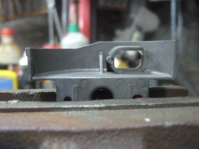

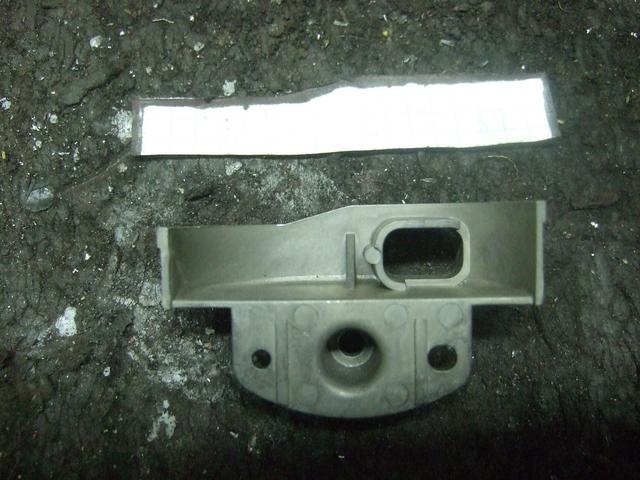

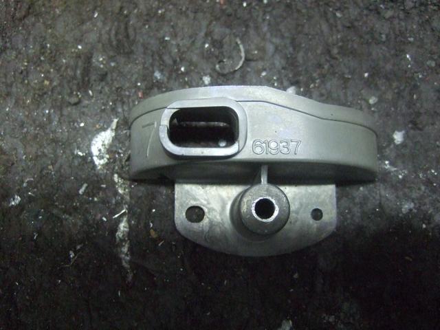

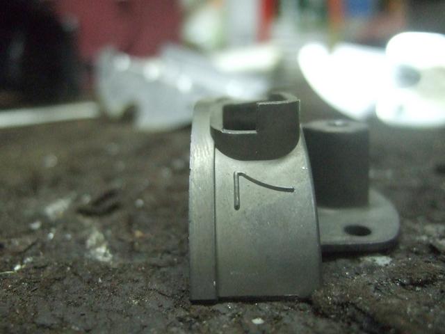

You can see from the image the shape of the beam plate.
This shape needs to be reversed to change the dipped beam from RHD to LHD ( __ to __/ )

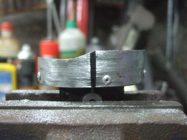

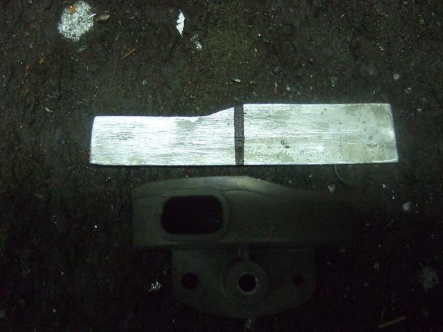

To do this you first need to make a paper template using the “beam plate” to do so.
Once you have a paper template, transfer this to a piece of tin plate, and cut out accurately with a grinder, or dremmel. Mark the center line on your new beam plate.

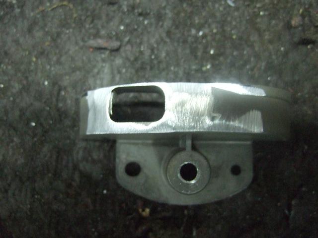

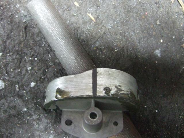

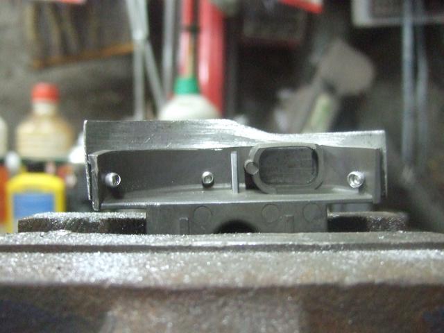

Next, grind your old beam plate flat, both horizontally, and also around the aperture on the back.

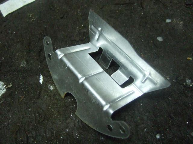

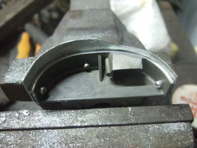

Affix the new beam plate to the old using pop rivets ( I use 2.5mm ). Make sure the center line you have previously marked runs through the fixing screw of the old beam plate. and that the new beam plate is fixed exactly parallel with the old. Make sure that you have the new beam plate in the right sense, in so much as the new high end is over the old low end and vice versa! If the new beam plate is not exactly right once affixed to the old beam plate, you can modify it with a file. The " high" part should be around 18mm, the “low part” 14mm, both being parallel with the base of the old beam plate.
Fill the join and rivet heads with a bit of gasket seal or high temp silicone to stop any light spatter. I spray the new assembly with stone chip, as the original is a matt finish. I have not noticed any diminished performance in the modified headlights. Blocking off the aperture doesn’t seem to have an adverse effect. I have modified over 15 sets of projector style headlights, and all have passed the French CT ( MOT ) with no issues. Both my XKR and X Type do not have an aperture in the beam plast, as you can see in the photo.
I am not sure if this is necessary, as the commercially available beam plates for my Jaguar XKR are a galvanized finish as shown in this photo.

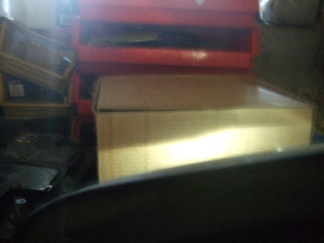

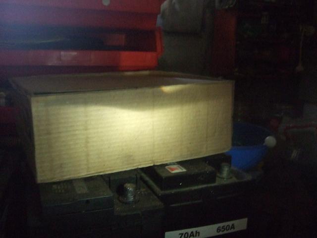

Here ar a couple of before and after photos of the light patern. The photos are not brill, and were achieved by shining an LED torch through the bulb aperture, but you can clearly see the " tick" moves from the left ( UK ) in the first shot, to the right ( Europe) in the second.
