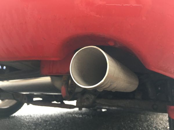

I’ve had my Madge for four years the only non standard item on her is the stainless steel cat back exhaust which I had fitted when the old unit started falling apart.
92185909_2994466627282476_81896844422021120_n
I use her for occasional track day, hill climbs and sprints.
