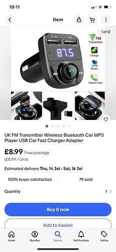

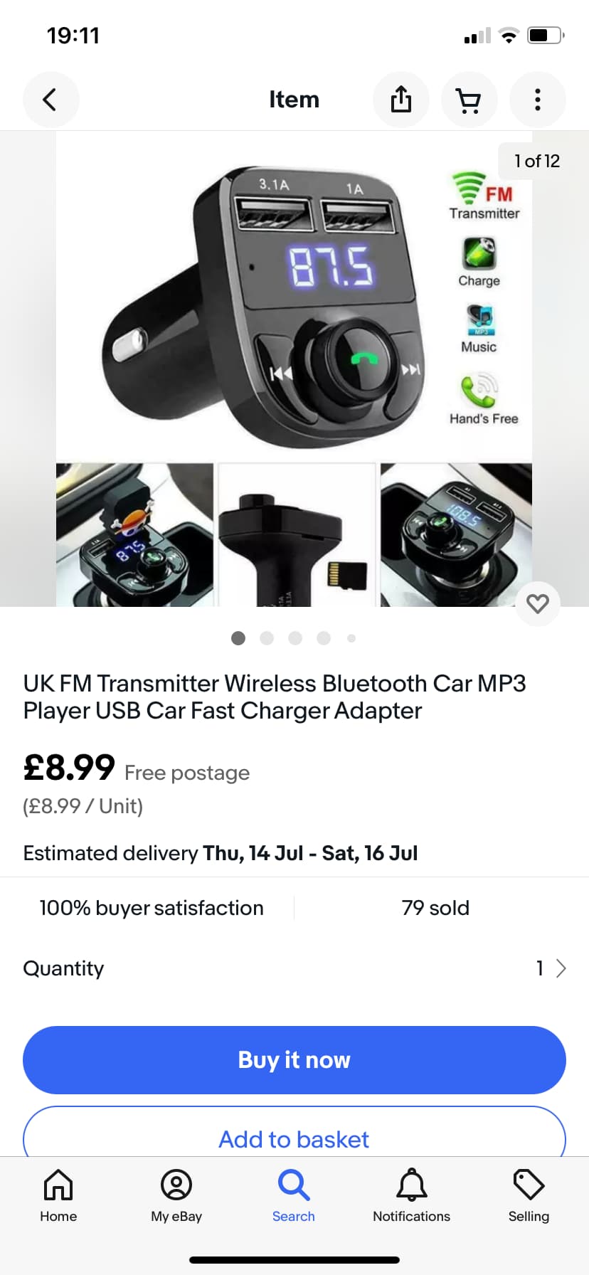

Something like this are great
Connect your music ( Spotify)
And phone call :telephone_receiver: all through the car speakers :loud_sound: :white_check_mark::white_check_mark::white_check_mark::white_check_mark:

Sorry to sound less than enthusiastic but it’s really not something I want sticking out of my dashboard. I might use it on a hire car for a week, but not in my car.

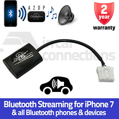

I do not want to change the look of the car at all, no head unit change. There’s a Connects 2 device that plugs into the back of the radio and is hidden behind the dash for just £35. Think that’s the solution for me.

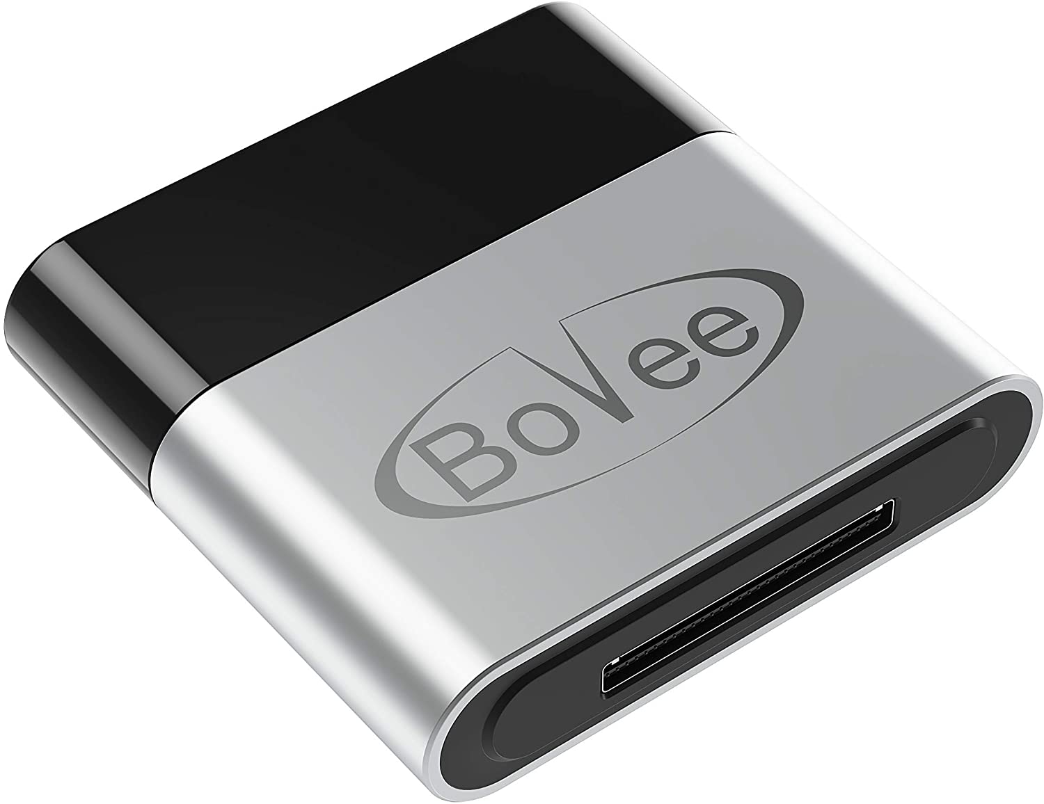

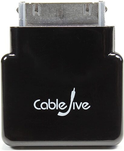

Like you I had the iPod dock with 30 pins, in the glove box, also like you I wanted Bluetooth for Music from iTunes, amazon music, and Spotify. I also did not want to have anything visible and if possible to keep the steering wheel buttons for track advance etc. so I went with a Bovee 1000. however, as has been pointed out the “OlD” 30 pin dock does not have sufficient power to charge iPod,phone and the Bovee so I also added a cable jack to sort the power issue. along with the Bovee 1000, I have everything I wanted including keeping the steering wheel controls all hidden in the glovebox.
When installed the round style adaptor is barely visible and needs no trailing leads or messing with the car at all. You can, and probably should, remove it when not in use to discourage the low life elements from taking an interest in your cars contents.

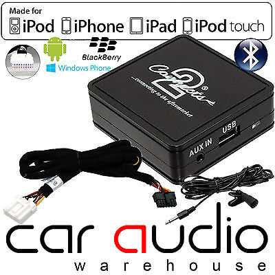

I’m thinking more of something like this.
No sign that anything has been added to the car, uses the steering wheel controls and you can hide the microphone in the factory position, also has a USB charging point and aux in. They do another version that doesn’t do handsfree calling at half the price so I may just go for that one.
I have bought and installed this one, which works great. Nothing visible from the outside, press the media button and connect. Feels like OEM. I connected the 12V cables to the back of the cigarette lighter socket by removing the pins from its plug, bending them open slightly and basically crimping them together with the 12V wires from the Bluetooth unit, using a pair of pliers. I have wedged the microphone between instrument panel and steering wheel with its cable hidden behind the interior trim.

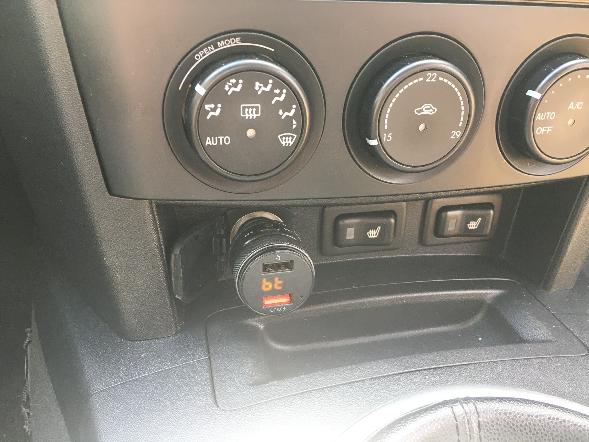

Whilst I understand where you’re coming from as the pic below shows the size and shape fit in quite well and as an easy fit/removable solution it’s hard to beat.
This option feeds to FM. Wonder if the radio reception is stable over BT source?
Set to the last (#6) pre set on the radio tuned to the top end of the fm spectrum and no problem at all.
