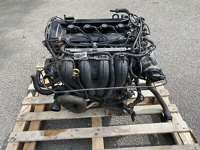

I have a high miler duratec sat in the shed, just south of Edinburgh, which you can have for £100. I can’t warranty it as I’ve never had it running- I bought it for my own car then I found a mazda 6 with the 2.5 locally for buttons so now it’s spare.
You can see the auction where I bought it from Scorpracing here:
I’ve stripped off the belt, tb and accessories since just for storage reasons, still has injectors rail and plugs. You’d want to inspect it at least and it’ll need some of your old bits as it’s a mondeo fitment.
Obviously it’s not a dream engine :slight_smile: But, it is buttons and it should work.
I don’t think the Ford engine is directly interchangeable, due to differences in the bellhousing, you need an adaptor plate. You’re also a bit far from me.

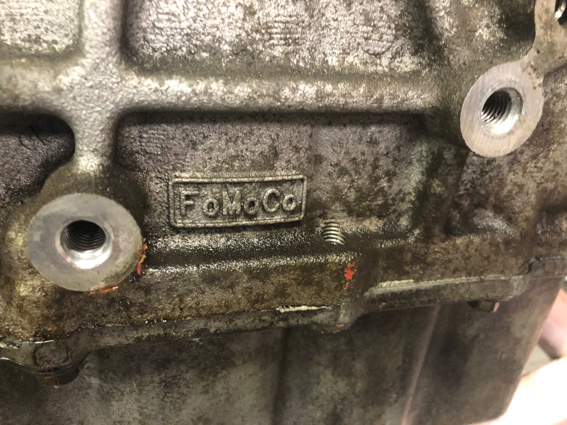

The one thing I can’t get definitive information on is how much of the Ford/Mazda engine internals are interchangeable. My block has FoMoCo cast on the side, so is it just the block or is the whole engine built by Ford?
