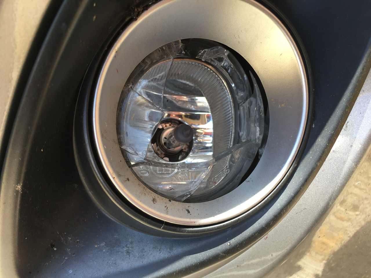

The front offside fog lamp lens on my 61-reg Sport Tech RC has shattered. I have given my VIN number to a supplier and they tell me that the unit for my car is the one for 2005-2008 cars, four years or more earlier than my car. Has anyone else had a similar issue? I feel uncomfortable ordering a part for an older car but the reputable supplier says it will be the correct part.

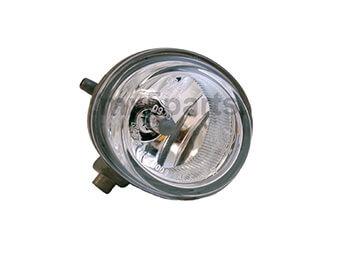

I have a spare set brand new, they have the part numbers
MZ012-4L and MZ012-4R
any way you can check your set.
regards
john

Hi John
Could you confirm the model yours are for? Your picture seems to be of the earlier model but I cannot be sure. Here’s a pic of mine.
On my nearside lens, below the the CCC marking is the code AO45048. A neighbour’s NC 3.75 lens has the code 1090023 below the CCC marking and there is a shroud covering the tip of their bulb.
Appreciate your help here.
“MX5parts” list different units for the Mk3, Mk3.5 & Mk3.75 so it does seem that the part for a Mk3 probably won’t fit a Mk3.5.
Those sold by MX5parts for the Mk3.5 are slightly different to the items on my car (also a Mk3.5) in that the MX5parts ones have the shroud over the bulb; mine are identical to yours Onedrew i.e. no shroud. I think the MX5parts ones are those sold by Mazda as an aftermarket accessory which could explain why they’re slightly different to the factory fitted ones on my car & your car.
A045048 is shown on both of my foglamp glasses.

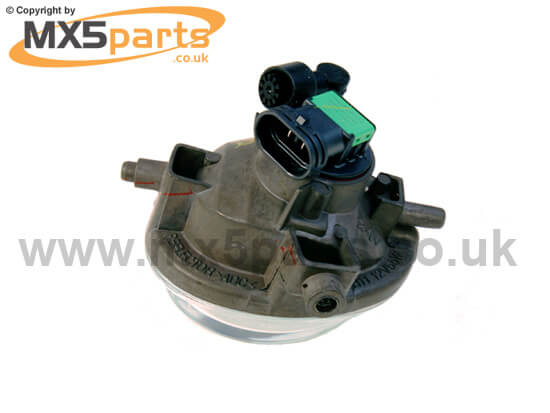

There are two pictures of the Mk3 part on the site. Are these identical to yours, by any happy chance?
Here are the pics of the 2005-2008 unit for reference
image image
