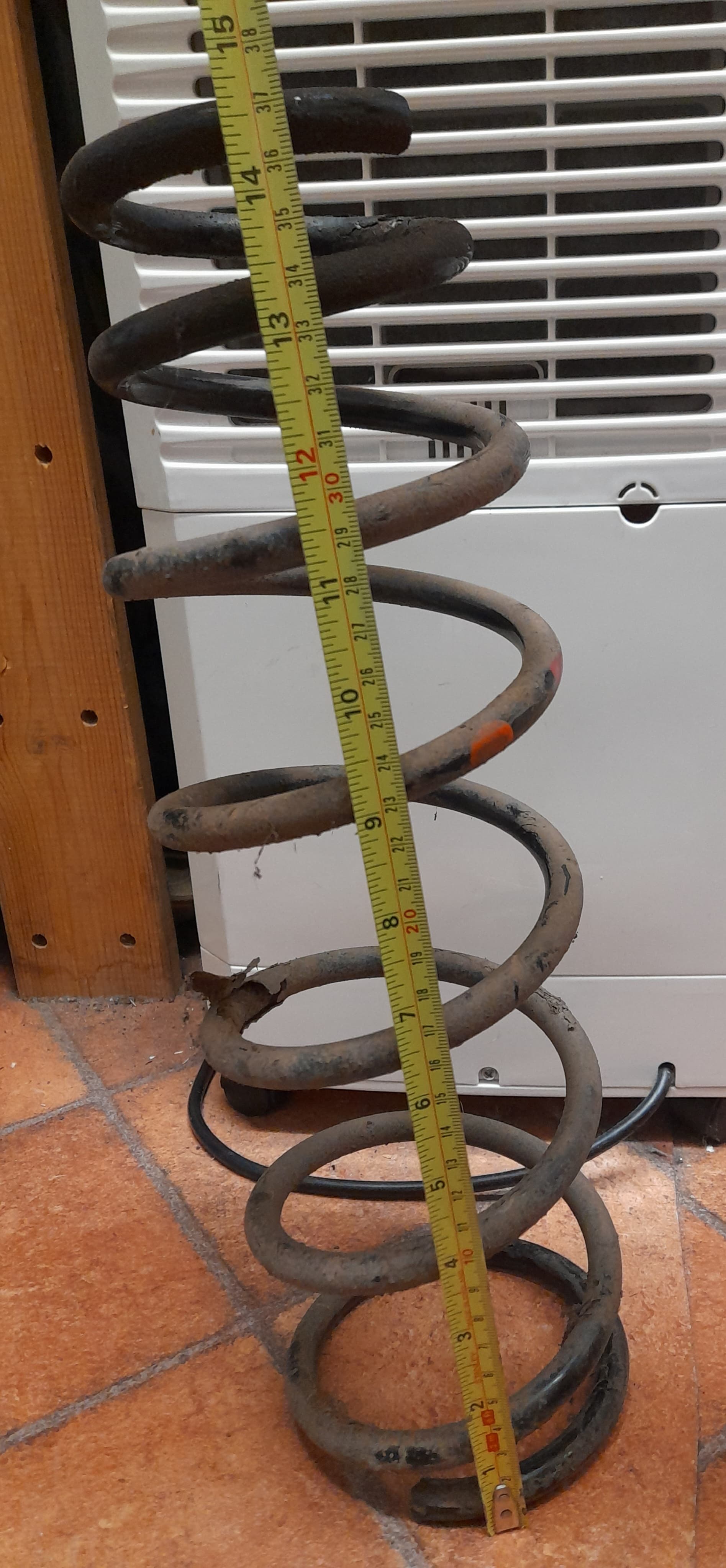

This is one of the old ones:
I make them about 375mm.
The reason I’m curious is the car now has a distinct 4x4 look that the Sport tech normally doesn’t seem to have!
I’ve checked the VIN with MX5Parts and they do insist they are the correct parts (everything on the suspension units were bought from them under their advise and the springs and dampers are genuine Mazda).
So, have the springs sagged that much over the years?

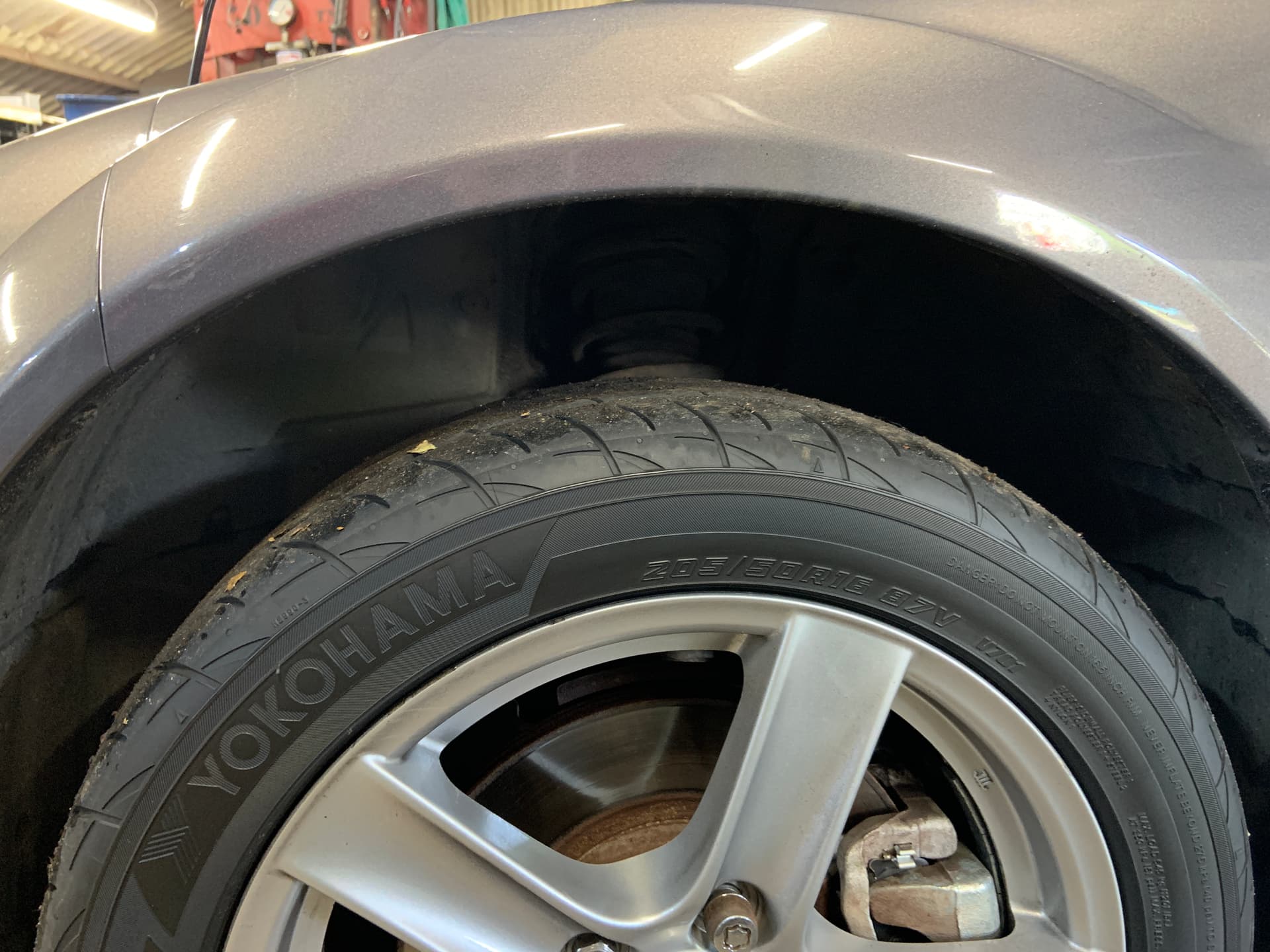

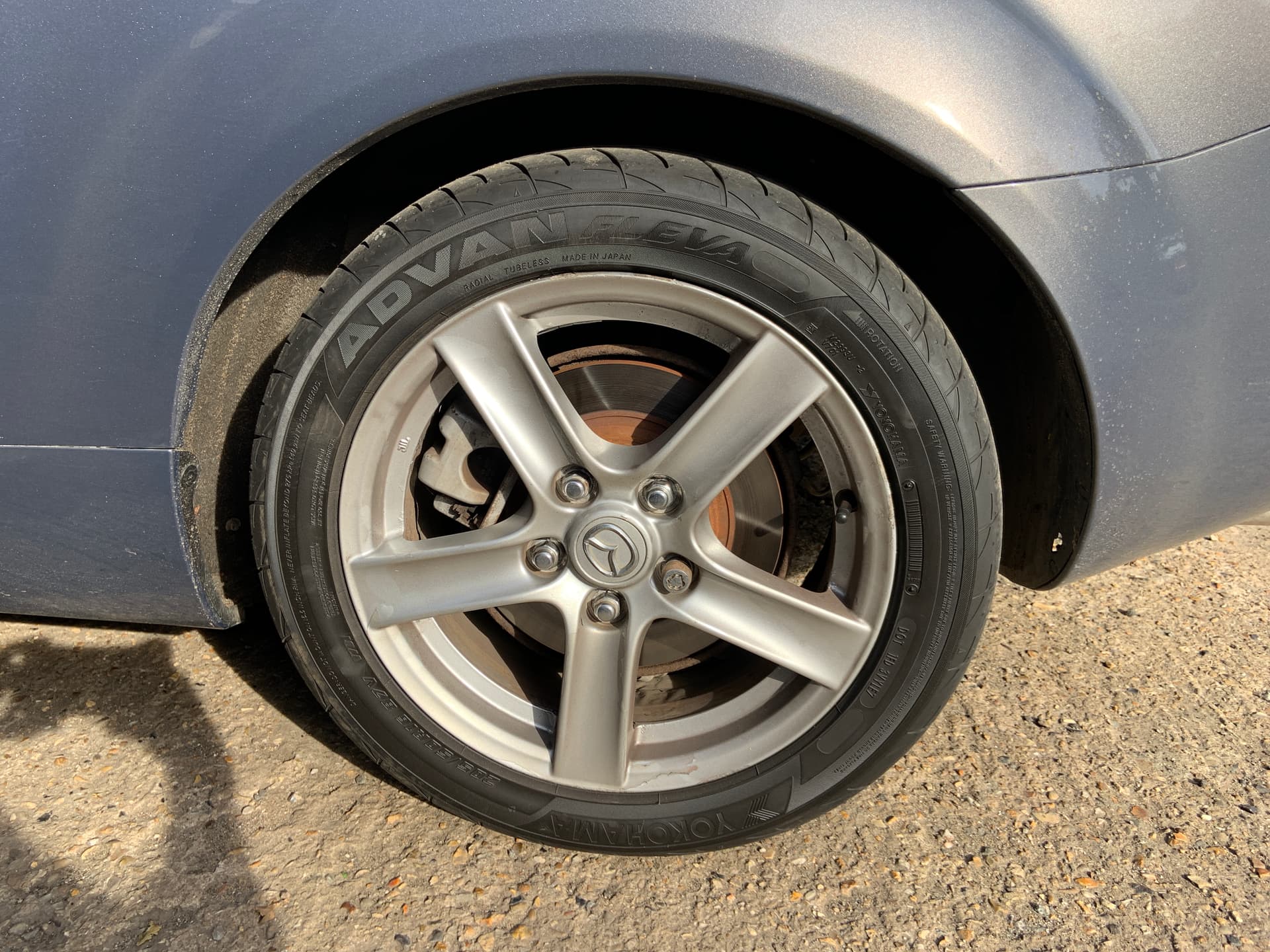

Before and after pics
So the fun continues!
Having measured the new height I confirm that it’s quite a bit higher than it was!
The garage I use have been brilliant (Field’s, Hanley Swan..).
They checked the new parts against the old parts and confirmed the new springs are indeed longer that the ones taken off (All other parts were identical).
The new springs have the same colour dots as the old ones, so what’s going on?
Have the old ones sagged that much?
Having rechecked MX-5 parts the fronts they suggested against my VIN number state the front springs are for a soft top. Mines the PRHT.
They list a different part for this car.
I’ve asked them for clarification…
Rick.
