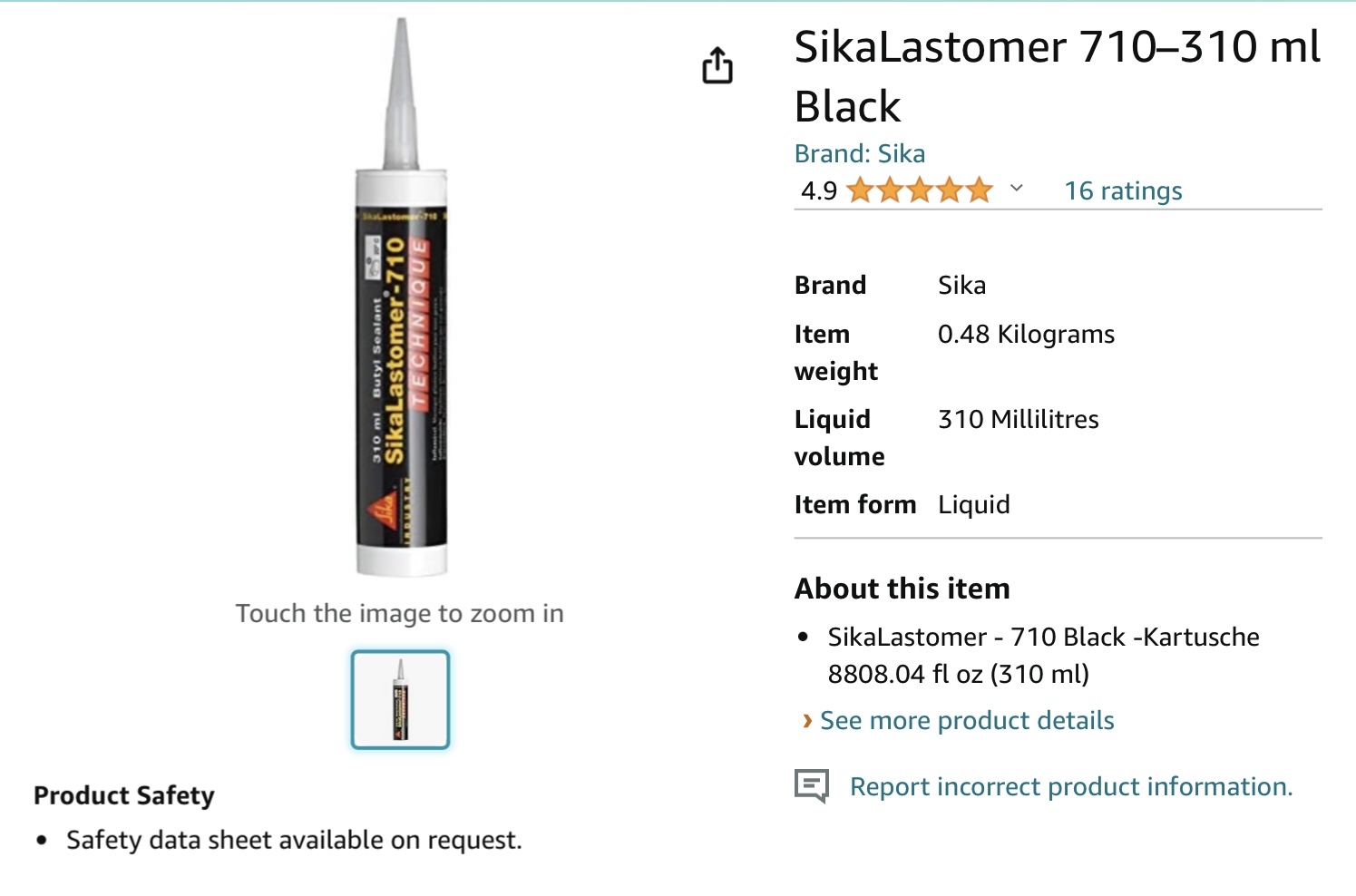

Use this…seals and is removable if needed and takes away any worry of a poorly made gasket.
