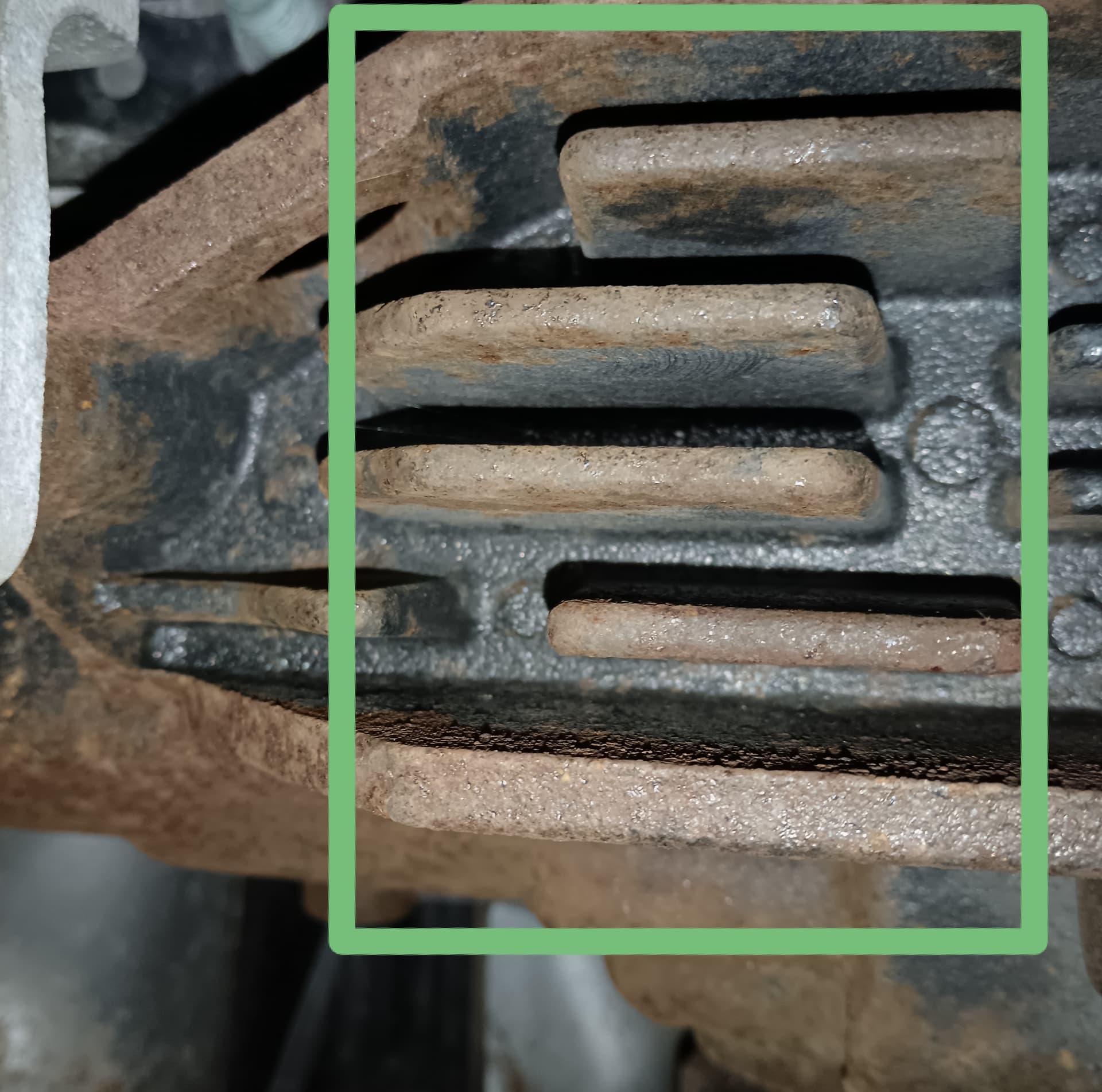

Then an old thread here shows pics of rubber bushings inside the diff housing, not sure if mine is the same though.

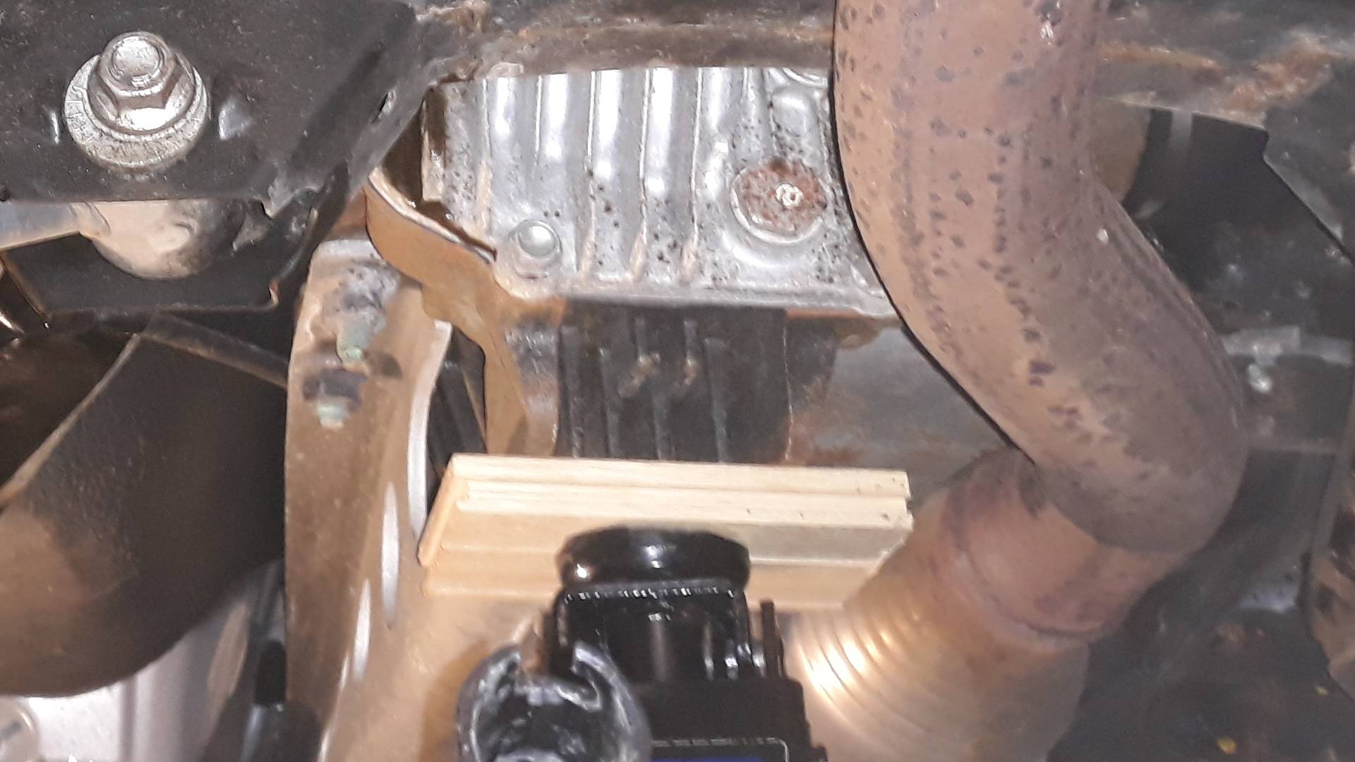

Use a block of wood to spread the load. Behind those fins is a solid area you can jack on. I use a small piece of 4x2 :+1:

I don’t know, I have a 3.75 sport tech with lsd. Correction anyway and apologies for bad info, it was my previous car that had the block. On this I used the timber to spread the weight across the fins.
I’ve had it up many times now and no issues. :+1:

Dean_S550’s pic shows it’s a steel diff casing, so plenty strong enough with some load spreading.
This is my NC 3.75 with an oak flooring off-cut as a tough wooden block, it’s centred under where the most diff metal is.
