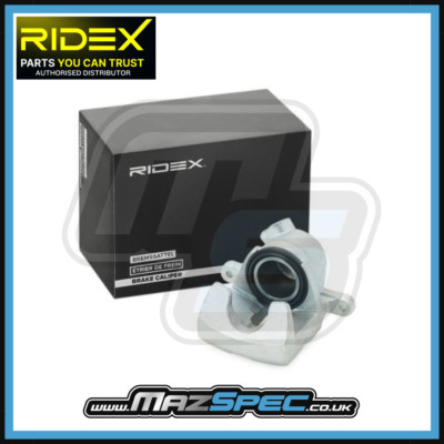

Anyone used these calipers.
Can’t find any info as to where they are produced.
Seems cheap to also include carriers ?
Too much on to find time to recon my originals so I’m after an alternative.
Thoughts / advice most welcome
I bought some from Ebay, looks like those and included brackets. (At a bargain price). But the brackets were threaded for wrong bolts so ended up using my old ones with the new sliders. Too late to return when in bits :thinking:
