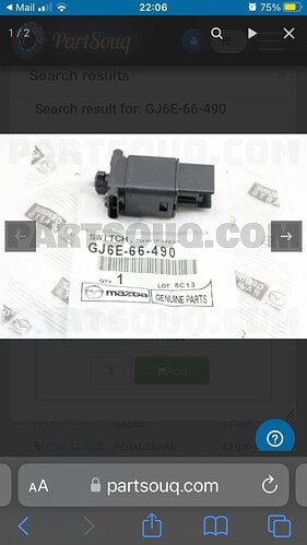

Looks like they’re different.
This MAY help.
https://partsouq.com/en/catalog/genuine/unit?c=Mazda&ssd=%24*KwFGcmNHMzo-Ejk2EBtsEx4KKi0zQk1AQVNAUBAQMiRGCxQCbUVBHRkUHzREPEUVYmtFCxseGDUBFV5dSB1HMkZNQwAAAAA_BaaD%24&vid=1421292234&cid=2493&uid=58482&q=
Top one here , maybe?
https://www.123spareparts.co.uk/oem-number/gj6e66490
Thanks!
So it looks like it is this one as the other one from that diagram is a match to the non cruise one sold by mx5 parts.
I’ll see if I can pull mine and confirm.
