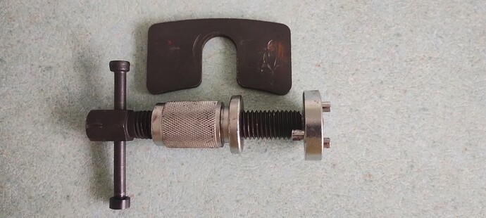

Hi, I’m just about to do discs and pads on my NC can anyone confirm if I need to take any special precautions mainly regarding pushing the caliper pistons back? Will I need a rewind tool or will just a G-clamp do the job and are the front and rear the same process? Many thanks in advance.
You will need a G clamp for the front. A rewind tool for the back. On NC’s
As above for the fronts, I use a simple tool like below for winding in the rears.
Cheers for confirming things :+1:
Cheers, any idea if that’s clockwise or anti clockwise?
Clockwise (both sides) to wind in, out it’s obviously anticlockwise :+1:
Thought so thanks for confirming though :+1:
Just ordered a Draper wind back tool :slightly_smiling_face:
there as cheep as chips and even used once used in a blue moon are handy to have can save you time as a few FFFF expletives :joy:
