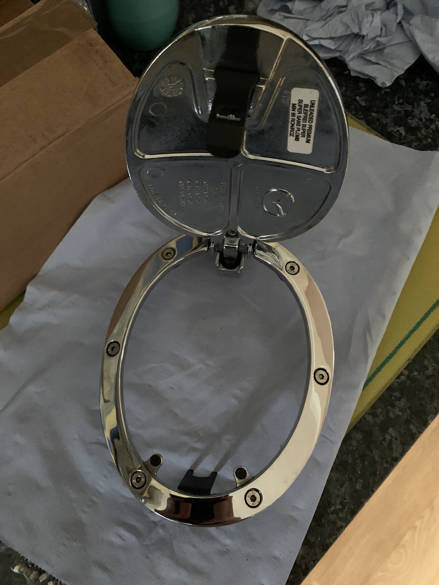

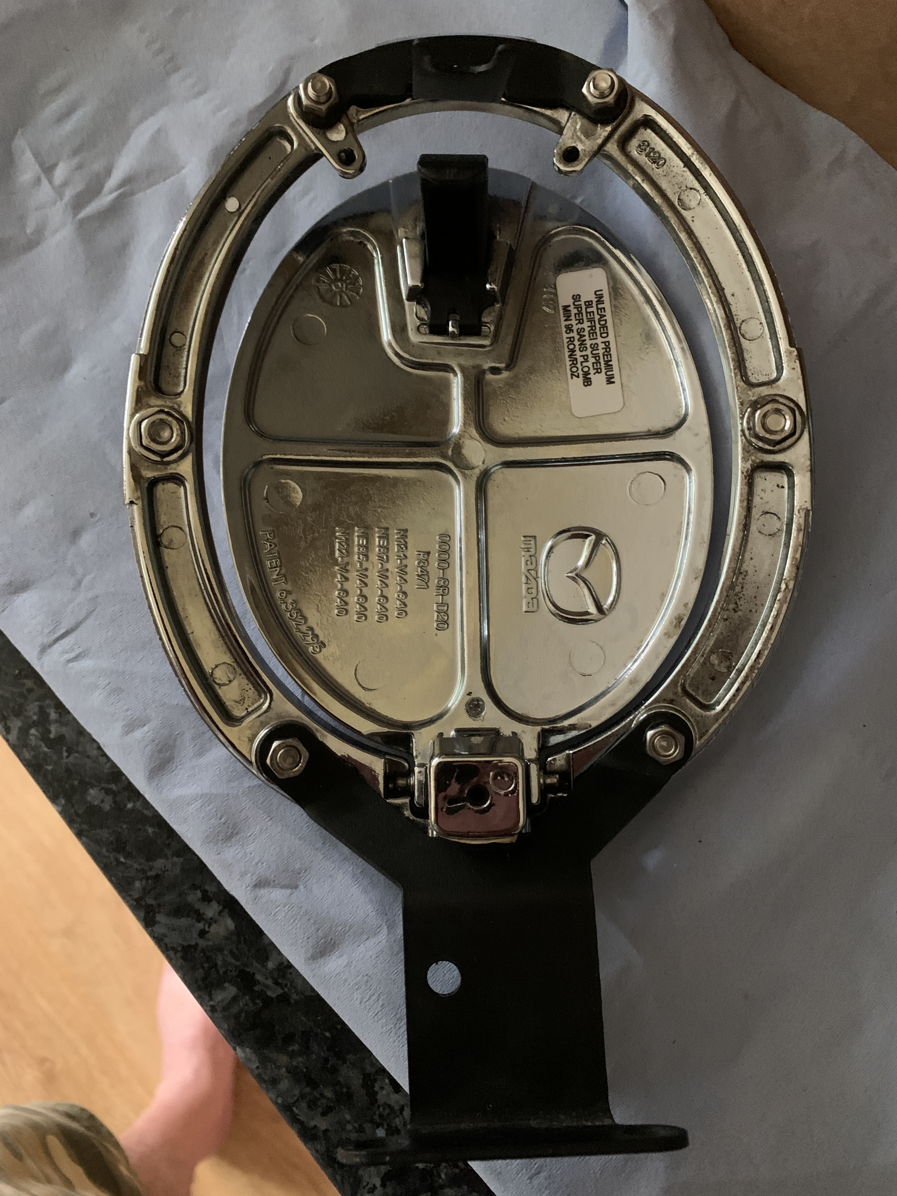

    Hi, I have acquired a chrome fuel cap for my mk3, can anyone post a picture of the inside of the cap as it only came stripped down with 2 Allen bolts (12mm/6mm)
    Many thanks in advance. :+1:t2:

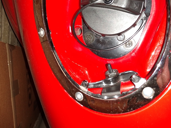

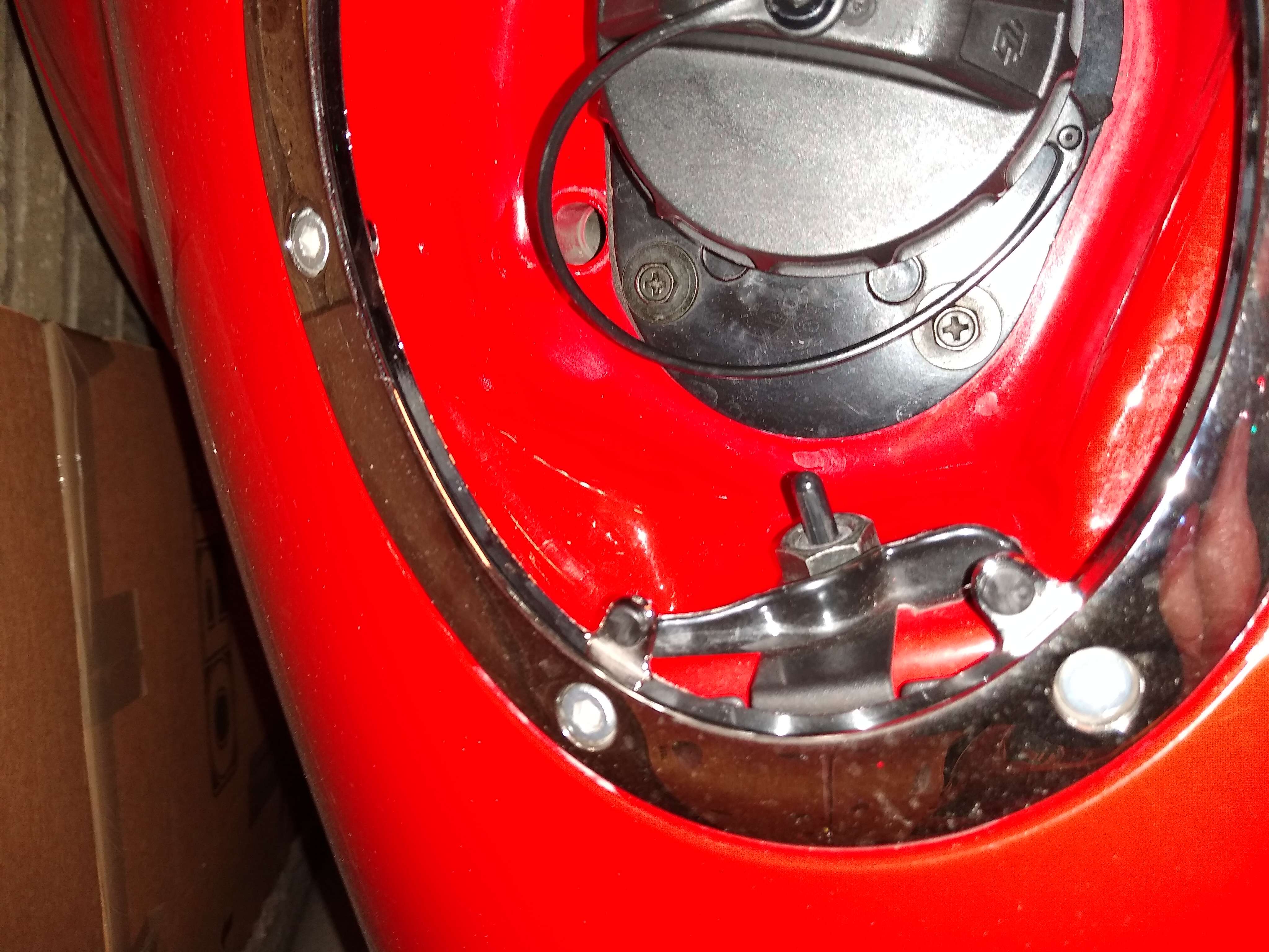

Sounds about right.

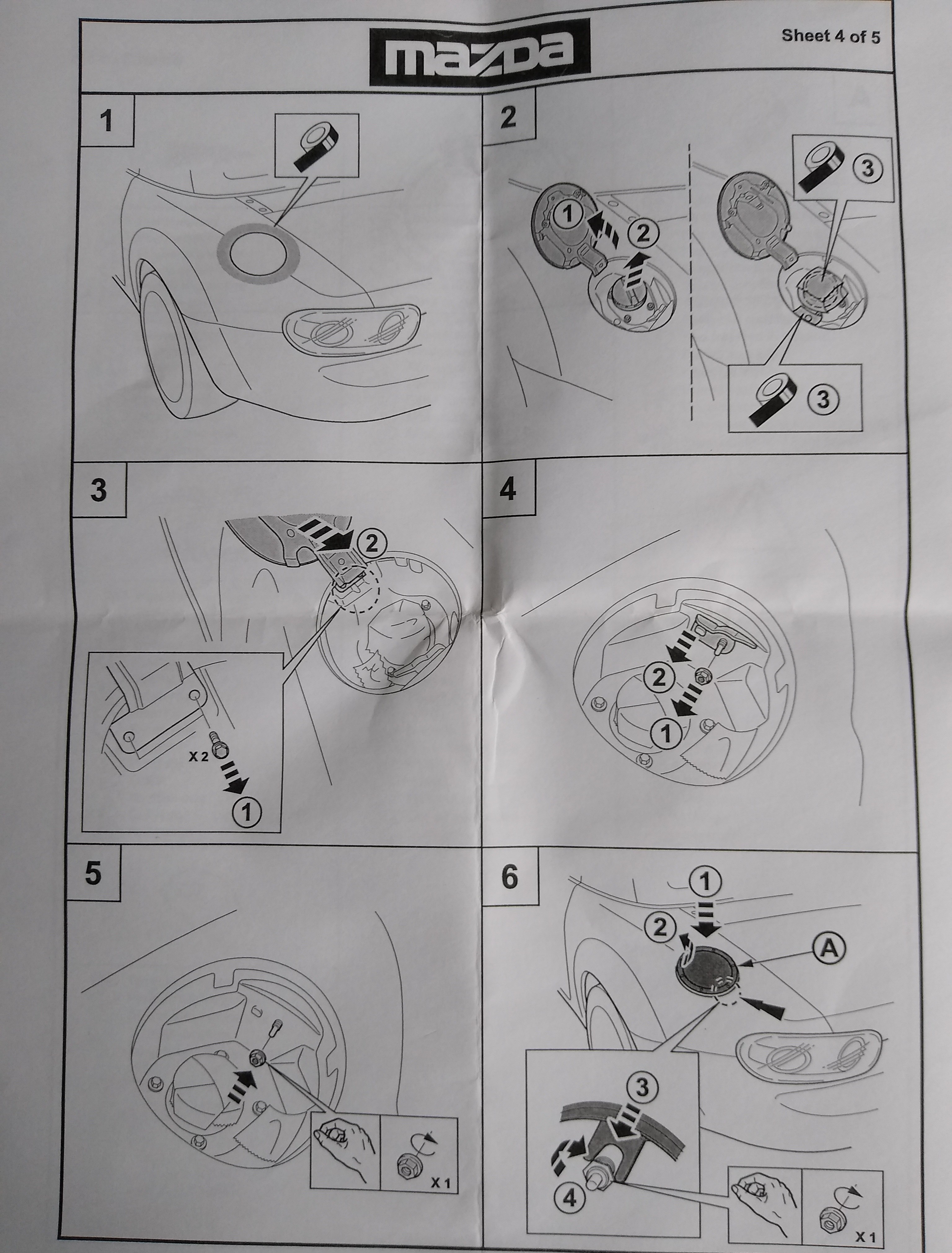

They fit to the position as the OEM painted lid (2 X bolts) The part where the lid catches to close you use the original nut over the bracket to secure.
Mines the original Mazda lid.

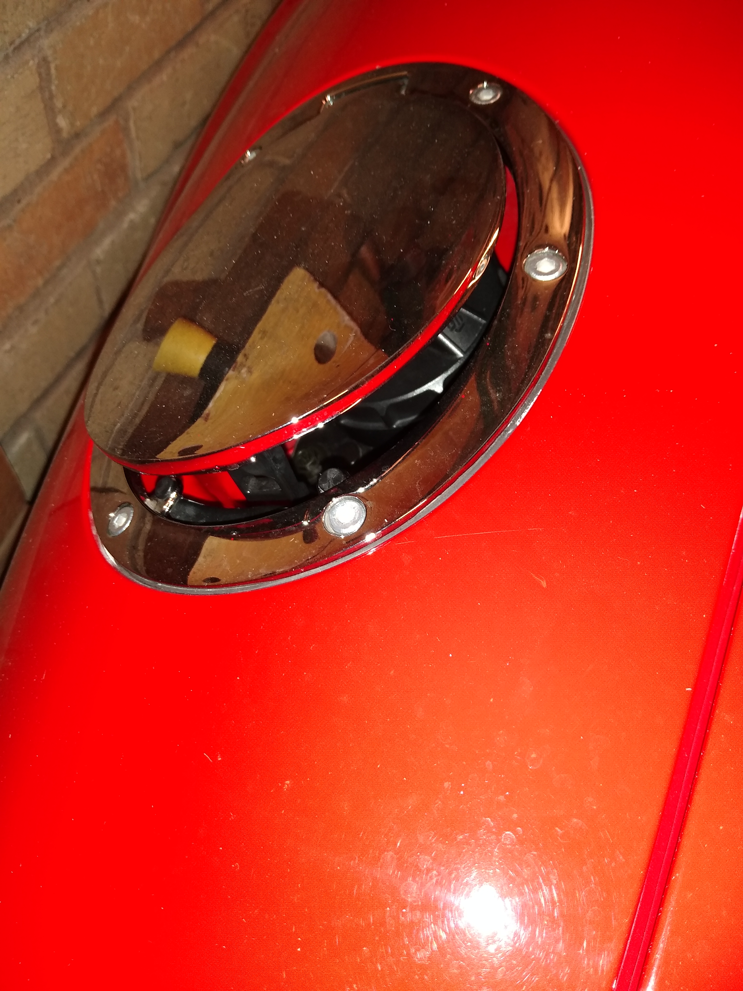

Pictures are a bit naff, car is in the garage so limited space to get proper pics. First pic shows the bolts just under the wing can’t get the camera in there.

I take it the longer bolts hold the ring to the brackets and the short bolts in the spare holes , can you remember if there are any sealing washers or spring washers on the bolts ? Also on release does the flap open fully os just unlatch??
Glynn

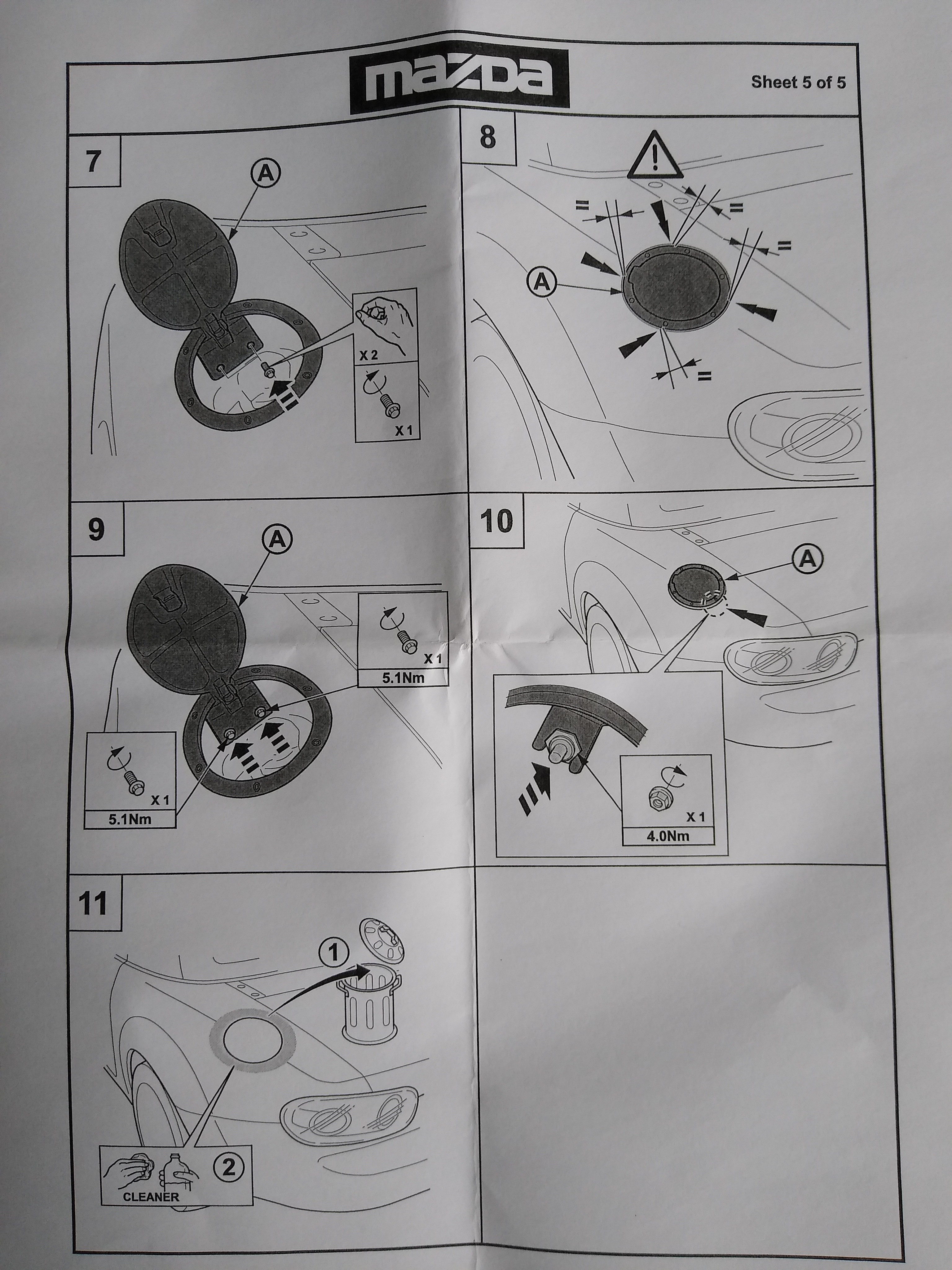

I’m not sure what you have, maybe a picture would help.
Destructions below for my lid. It’s as simple as removing the original lid and replacing with the chrome one.
I guess you have some vital bolts missing.

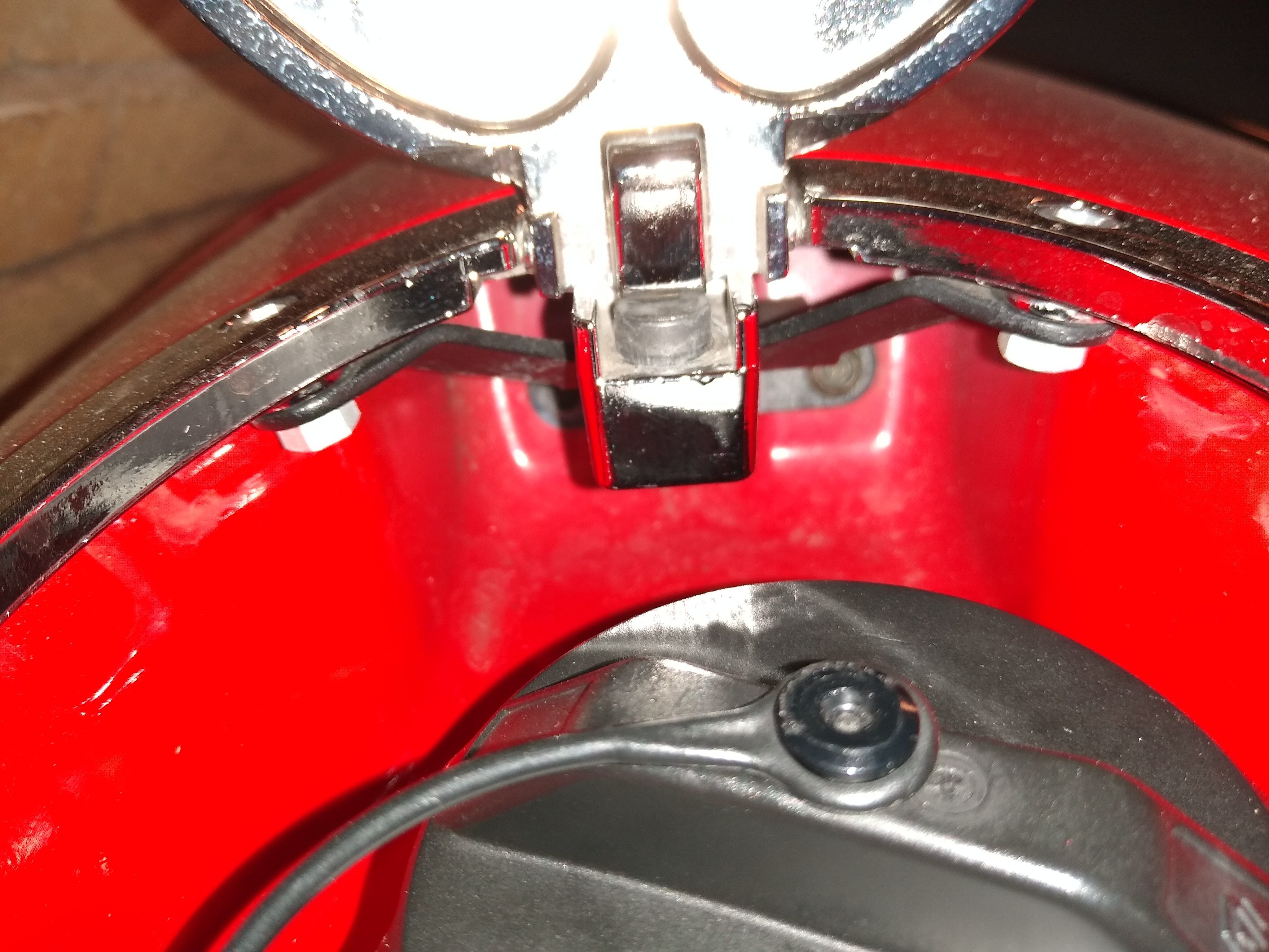

The lid just springs up around an inch when the catch is released, see pic.

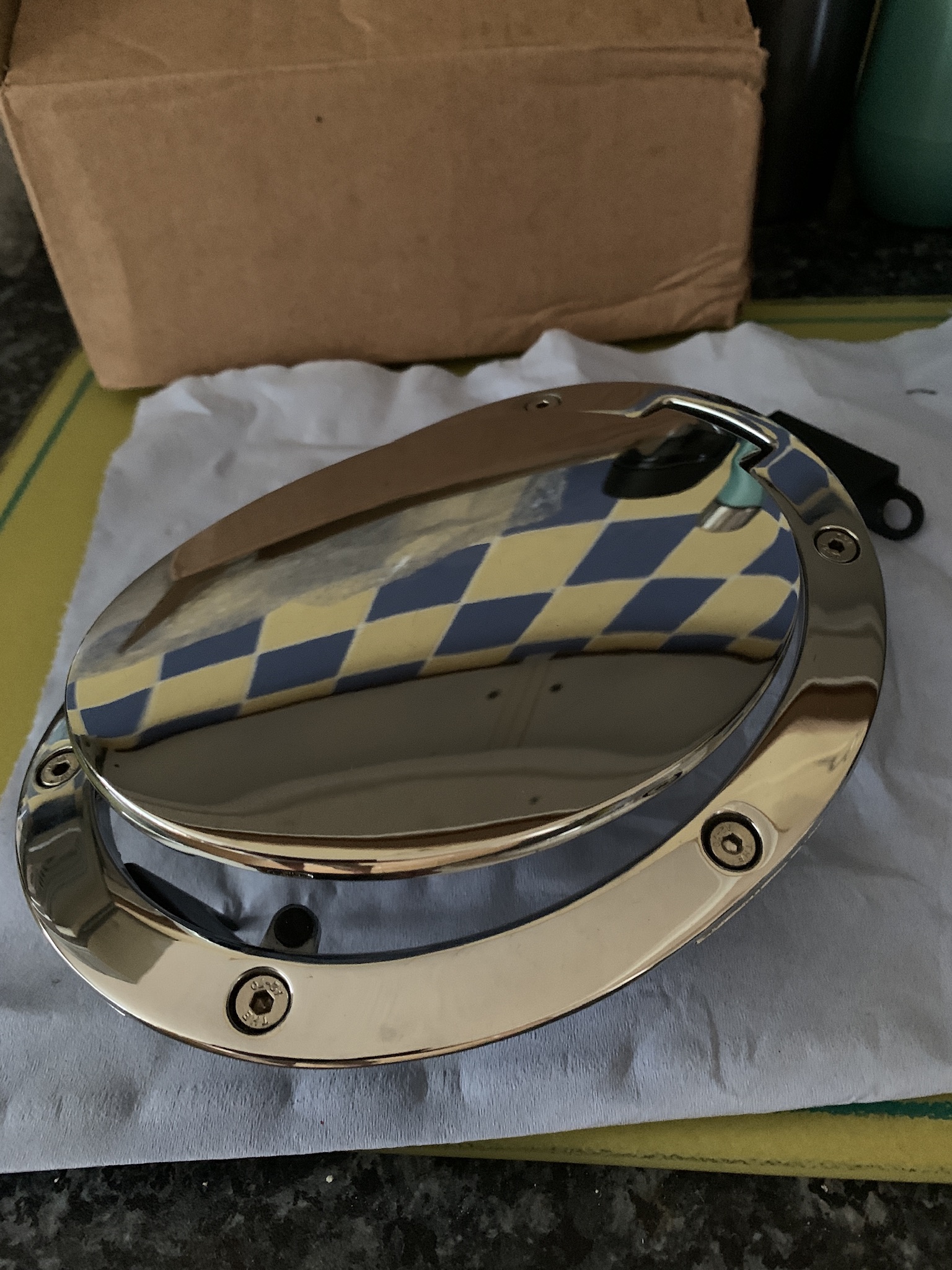

Hi Mick,
The fuel flap only came with a 12mm and a 6mm ally Allen bolt. I have replaced these with stainless Allen bolts, but now I have assembled the fuel flap it is self explanatory
Glynn…
Can I ask where you obtained the chrome cap please ??
All good then.:+1:
