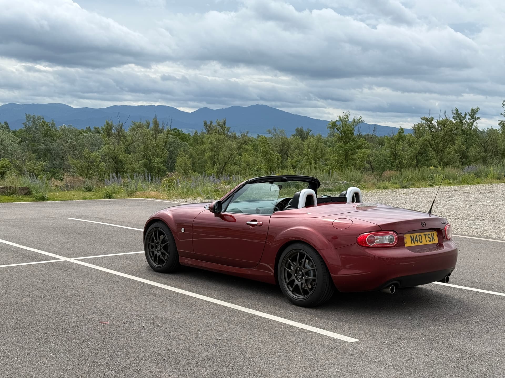

I settled on 340mm front and back in the end - worked well :+1:t2:
16s for autumn/winter:
17s the rest of the time:

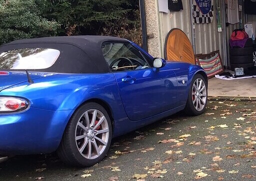

TEIN FLEX Z set at 345 all round
If they’re anything like the NA/B ones you’ll be winding those struts back up within the first 20 real-road miles.
But hopefully they’ve actually put some springs in the NC ones that can take their own weight.
Perfect ride height above on the Tein coilovers :heart: It’s what I was hoping for with MeisterR :face_with_diagonal_mouth:
