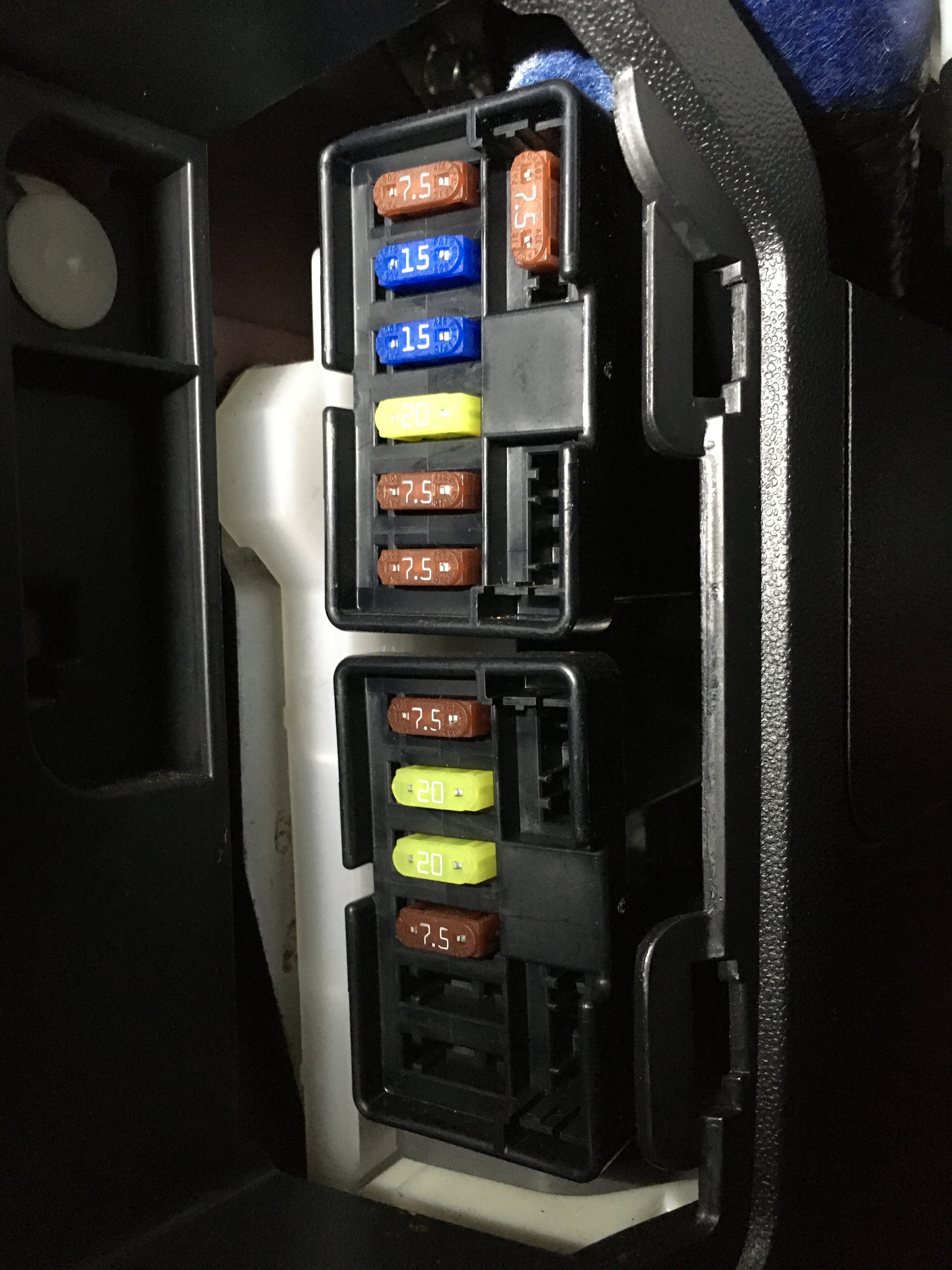

Remove the plastic cover from the passenger footwell fuse box and see if you have any signs of moisture.
I’ll have a look tomorrow when it’s light. :+1:

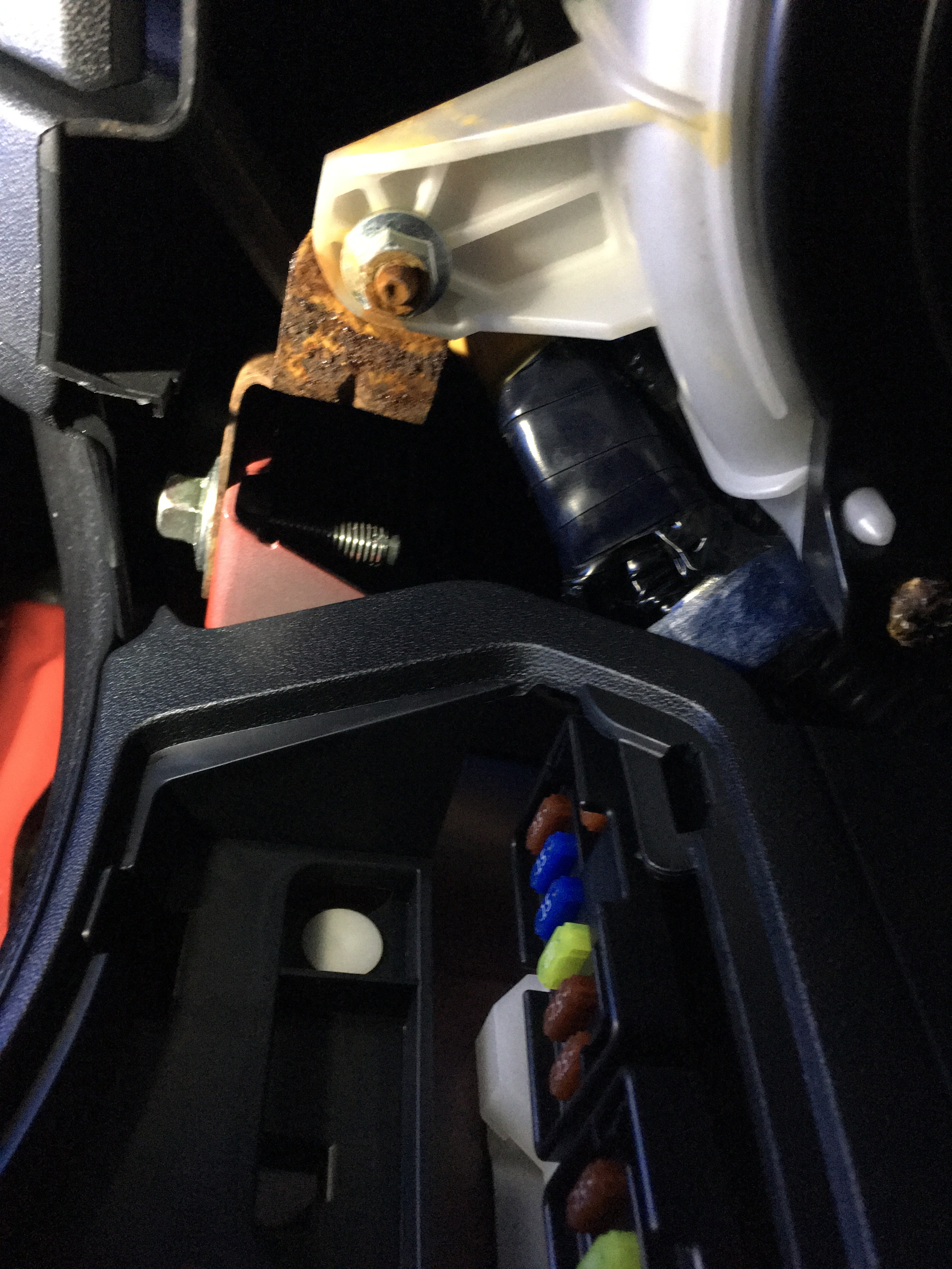

You shamed me into checking the fuse box! Water has definitely been getting past the scuttle grommet.
I knew it would get the better of you :rofl: nothing unusual in finding the yellow peril in that location.
Indeed and the designers thoughtfully placed the fusebox directly in the path of any water leaking in as a result of the inevitable failure of the biodegradable gaskets while they were at it.
How’s that for foresight??
Maybe it was a commercial decision, and they were hoping to rake it in supplying new fuse boxes!
