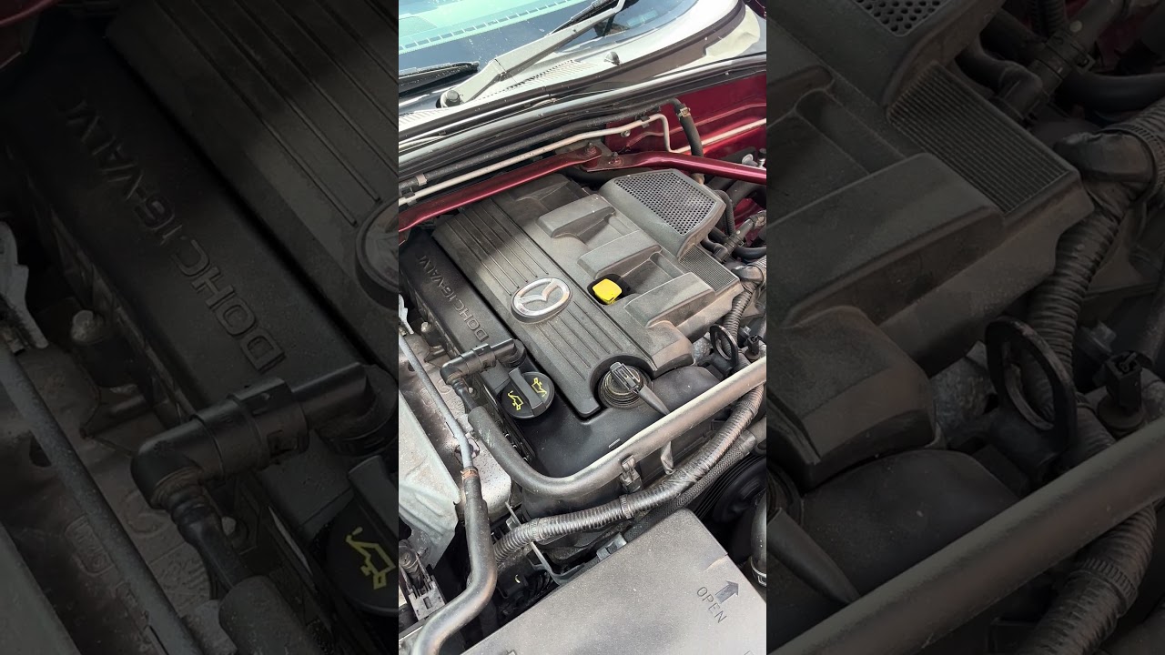

Hi all,
I have just been out for a spirited drive and it’s hot out today. I’ve pulled up and my engine is making this noise. What could be the cause? It’s not doing it when it’s cold. I’ve put oil in so it shouldn’t be that I wouldn’t have thought.
Any thoughts or help?

Myself I would listen to the pulleys the serpentine belt runs around.
A cheap engineers stethoscope is useful for this sort of investigation.
BUT BE VERY CAREFUL and avoid getting caught up in moving parts!!
See lots of helpful posts about this on the forum.
I agree with Richard as a first look see, could be the tensioner pulley, plus you would have a knock from cold if an internal engine noise. Has it been run low on oil or even driven on a low oil level?

I’ve just found a video on YouTube of a similar sound and someone says this is normal injector noise on the NC. It is only happening when hot and it doesn’t increase when I rev the engine.
Is this safe to drive?

Regards the noise, it does sound more like a pulley, only way of knowing is remove the auxiliary belt and start up, briefly run it and listen for the noise.

That’s started up just now after sitting for an hour. No ticking noise at all

I’ve never noticed this sound at all until today. By some margin this is the hottest it’s been since I’ve owned it.
Even now after resting it for an hour and restarting it the sound is not there. Odd

Thank you @davidcreswell1 & everyone else. I think I may well have found the culprit. I had the AC regassed on Friday. When I turn the AC off the ticking noise stops.
I don’t know exactly what that means in terms of fixing it but it’s not the engine at least.
If the rattling sound completely goes away when you turn off the air-con, I would be relieved as you are, and would take the car along to an air-conditioning specialist to see what needs to be done.

I’ve just satisfied myself that it’s the air con causing the issue. I left the car to cool for hours then ive taken it for a drive with the air con off and it’s totally normal, no knocking at all. Then I turn the air con on and the knocking starts up.
Definitely not injector noise. I would change the belt, idler and tensioner pulleys if they haven’t already been done. It’s very inexpensive and easy to do yourself with basic tools too. It doesn’t sound exactly like how my pulleys sounded, but it does sound like that type of thing.
If it’s AC-only, then it still might be the pulleys as it’s all on the same belt, but could also be your AC compressor or its clutch on the way out.
