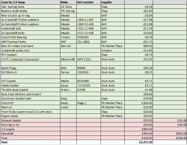

If your car is def solid and has no rust, then yes a 2.5 swap can be done. The 2.5 is ok standard, but needs camshafts to bring it to life. I did a costing about 2 years ago to swap a 2.5 into my 2.0, it was about £2.5k if I did the work. I had most of the parts, but decided to turbo my 2.0 instead as the bang for buck was better.

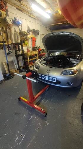

I have started to acquire the necessary tools. hopefully picking up an engine crane today.
