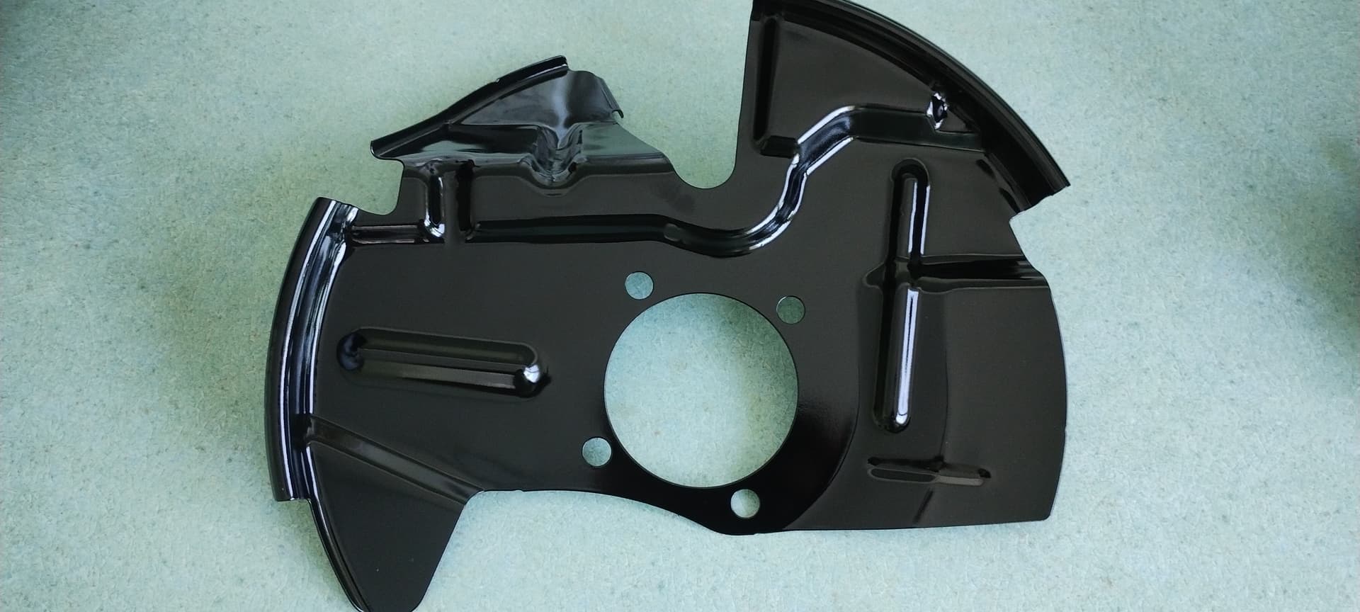

Did mine a little while ago. Once the disc is off its just 4 bolts that holds the wheel bearing assembly.Easy enough but you’ll need a bearing puller like the one I bought.
If they’ve never been out before they can be a bit of a pain. Also, remember to remove the abs sensor from the back of the hub first.
My method in the link below, the video, everything else apart from hub removal tool is the same as above. My tools (bolts and a flat bar) cost £4.
It started with getting these painted up to fit…
[IMG_20230811_115355340]
