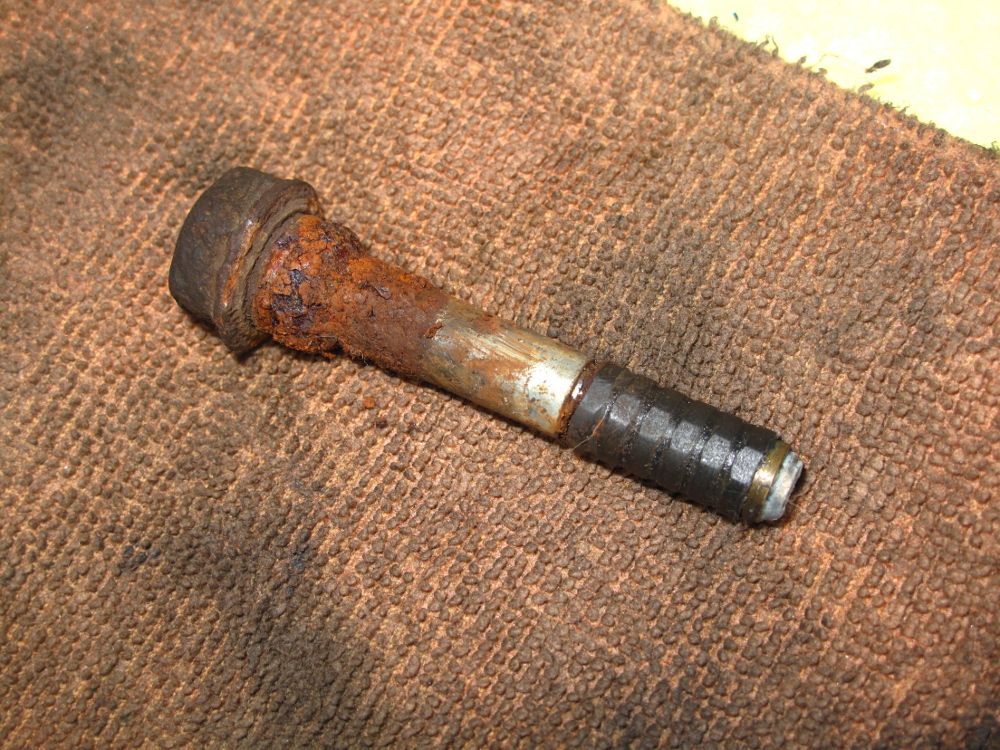

My NC has done 120k miles and I have owned it for approx 20k miles. In that time the only real problem I have had is with it needing two brake callipers.
Just the other day I got that familiar feeling of another calliper binding on. Checked the heat from the wheels and it was confirmed to be the front right.
In the past I have been away from home so had to go with garages recommendation of changing the calliper. But this time thought I would check the slider pins first. As you can see from the pic below this one (and the other one was the same) is quite badly corroded.
Gave the pin a good clean and a coating of Silicon Grease (which I understand is what you need due to the rubber boots). Both pins are now moving freely by hand which they weren’t doing before.
I will probably get new pins for this if this proves to fix the problem. But it does show that these pins should be inspected probably once a year on older cars.
PS. Rubber booted pin shown was the bottom one.
What that says to me is that the rubber bellows has been letting water in and holding it is for a significant amount of time and should have been picked up a long time before now.
