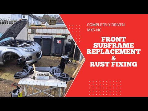

NC front subframe replacement & rust killing video
My video on removing the front subframe, chassis rust fixing and the fitting replacment powdercoated subframe.

Impressive, although I have to say that from the pics the rust didn’t look that bad.
Completely, get under there and fix it before it is bad. Thanks for watching.
