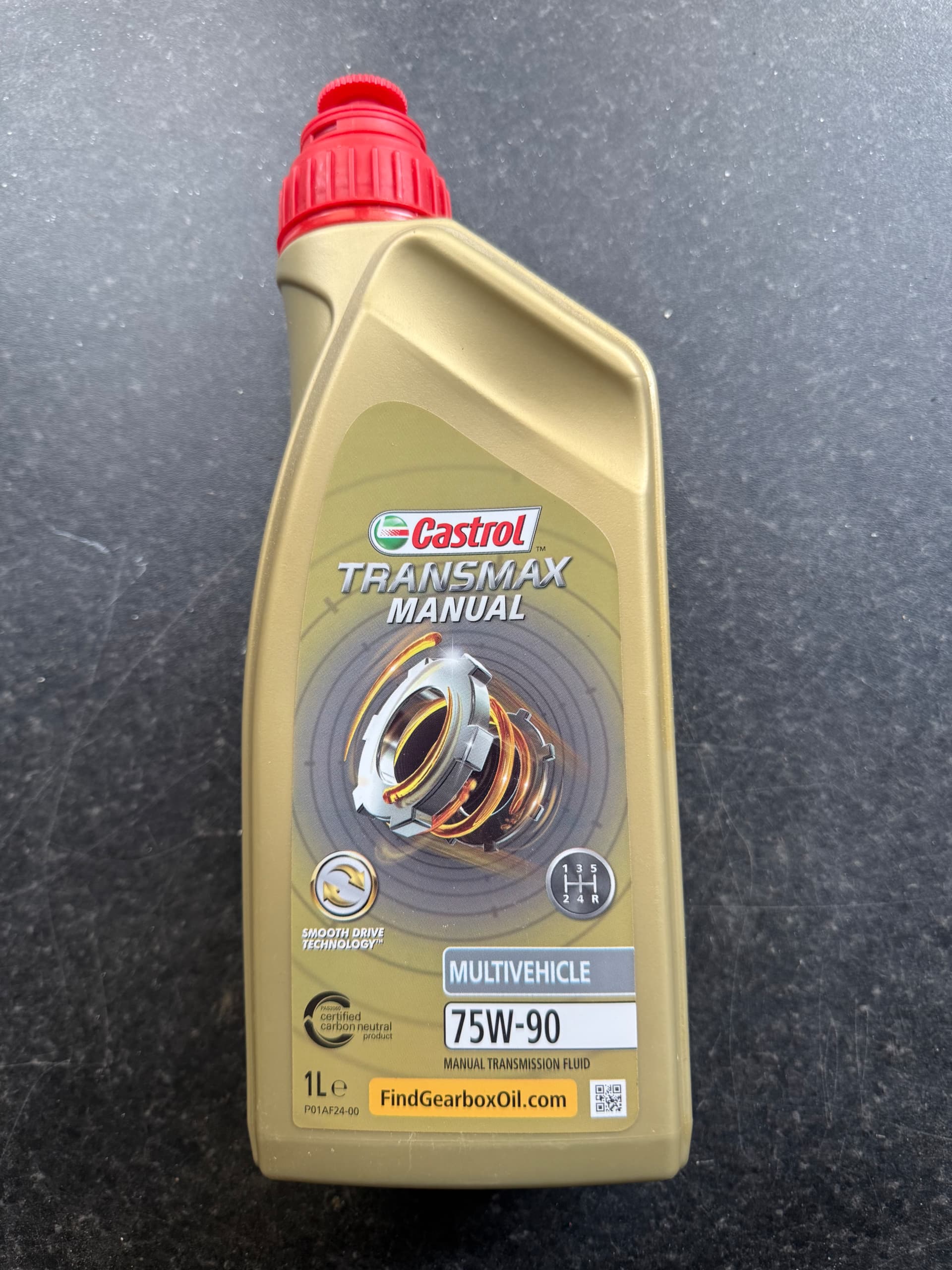

Are these 2 oils okay to go with?
Is the Castrol Syntrans Multivehicle 75W-90 the stuff to go for the gearbox
Castrol Transmax Universal 75W-90 for the diff?

Yep both perfect for the NC. The universal diff oil should be for GL-5 which it is.
The 6 speeds take a tad over 2ltrs so buy X 3 bottles for that, 1 bottle will do the diff in that oil type👍
I am trying to reduce the notchy shifts between 1st and 2nd gear in the 6 speed box, always good to have other options, so thanks.
Perfect :+1:

Just resurrecting this old thread on gearbox oils and cold shifts. I’ve just been reading a thread about gear oils for the ND and it seems even though the manual says 75W-90 the cars actually come with 75W-80 and that is what Mazda dealers themselves use. Was just wondering if this same theory could also work for NC boxes to help cold shifts?
Just to confirm I’ve got an NC 6 speed and am about to change the gearbox oil. I currently have no cold shift problems at all so the last thing I want to do is change the oil and give myself a problem I didn’t have before!
On a recommendation, I changed from Total to Castrol and have no regrets whatsoever.
No cold shift issues with mine.
Stick with the GL4 only.
NC 3.75 6 speed box.
Thanks, yes I was planning on using the Castrol I just thought this was an interesting theory. I think I’m a bit paranoid about introducing a problem I don’t already have! :grin:
I did when I first changed it to Total.:roll_eyes:
Then back to normal good box with the Castrol.
Thanks that’s good to know, I’m sure I’ll end up using the Castrol :+1:
