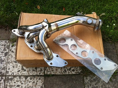

(See pics of the IL one attached). It was all done on the header itself, hence the supplied long lead.

Just for clarification, my set up is a IL header, standard mid section with the cat and a Cobalt SS rear box.
You’re right, the MX5 parts I.L header shows 2 ports on the manifold, I guess I got confused with the racing beat option as it was my original choice but then VAT and postage kicked in! You just saved me £70 (which is what the shop was going to charge to weld on a bung)

On MX5parts I.L header page it states
“These are now supplied with an oxygen sensor relocation kit which is required to fool the ECU into thinking the first cat is still there and stopping the MIL light coming on. You will need to install a bung behind the second cat and using the supplied wiring harness, move the second O2 sensor down, after the secondary cat.”
