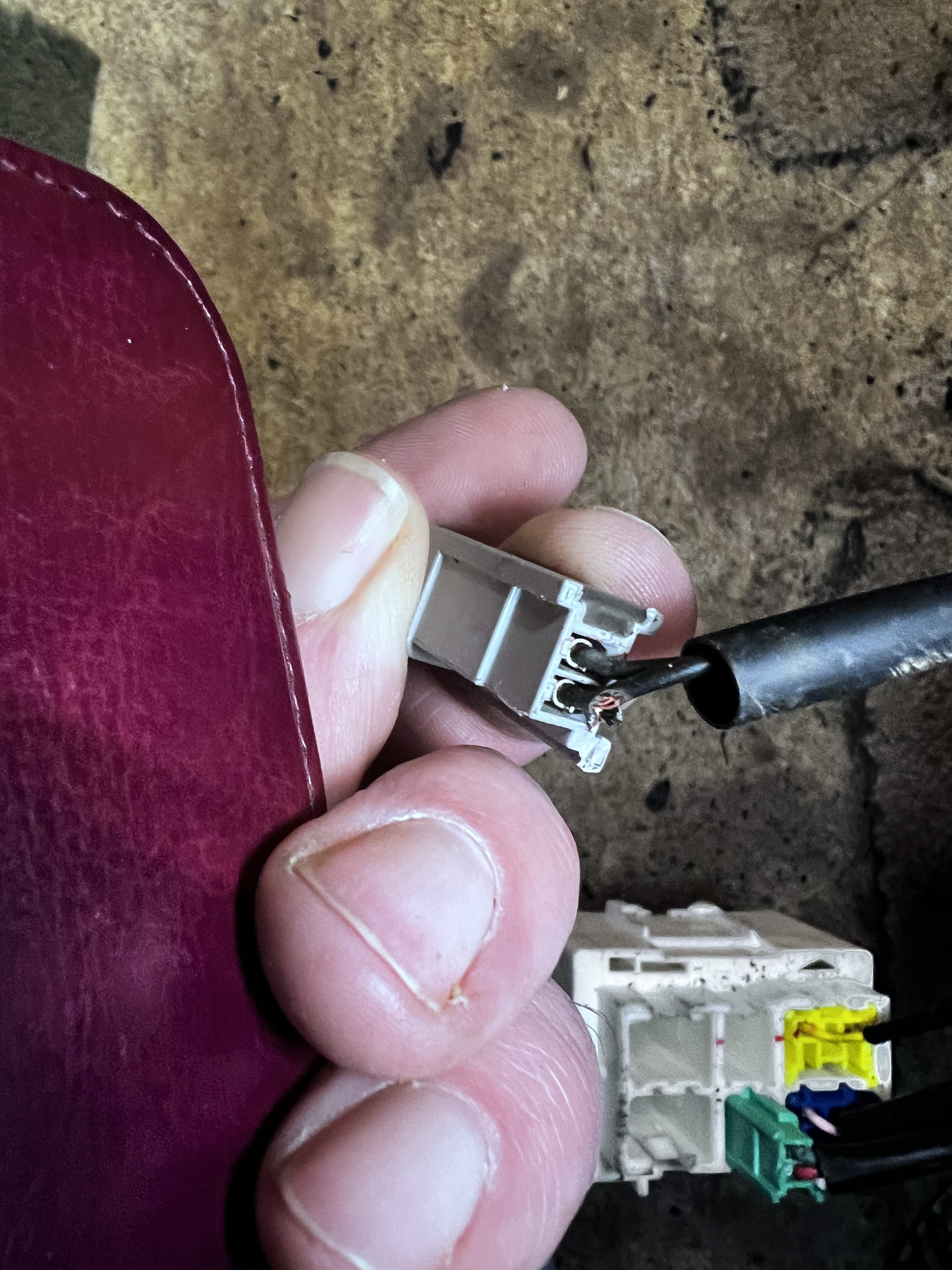

@Roadster_Robbie finally managed to get seats out and take a good look. Found the whole connector block was loose under the seat and some electrical tape had previously been used to try and hold it to the fixing point. The green wire looks intact but may have been loose whilst under the seat. What I can see is that the black wire on is slightly damaged so maybe the green has some hidden damage to. Do you know what the black wires are for?

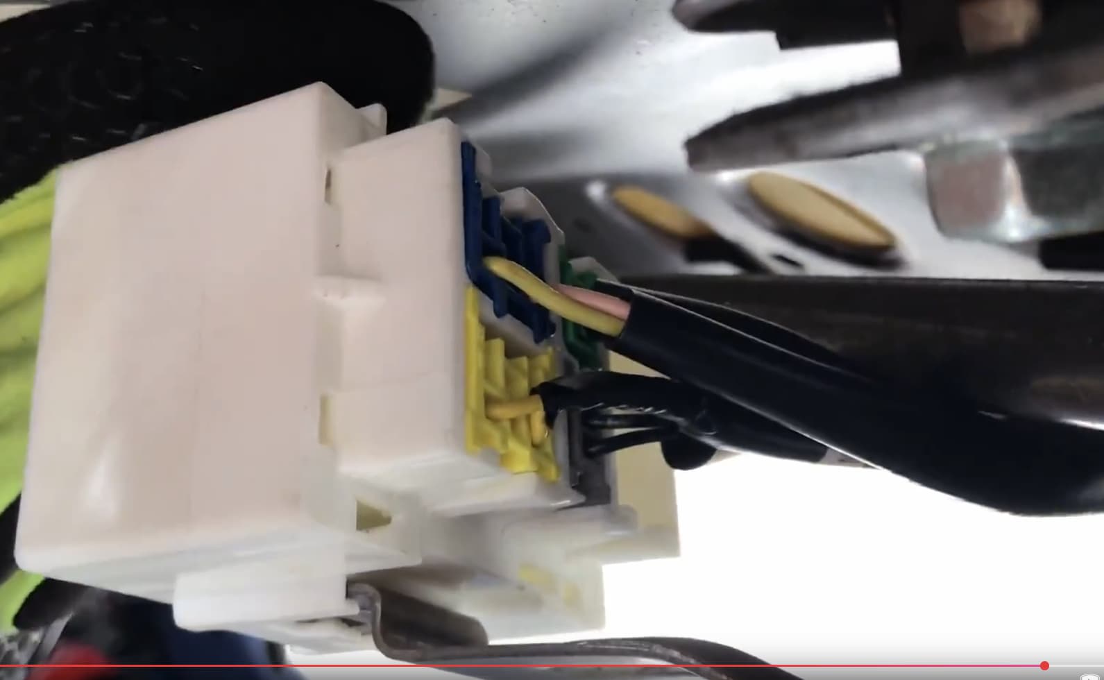

Hey I used this guide: https://youtu.be/K0jC8MrFp5c?t=675
This grey connector should be for the seatbelt detector
Yellow block = airbag
Green block = heated seats
