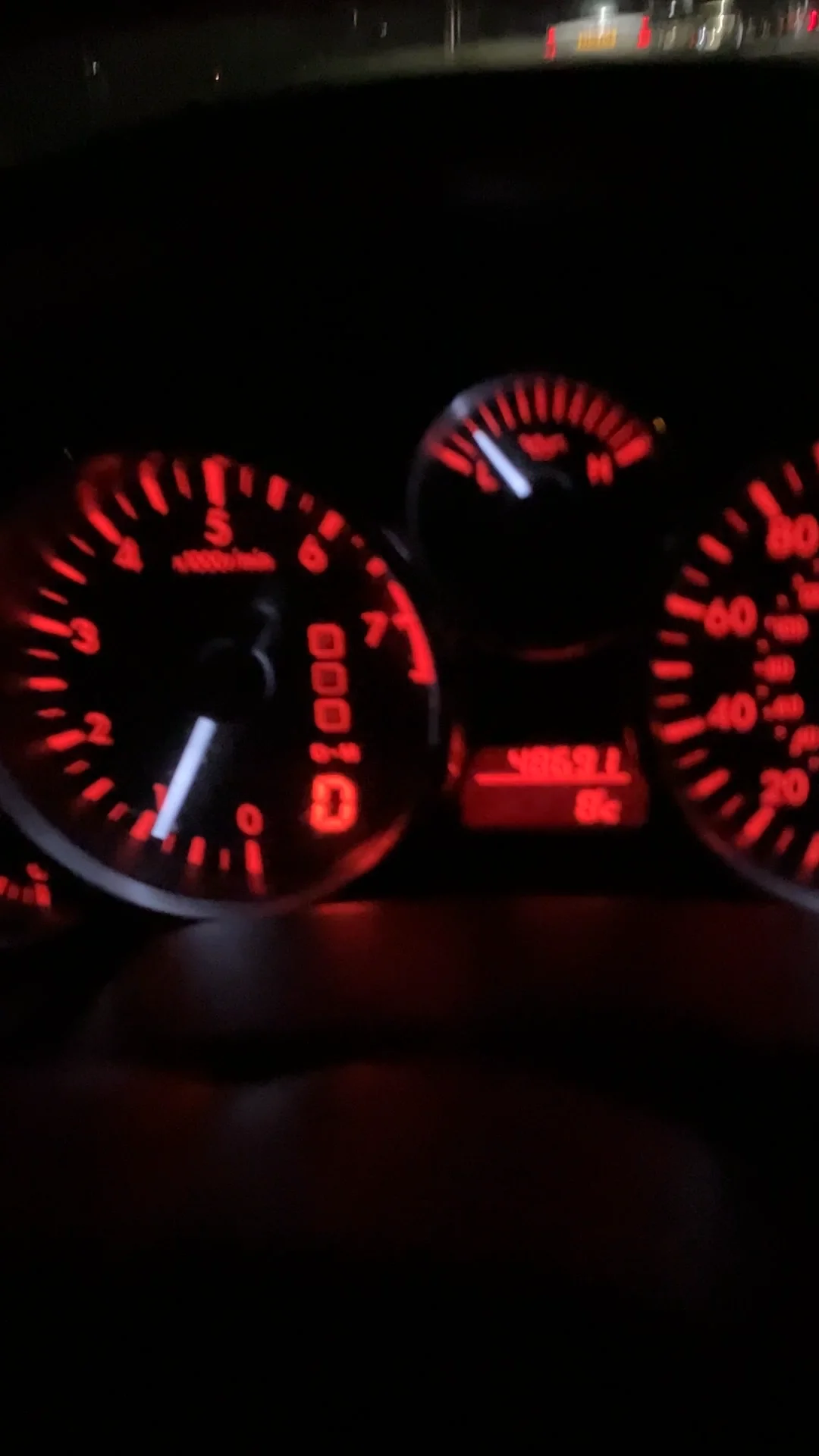

My partners car is normally super reliable but last night the transmission started to behave very weirdly and became progressively unpredictable over about 30 mins, being almost undrivable as ended up mostly stuck in first gear, then would be ok for a while, then back on the fritz. We limped back home. I’ll give a short run in a while to see if things have improved (magically!).
Being a bit “old school” I first thought maybe the trans fluid might be low - yep thats the limit of my reach on this subject. Maybe its electronic?
2 videos below are of the dashboard whilst driving with the problem. You can hear the engine (which is fine) and moving the gearstick left/right from D to M to D mode as we try to get the transmission to behave, only for it to switch back to M mode after a few seconds.
Any help on how to go about fault finding and fixing is most welcome, or leads on local garages who know their stuff, else is main dealer my only option?
Hope you can help her us. Thanks

I’m thinking low fluid or gearbox filter change if it has one ?
I’ve a Merc diesel auto, behaves the same way when in need of oil change, especially when cold.
Clunking into first gear generally and then refusing point blank to change up or exceed 40mph if already on the move.
Hopefully you’ll get some advice on forum if indeed electronic gremlin.
I’m thinking and worth checking, leaking grommets?
There’s a fuse in the A pillar fuse board protecting the instrument cluster electrics, I’m just wondering if water has got in there.
It seems more likely such a problem has only just occurred, I guess auto gearbox problems get progressively worse.
Anyways always worth checking if that fuse board/carpets are wet in the passenger footwell, we have had a very wet last couple of weeks.
Not had an auto mx5 but fluid and filter changes on previous autos normally cured shunting, hanging or shifting issues. Some cars also required a tcm reset as well so it could relearn shift points etc. Not sure how sophisticated the mx5 auto box is but a simple disconnect and reconnect of the battery may be worth a try and see if it settles out also. I could be talking rubbish with this particular car, but it has worked in the past for me on others :+1:.

I’ve resealed the Scuttle Grommets, which def. needed doing. There’s no sign of damp on either foootwell. I disconnected and visually inspected the 2 block connectors on (what i think is) the Powertrain Control Module. They and the PCM seem dry. I also disconnected and reconnected the battery in case that reset the PCM (disconnected/reconnect the 2 blocks on it.). The weird shifting fault (as per the videos above) recoccured after driving about for 30-40 minutes, occuring 1-2 times ever minute so limped the car home.

Do you have access to an OBD reader, to scan the car for fault codes? This might provide a bit of prior knowledge, ahead of any dealer visit.
You could also have a look for any nearby transmission/gearbox specialists in your area. Unfortunately I don’t know much about the Powershift transmission, to know how it works from a design point of view. But does seem strange overall, for something that’s done less than 50k miles.
It could also be selector related of course, depending on how the shifter senses what gear has been selected. Especially if it’s going into manual mode of its own accord, ascertain whether that being caused by the transmission mis-interpreting what gear is being asked for (via mis-information from the physical selector or from the transmission control module), or whether it’s an issue with the transmission itself.
UPDATE: Sealing the Scuttle Grommets seemed to fix things. We’ve been running the car for a few days in wet weather, using aircon to dry out the interior. So far driven 20-30 miles without a problem. so hopefully that’s sorted.
Many thanks for all the advice, I really appreciate it. Goes without saying your suggestions saved me a whole load of grief and expense. Thanks again.
