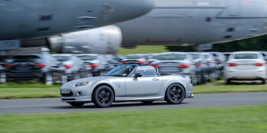

Boring Silver
RX8 ARB’s with Mazdaspeed Springs
181 Bhp with Induction kit and Exhaust plus remap (no it’s not BBR!)
Plus a few other things you can spot!

Your car is far more attractive than mine though! Are RX8 ARBs the way to go? I’ve seen them mentioned quite a few times in my browsing.
I have Yellow dot ones on and they work very well

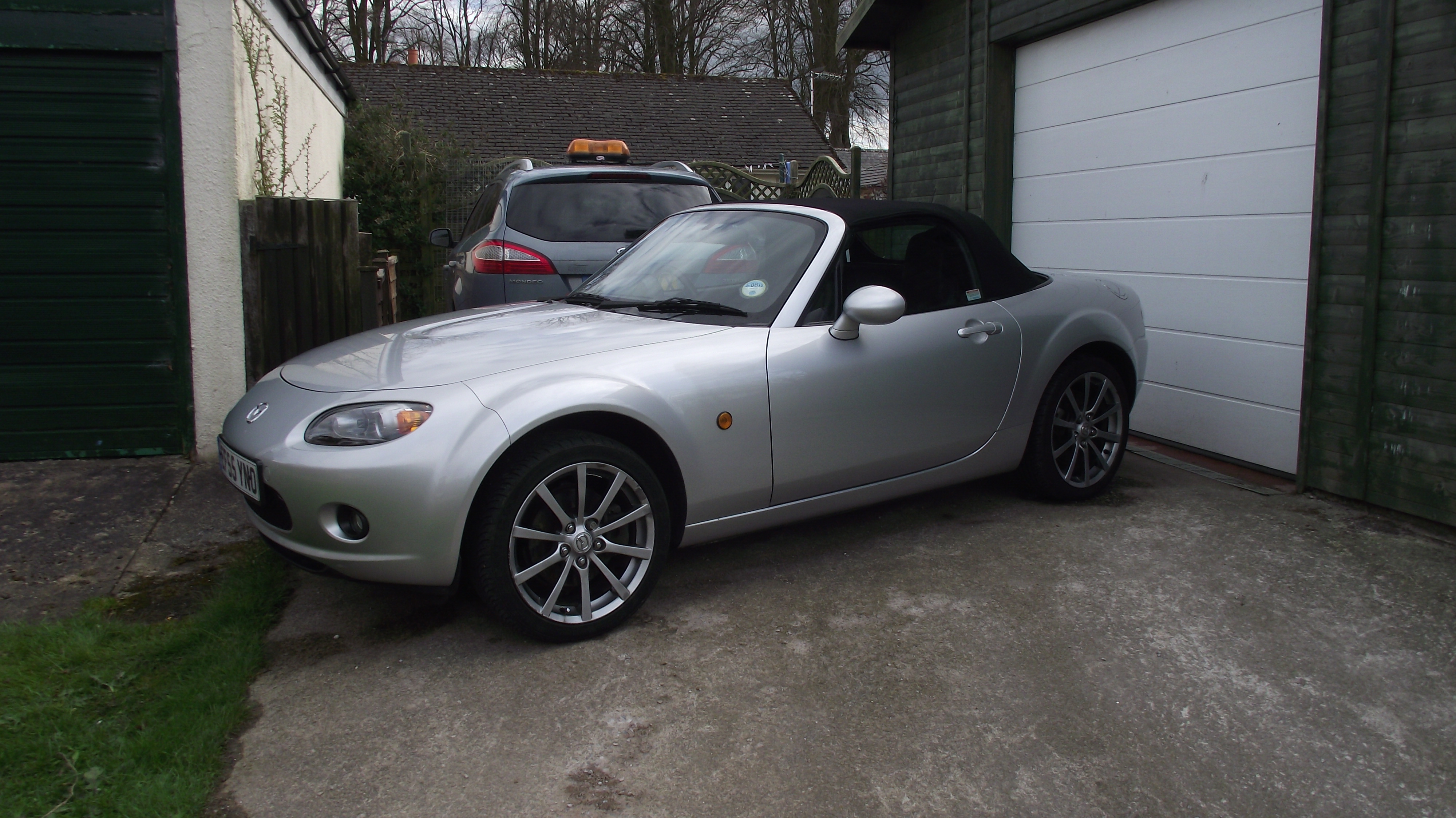

It seems to be fairly standard for these cars to have a clutch biting point somewhere in the carpet underlay.
Adjusting the clutch pedal pushrod makes them much nicer to drive for zero outlay :slight_smile:
This is how I bought it though
Yep, that is exactly how mine looks (albeit with cloudier headlights).

What exhaust and induction are you running?
Did you have to send the ECU for remap? I don’t believe they are mappable at the road side via laptop, some sort of hack is needed?
I did look at the Skuzzle, seems to be well rated but wouldn’t go down that route until I could find a decent mapper.
Also silver works so nicely that era of Japanese cars, plus it’s very easy to maintain and clean.
Skuzzle induction. Racing Beat Manifold, Roddison centre section and GoPerform back box (the racing beat one resonated after the centre section was fitted) Mapped by Clive at Autotronix Developments
