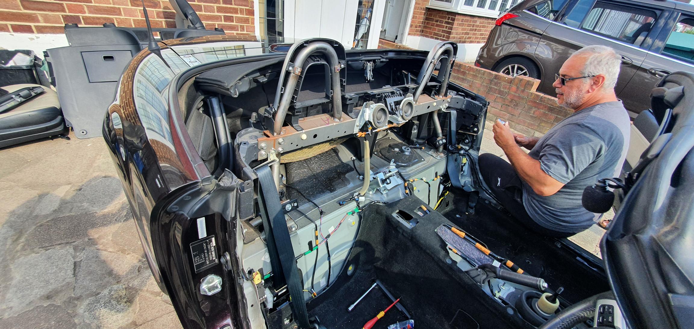

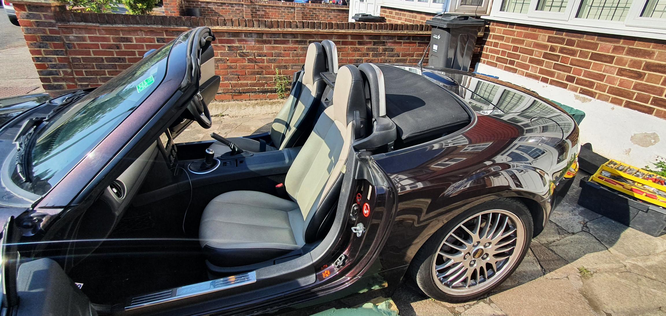

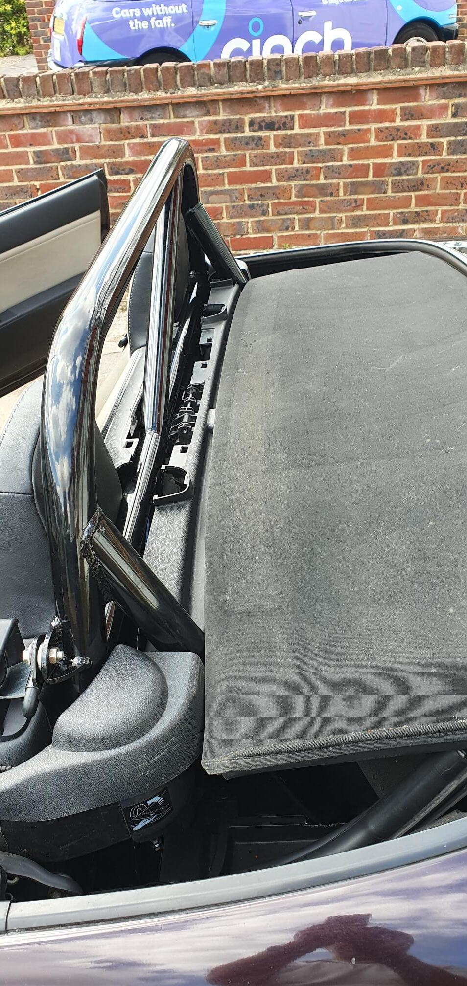

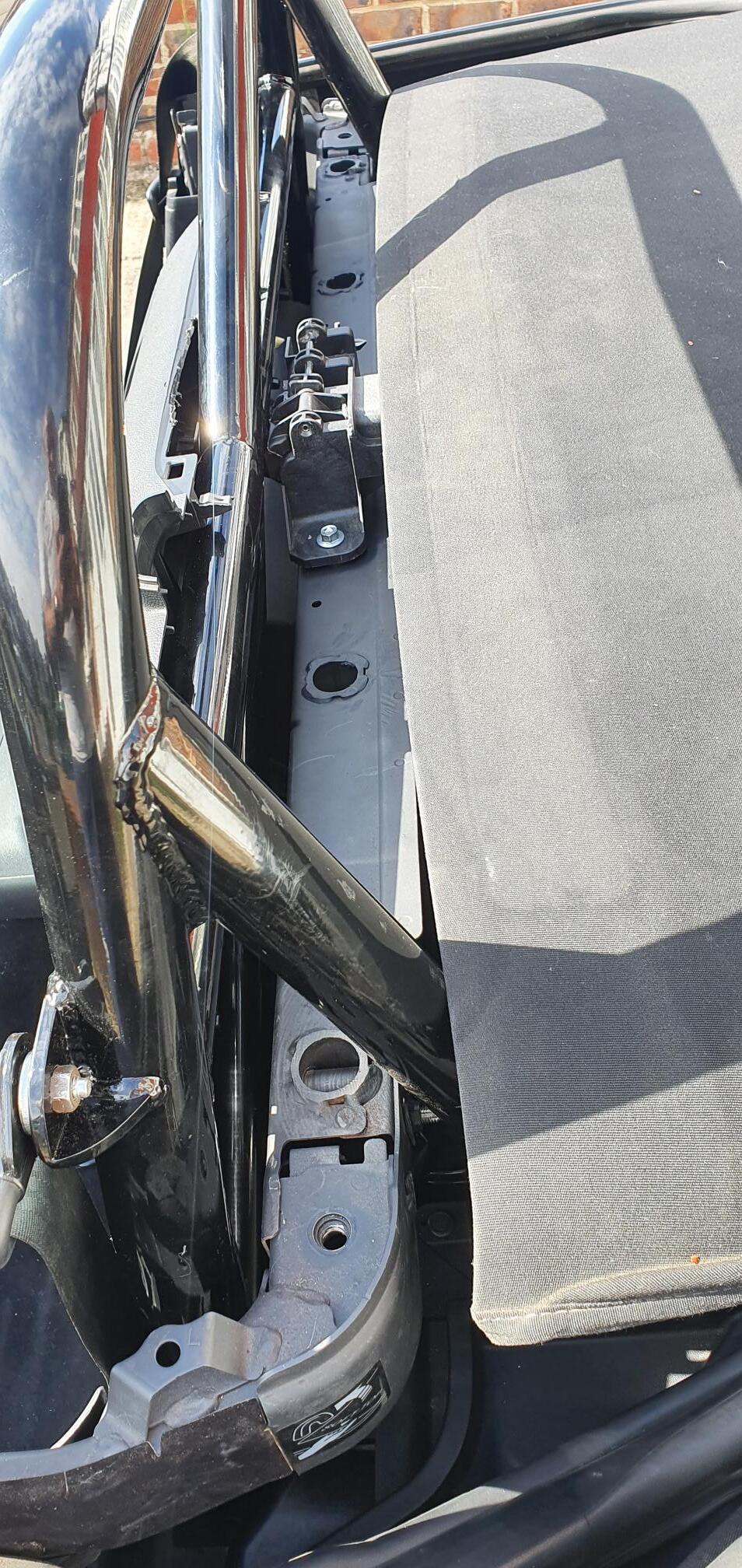

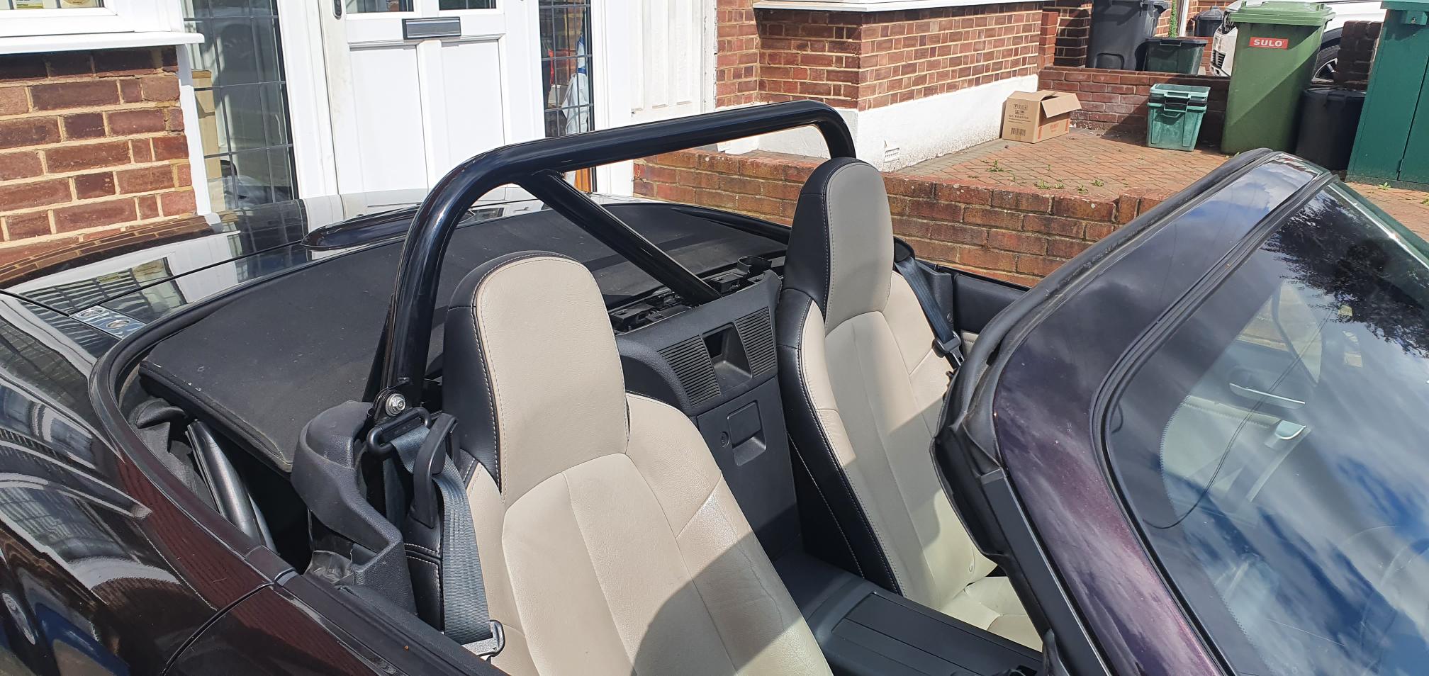

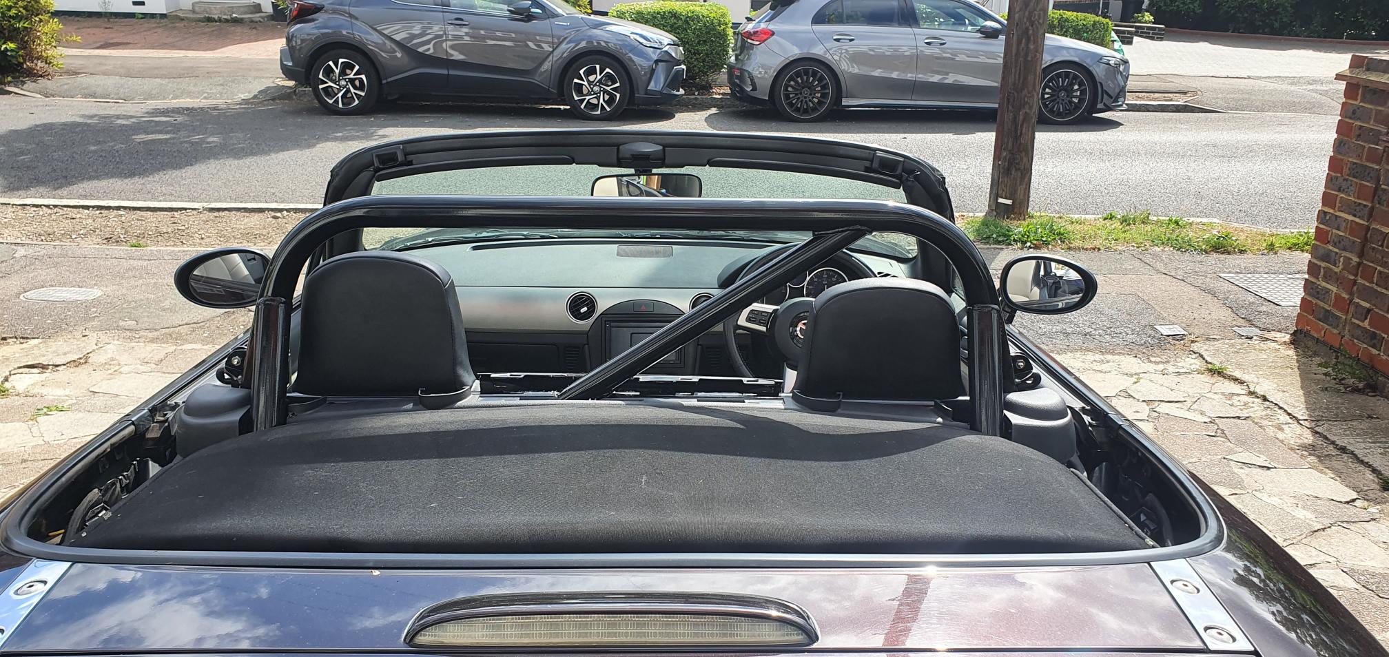

Roll bar is in! Wasn’t too dificult and everything looks pretty neat and tidy after chopping up the plastic to fit back on :laughing: Very tight fit in places. Great fit and very happy with the overall design, finish and look.
Wayne at MRC was v helpful with links to photos on how to mod the bracket that locks the roof down - some searous modding needed there - lol!

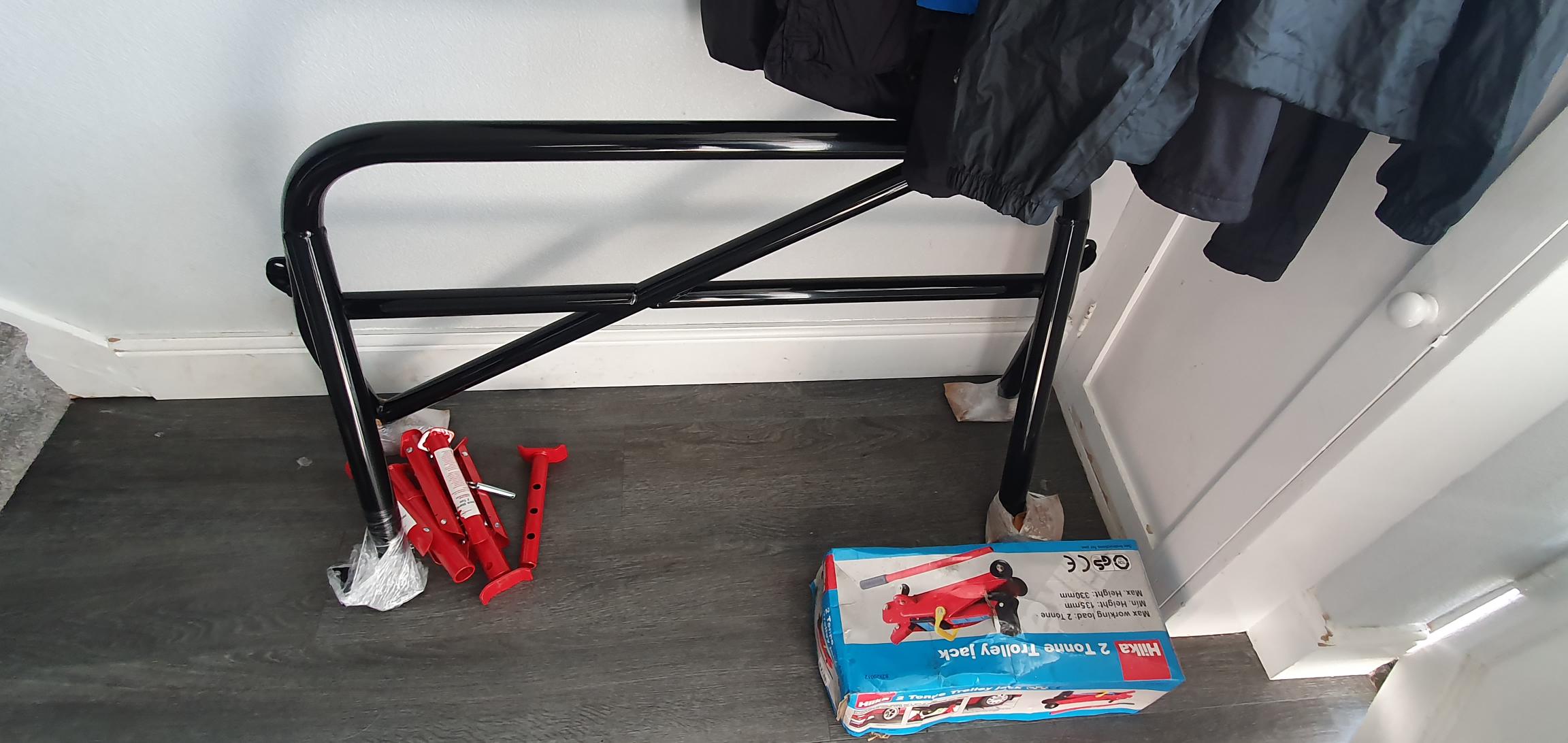

One thing I would mention is this rollbar sits vertically on top of the mounts (as I suspect all aftermarket ones do). If you look at the photo with the factory roll bar installed, it is setback from the mounts. Having a vertical bar installed means you cannot push your seat as far back. I am 6ft and I have noticed the difference. I can’t quite get the legroom I had before but the driving position is ok - just! If you are over 6ft then you will struggle. Just an FYI for those looking to fit a roll bar and are not vertically challanged!

Thanks, that’s a really useful post.
With the seat, I have to have mine all the way back, but I have my seat back quite upright. Is there a place where you can get the seat all the way back by moving the seat back?
Just checked and the seat does go all the way back - I can hear it hit the end of the runners. But you do end up very upright which might be fine for you. I have a prolapsed disc in my back and sitting that upright agrivates it so I need a slight tilt and therefore have to move the chair forwards a bit…
Thanks for the reply
