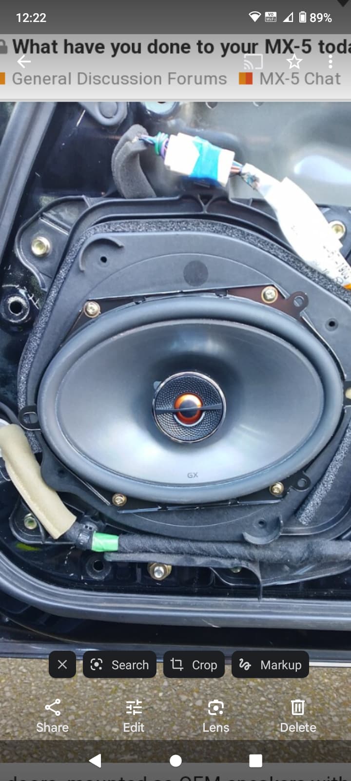

I replaced both of mine with a pair of Pioneer TS-A6880F ones, which are physically the same size. I bought some interconnection cables to connect from the spade terminals on the speakers to the car side Mazda specific connectors.
The MX5 speakers come fitted with a plastic shield over the back protecting the speaker from any water which can (and does) run inside the doors (and drains out of the bottom😉). I removed those shields and fitted them to the backs of the new speakers.

JBL was my preference
