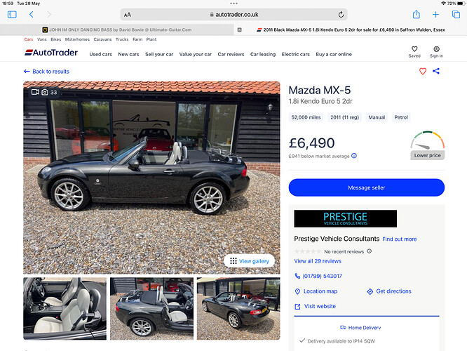

Hi there , you may get more than you expect for your cash
Just one of many available if your willing to travel
