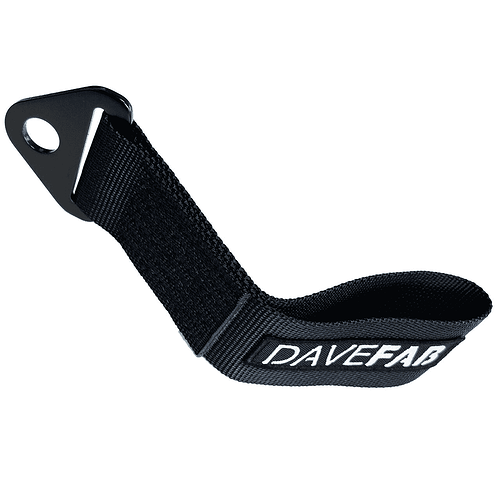

    I’ve got one of those fabric tow straps attached to a triangle metal bracket with an M10 ish hole. This was purchased for one of my prior vehicles for use on track days. Does anyone know where I can get hold of a tow thread extension so that I can mount this to the outside of the front bumper?
Amazon do a few extensions but not in the M20 size which I believe from other forum posts is the NC size.
Note: I also know this is a tie down point rather than a tow point, but for the use case for a track day where the vehicle (hopefully not) would be towed maybe a few meters I’m happy to use this point rather than trying to attach to subframes etc.
Davefab do a similar tow strap to the one I have.

the oem steel towing eye is a M20 X 2.5mm thread.
Id screw the towing eye first on both sides of the car just to make sure there is still thread there (or it has rusted away) in my car only the front thread is good - the rear is completely gone
if both good then you could just buy another towing eye but personally i wouldn’t bother. I just use one at the front.
The strap ones should be ok, the straps are pretty strong and as long as you have a good/strong mounting point it should be fine.
Dont even consider ebay premium aluminium aftermarket towing eye - its purely cosmetic.
