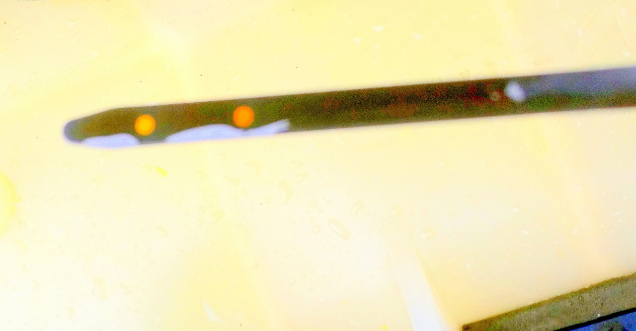

Right, I have now checked exact the amount of oil extracted from my car yesterday and it looks like 5.7l plus a bit for spillages etc, so it was overfilled by about 1l. I have also looked at the previous dipstick reading on a photo and the level is at least above the max mark by the difference between the low and high levels. When I first checked the level on the old style dipstick it looked as though the oil had smeared up the gauge, in retrospect it looks like the level being too high had filled the lower end of the dipstick and dragged some upwards when removed. On the new one the same thing was apparent with a smear of oil again well above the max level.

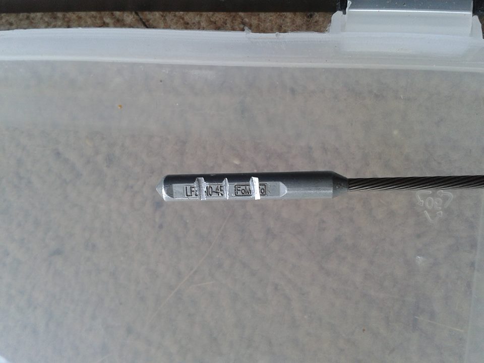

This is what the old style dipstick looked like.
YEP that’s the “bullet” dipstick as Keat63 refers to - it is not very good! the flat blade one - a used in the majority of all other cars - is spot on to read!

This what the new style dipstick looks like with just less than 6l of oil in the sump.
