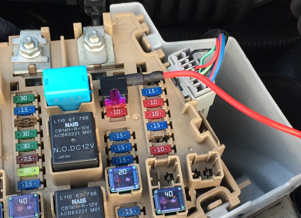

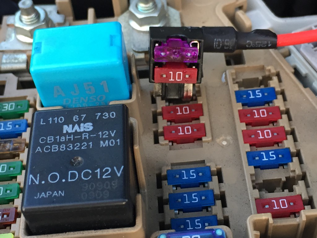

I wired my MX5 parts DRL last week. (Successfully ! :)) in my 2010 mk3.5
I used a “micro” piggy back fuse into the ‘IGN’ (ignition) fuse in the fuse box in the engine bay.
https://www.ebay.co.uk/itm/272728478477. I’ll take a photo later

Many thanks a picture speaks a thousand words and yours were perfect !
