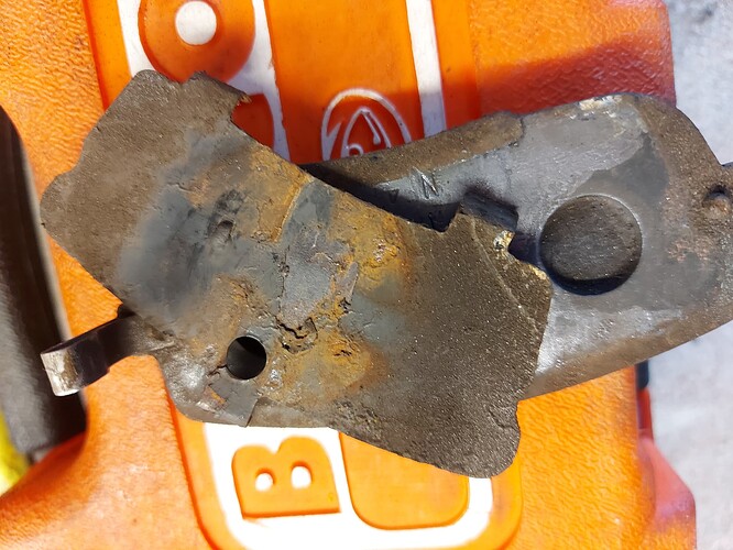

I’m sure my Pagid rear pads came with a set of shims. I took them off a couple of weeks ago to change the slider pins and I’m pretty sure they were there then. I still have the old, original, pads, will check and see if there are any with them.
Here they are

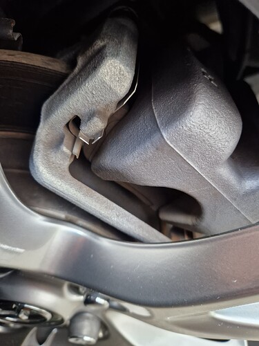

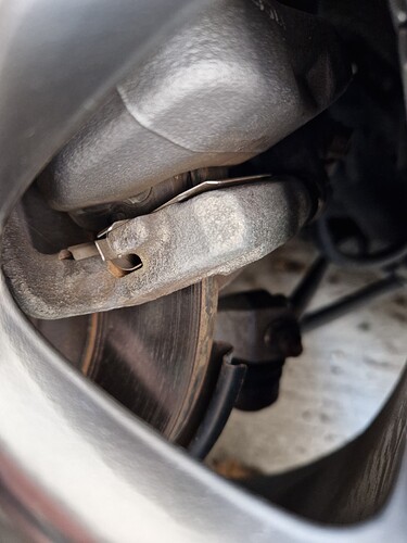

Actually, mine does have some sort of clips or springs (untouched since it rolled off the production line in 2013 - it’s only done 17,500 miles and has barely seen salt). They don’t stop rattles, though, and haven’t done so since it was a year old.

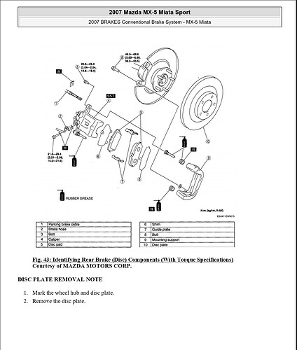

Those are the Guide Plates for the pads into the pad retainer. The shims are on the back of the pad. There are no other clips or retainers on the rear brakes.
not sure if this is any help but my ebc greenstuff pads came with the shim plates already attached.
