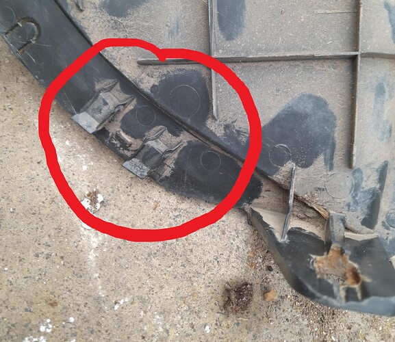

Just a follow-up on this one.
I’ve fitted the NC1 bumper to my NC2 and there is a couple of minor differences that I can certainly live with.
The two rear arch liners are slightly different, but can be modified very easily. Looks like you just need to break off the lower two guide clips. This does not cause any issues if you still have the lower mounting screw… My replacement actually came with the original NC1 liners anyway. Oddly, they both have the same part number stamped on them…
All of the other mounting holes/fittings are in exactly the same place.

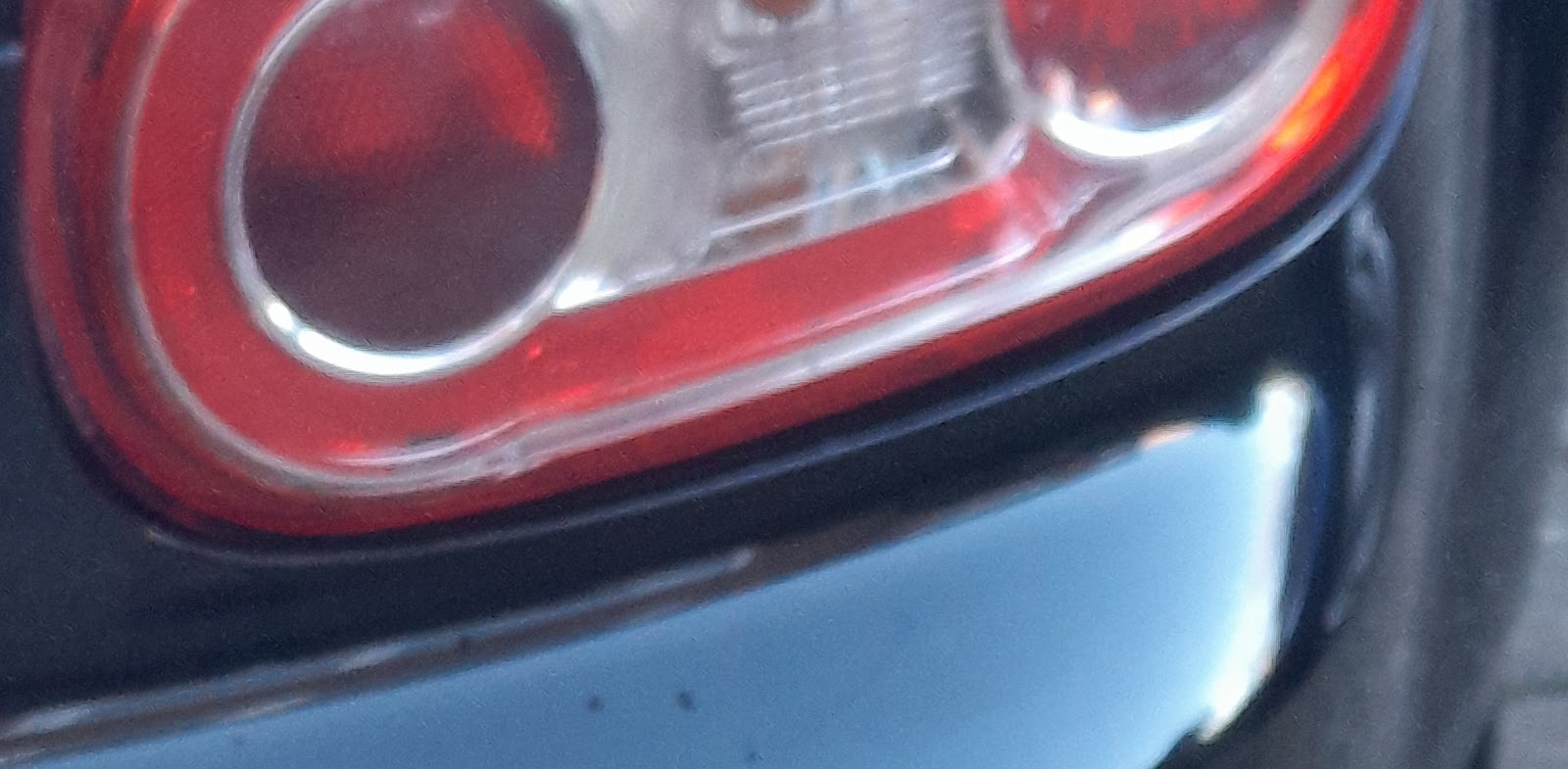

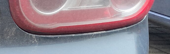

The panels lines all match up correctly. However, there is a very slight difference around the lights. See pictures.
I can live with that!
