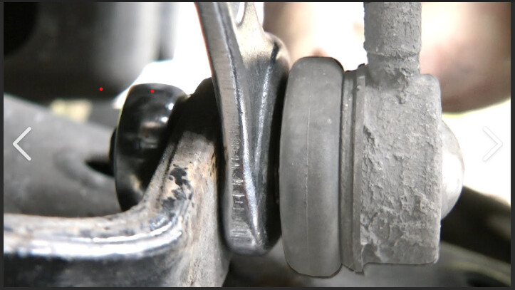

You just need to use mole grips clamped on to the inside of the roll bar link between the bar and the ball joint. That will hold the ball tight enough to be able to undo the nut.
As in photo but use mole grips instead of a spanner.
