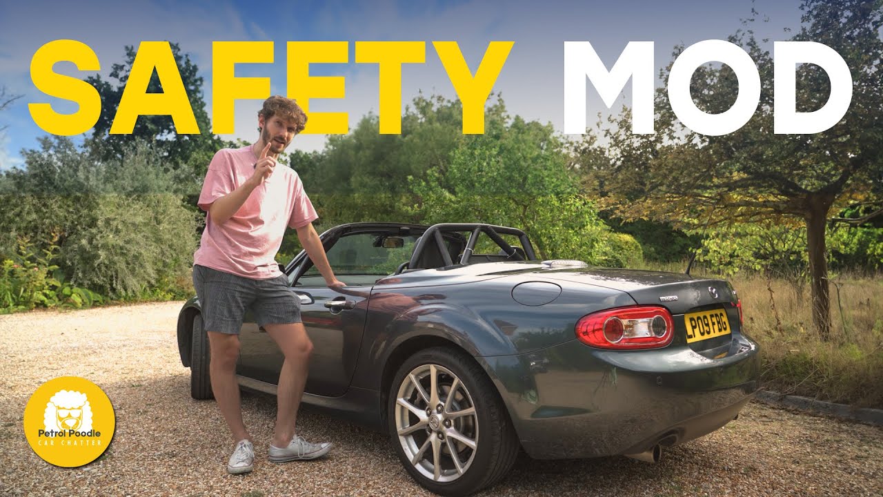

Gcfabrications. Some have had issues with delivery times others have reported great customer service feedback.
But they seem to be the uk go to for prht

GC Fabs. The service is utterly appalling so be warned, but you can’t fault the product.
It’s up to you as to what or how you trim back around it. The trim does not fit back without a lot of cutting, if it will actually go back successfully at all. Everyone’s ideas of what to do about that vary.

Thanks for the video thats great and shows a lot

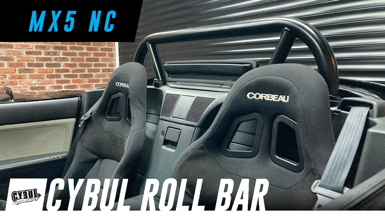

problem is the cross bar is not included that holds things like the amp and other modules, another issue i have concern with is ther roof catch if the roof will close without the roof catch being closed once opened to allow the roof to go down past the roll bar like the cybul roll bar.
would love to see some more pictures and any other comments.
Thanks again for the video and any other information would be greatfull
Terry
Cybul roll bar video showing issue with roof catch, would like to know if this is an issue with the GCFab roll bar ???
thanks
