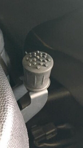

NC roof won’t “pop up”
Look up “walking stick tips NC” on this forum.
I fitted 2 5/8” rubber walking stick tips onto the points where the hood sits when folded.
This restores the “spring” when you release the hood lock, and the hood lifts slightly up ready for you to lift up
